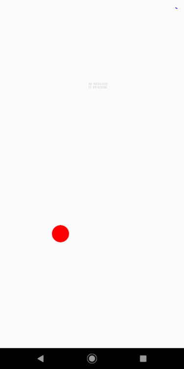

ToniCipriani 194 Posted March 30, 2021 Share Posted March 30, 2021 (edited) 12 minutes ago, Slion said: You can enable touch visualisation from developer menu if you want to see where they occur. It shows the same thing for the most part. Random taps along the same axis. Here's one with that turned on and on a draw application: Edited March 30, 2021 by ToniCipriani 1 Quote Link to post Share on other sites

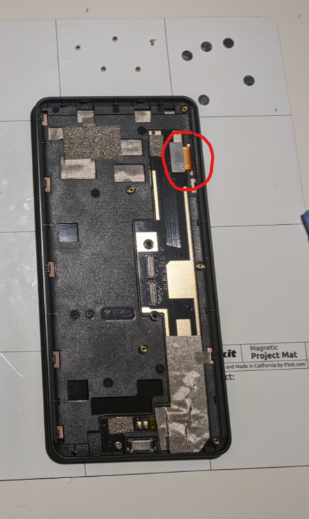

ToniCipriani 194 Posted April 3, 2021 Share Posted April 3, 2021 (edited) Just a small update... The ghost touching got to a point where the phone was unusable and I couldn't even enter my pattern at boot without a lot of retries. Also got a bit dangerous yesterday when I was using my phone as GPS and it kept randomly switching out of Waze. @Hook posted some troubleshooting steps done with F(x)tec so I thought I give it a try (specifically checking if any flex cables were loose), and it SEEMED to have helped. I followed gelraen's teardown instructions and took the screen apart. Cables seemed tight, but I went ahead and reseated both the LCD/Camera to mainboard as well as the LCD to adapter cables. Specifically this one: I will need to do more further testing but it seemed to have passed the calculator test above, and I was able to enter my pattern unlock fine. Going to keep my ticket open with F(x)tec for now, don't think they are responding till Tuesday very least anyways since it's Easter Monday in UK likely. If this fixes it permanently, maybe adding some foam tape to avoid that connector from moving/coming loose might be an idea as a preventive. Edited April 3, 2021 by ToniCipriani 4 Quote Link to post Share on other sites
VaZso 1,997 Posted April 3, 2021 Share Posted April 3, 2021 1 hour ago, ToniCipriani said: steps done with F(x)tec so I thought I give it a try (specifically checking if any flex cables were loose), and it SEEMED to have helped. Please also post your later foundings about this issue. It has not helped in my case, but it may happen you only had this connection issue. It may also happen it will start the same problem again. That is the connector of the screen itself anyway. 1 Quote Link to post Share on other sites
ToniCipriani 194 Posted April 3, 2021 Share Posted April 3, 2021 57 minutes ago, VaZso said: Please also post your later foundings about this issue. It has not helped in my case, but it may happen you only had this connection issue. It may also happen it will start the same problem again. That is the connector of the screen itself anyway. I reseated all 3. Thing is though, none of them felt loose or anything. I'm actually kinda surprised it worked. 2 Quote Link to post Share on other sites
