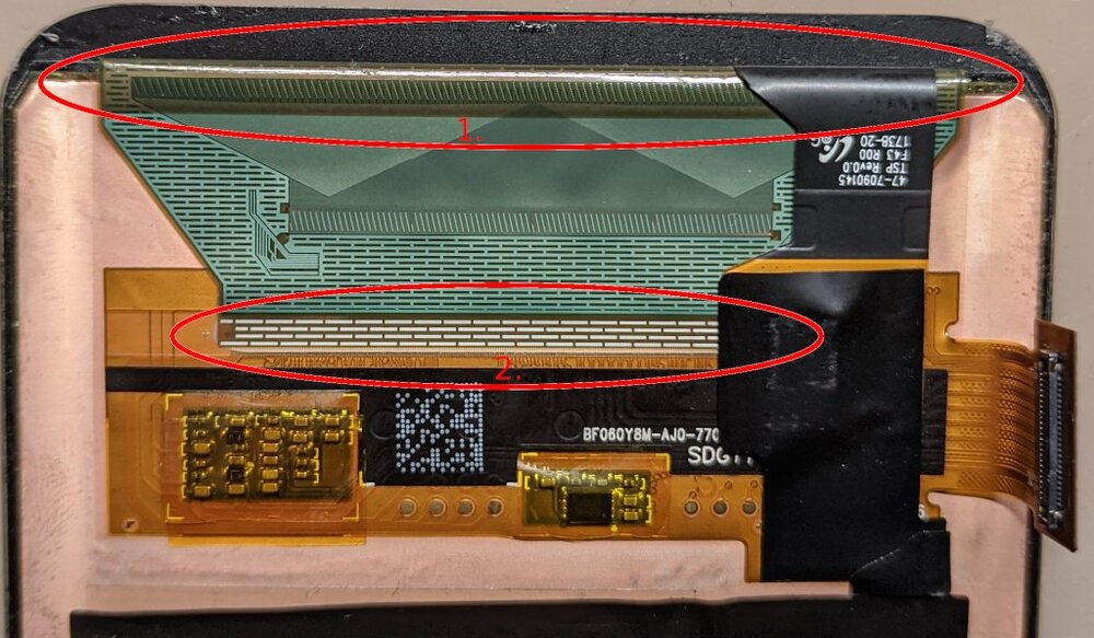

mbecroft 81 Posted December 11, 2021 Share Posted December 11, 2021 I have the same issue. Have contacted support, received no response after about 2 weeks. Tried @ToniCipriani's suggestion of taping down the black PCB. Since the pictures are gone from github, I'm not sure precisely what he meant, but I just some capton tape along the side of the black PCB adjacent to the display connector. Also left all the screws out (front panel just clipped on) for now. So far, so good. Fingers crossed... Further data points: - A reliable workaround is to squeeze the lower right of the display in a very particular way: with two fingers, push down in the far lower right corner, at the same time lifting up the right-hand edge about 20mm from the bottom with a fingernail. This reliably gets it working for a short time. - Interesting to note that with the display unclipped there is no issue. More specifically - with *only the bottom right* unclipped, still no issue. It clearly has something to do with pressure on the display connector or the black PCB this attaches to. Thanks for all the good advice in this thread. 2 Quote Link to post Share on other sites
mbecroft 81 Posted December 11, 2021 Share Posted December 11, 2021 I spoke too soon - it worked for a little while, but now is as wild as ever. It is possible to obtain a mode where it works, but not reliably, now even when leaving the display casing completely detached. Looks like another screen from aliexpress... 1 Quote Link to post Share on other sites
EskeRahn 4,891 Posted December 11, 2021 Share Posted December 11, 2021 It is really odd that this is seen by a number of people, but not everyone. Would be nice to understand the root cause. Is it a quality issue on displays or connectors? Is the connectors sensible to e.g. humidity? Is it an assembly issue, that goes wrong on some? Is it a grounding issue? Is it a special mechanical stress that triggers it, that we could all accidentally trigger? Air humidity? Or??? I see something somewhat similar to the described while using a non-grounded cheap charger (tried several). But no issues while charging it through a grounded pc. So this make me think of static electricity and surface currents, that somehow triggers the digitizer... Quote Link to post Share on other sites
VaZso 1,920 Posted December 11, 2021 Share Posted December 11, 2021 (edited) 59 minutes ago, EskeRahn said: Would be nice to understand the root cause. Is it a quality issue on displays or connectors? Is the connectors sensible to e.g. humidity? Is it an assembly issue, that goes wrong on some? Is it a grounding issue? Is it a special mechanical stress that triggers it, that we could all accidentally trigger? Air humidity? Or??? I have attached a photo earlier of the back of the display itself. It has a ribbon cable at the botton side of the display (on the pure panel), that is where display and touch-related wires come from the display itself to the internal display controller and Pro1's controller speaks to this internal controller. I am almost 100% certain the problem is caused by a discontinuity in some of the wires of this ribbon cable and the root cause is the movement of the display panel in relation to its base which causes this ribbon cable to move while the phone is in use and results in a break of the wires. Maybe some of the Pro1s had a bit weaker gluing at the bottom side of the panel which allowed it to start moving (or binding of glue became worse as a result of external circumstances) while other Pro1's may not ran into similar related issues. 59 minutes ago, EskeRahn said: I see something somewhat similar to the described while using a non-grounded cheap charger (tried several). But no issues while charging it through a grounded pc. So this make me think of static electricity and surface currents, that somehow triggers the digitizer... This kind of problem exists while using cheap chargers. It is because it generates a lot of electrical noise and touch panel tries to deal with capacitive charges on its surface. Edit: I am speaking about the green ribbon cable in the following photo where it is circled with "1." as label. It has a curve where it comes from glass towards the flex PCB and that curve is sensitive. Edited December 11, 2021 by VaZso 1 1 Quote Link to post Share on other sites
mbecroft 81 Posted December 11, 2021 Share Posted December 11, 2021 First, to clarify one thing: the issue talked about in this thread is not to do with grounding or the charger used. It is some type of physical/mechanical problem in the display/digitizer. Since the vast majority of reports relate to the same exact row in the digitizer, it can be inferred that it is a latent fault in the LCD/digitizer assembly design, or in the way the LCD assembly is mounted in the Pro1. The idea that something is not fully secured and moving slightly, eventually damaging sensitive flex cable or potentially ever more sensitive connections to the actual panel and digitizer itself (circled in above post) is interesting...I noted on disassembling the display enclosure of my Pro1, all the screws were fairly loose. I'm not sure how exactly this might lead to stresses on the much more sensitive phone/digitizer cables/electronics illustrated by our friend above. Update: The trick I spoke of - pushing firmly down in L/R corner and up 20mm above on right - for me was 100% repeatable, so a starting point. In trying out various further solutions, I first focused on that corner, but now, I've left the entire R/H side of the display assembly unclipped - so the display bezel edge is not being squeezed down to conform with the chassis - in other words, the display R/H side essentially can float with no strong stresses on the screen assembly. It is working 100% as of my morning today. We'll see how long that lasts. It seems pretty clear that, by whatever root cause, the design of the screen or the phone makes it susceptible to this highly-specific failure mode, and I suspect that once failed, all the attempts in the world to repair it are merely rolling the dice and hoping that by bending things in a certain way, whatever it is will make proper contact, at least for a time. Needless to say, I'll be ordering a new screen from Aliexpress today. Quote Link to post Share on other sites
VaZso 1,920 Posted December 11, 2021 Share Posted December 11, 2021 (edited) 2 hours ago, mbecroft said: The trick I spoke of - pushing firmly down in L/R corner and up 20mm above on right - for me was 100% repeatable, so a starting point. It was the same for me. I suspect the lower-right corner of the PCB, so the left part of the wide ribbon cable near the edge (looking from behind) has the wires coming from touch-related signals. 2 hours ago, mbecroft said: We'll see how long that lasts. It seems pretty clear that, by whatever root cause, the design of the screen or the phone makes it susceptible to this highly-specific failure mode, and I suspect that once failed, all the attempts in the world to repair it are merely rolling the dice and hoping that by bending things in a certain way, whatever it is will make proper contact, at least for a time. I think it will last till the ribbon cable has a position where it conducts as it should. I don't think there is a huge design issue with the screen or the phone itself. It may be related that they wanted to make the screen replaceable, thus, covered much of the self-adhesive area of the screen originally has. That makes the screen removable but if bottom part is not secured well, it can cause break in the flex cable part. If the self-adhesive area would not be covered that would make screen replacement hard as it would need a heat gun for the screen to release and also it would make relatively high risk of the part below the screen to break as it is plastic. So I think the problem is not huge but bottom part of the screen should be glued well enough. Also, it may happen the glue itself holds well, but something - like cleaning it several times using alcohol - can go under the edges and may slowly dissolves the adhesive part. So that is one circumstance which may matter as the real source of this issue. Edited December 12, 2021 by VaZso 1 Quote Link to post Share on other sites

VaZso 1,920 Posted December 13, 2021 Share Posted December 13, 2021 12 hours ago, Rob. S. said: Has this been happening with both original and (Aliexpress) replacement screens? - My original screen was working for eight months. - I have replaced it using another screen bought from Aliexpress which was worked for 4.5 months then started having screen issues - collecting colour dots which have disappeared by turning the screen off and on, later it became permanent (ribbon cable was injured at other part). Gluing this case was not perfect as I only used double-side adhesive tape provided with the screen. - I have replaced my screen once again using another screen bought from Aliexpress but using a better gluing method. So far it works well since 10 months now. So it may happen also with stock and replaced Aliexpress screens, so I think the latter is not better nor worse in this relation. Also I would like to say again the curved ribbon (bottom) part of the display should be glued well to not allow that part of the screen to move and also need to be ensured that ribbon cable is not bent in a sharp edge. Don't misunderstand me, the glue should be flexible anyway to allow the screen to be replaced but not loose. 2 Quote Link to post Share on other sites
