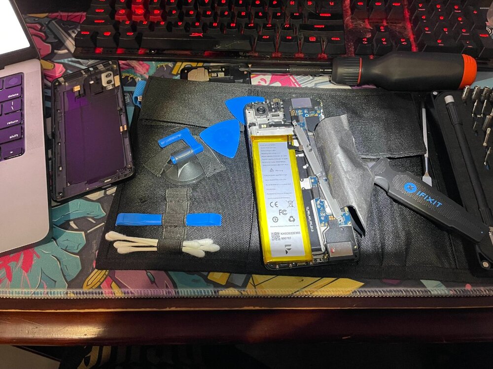

Whitey 8 Posted April 9 Author Share Posted April 9 (edited) Well I was able to get the phone disassembled and get down to the battery! Haven't done that in a few years, good fun! However removing the battery (which felt superglued in!) I see a connector I don't recognise! Does anyone know this connector? I assume the top (top 2?) connectors are positive and bottom (bottom 2?) are negative from the naming convention. However this thing is really tiny, like 1/4 the size of my pinkie fingernail tiny (apparently my iPhones zoom and focus is quite good!). I'm not confident I could hook this up without an adapter, which I suspect I _may_ be able to get if I can find out the correct name for this connector type. EDIT: Sorry, just realised compression made the battery marking illegible. Hopefully the below is helpful to someone else if not me in the future! EDIT 2: Well, browsing around to try and find battery info and I found this: > On another note, as we are also investigating the battery protection issue, we would like to carefully remind you to always ensure there is some level of charge in your Pro1-X - even if you don’t use it. At times, the battery can likely go into a sleep state that would require a jolt to activate again. During this time, your phone will not boot and will not charge. If you’ve encountered this, please get in touch with us at [email protected]. Looks like I'm impacted. I'll flick them an email and work out the next steps I guess! Edited April 9 by Whitey 2 2 Quote Link to post Share on other sites

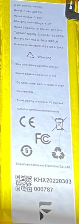

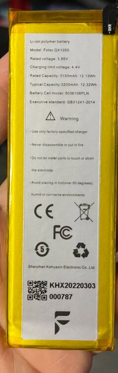

dt.white 59 Posted April 10 Share Posted April 10 17 hours ago, Whitey said: EDIT: Sorry, just realised compression made the battery marking illegible. Hopefully the below is helpful to someone else if not me in the future! Thanks for this, would you be able to confirm the following info (compression is still making some parts a struggle to read)?: Battery cell model: 5036108PLN or 50361O8PLN Shenzhen Kehuaxin Electronic Co. Ltd 17 hours ago, Whitey said: Does anyone know this connector? If you take a look at the DIY battery thread that's been linked, there's discussion about the connector there but that's based on images - would be handy to have your input! 1 Quote Link to post Share on other sites
Whitey 8 Posted April 11 Author Share Posted April 11 16 hours ago, dt.white said: Thanks for this, would you be able to confirm the following info (compression is still making some parts a struggle to read)?: Battery cell model: 5036108PLN or 50361O8PLN Shenzhen Kehuaxin Electronic Co. Ltd Sorry, I thought I could be clever and recrop the old photo . Here's a new one: Confirming company is Shenzhen Kehuaxin Electronic Co Ltd (I couldn't find their batteries online) and model is 5036108PLN (pretty sure those are 0s). Guessing the "KHX" is an abbreviation of the battery company and the battery is about 1 year old. 16 hours ago, dt.white said: If you take a look at the DIY battery thread that's been linked, there's discussion about the connector there but that's based on images - would be handy to have your input! Thanks, I'll check it out! 2 Quote Link to post Share on other sites

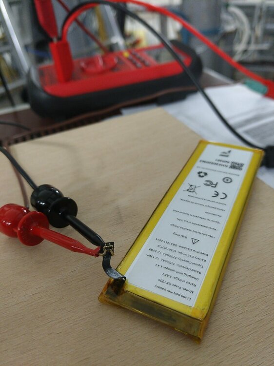

claude0001 1,175 Posted April 25 Share Posted April 25 (edited) So ... I recharged my Pro1-X battery using a laboratory power supply after it had depleted completely, probably due to the "battery protection bug" mentioned by f(x)tec in their updates. It turned out that the most difficult part in this is getting to the battery. The Pro1-X is not nearly as "serviceable" as I expected. Separating the different parts of the body is not as easy as the instructional videos suggest. Also, the battery itself is glued into the phone, which makes its removal a scaring endeavour. Note that removing the battery from the phone is not strictly necessary for re-charging it. In principle, disconnecting from the phone circuitry would be enough. But for me, having the battery detached simplified connecting the external charger. You decide. The charging itself is actually not very difficult, provided you have the necessary equipment and at least some basic electrotechnical skills. Still, here comes the obligatory disclaimer: Mistreating a Li battery can set it on fire and/or release toxic gases, be sure you know what you are doing at all times. The Pro1-X's battery has a more-or-less standard connector featuring two power lines and two sensing wires. For external charging, make sure to connect to the (outer) power lines. The laboratory powersupply I had at hand was a bit oversized for the purpose (32 V x 5 A), so I included two multimeters in the charging circuit as shown in the pictures. Using them, I could monitor the charging current and voltage with greater precision than the PSU's built-in gauges would allow. Especially for the voltage, we are interested in the 1-mV scale. As written above, my battery started with a charge of "0.00 V". I started by slowly raising the charging voltage in voltage controlled mode, taking care that the current never rose beyond 1 A. This way, I quickly reached the 3.7-V operating plateau of the battery. From there, I set the power supply to charge at 840 mA in current-controlled mode for 1.8 h. I figured this should be a quite safe value, as the fast-charger operates at much higher current. Given the battery capacity of 3.2 Ah, I estimated to reach an approximate charge level of 50%, as the Pro1-X would later confirm. During the current-controlled ramp, the charging voltage never exceeded 4.1 V. The battery did not noticeably warm up in the process. At the end of the procedure, the battery voltage (measured with the charging PSU switched off) was approx. 3.9 V. In the end, my Pro1-X booted normally with the re-inserted battery. Edited May 26 by claude0001 Further clarified some things. Added saftey warning. 2 4 1 Quote Link to post Share on other sites

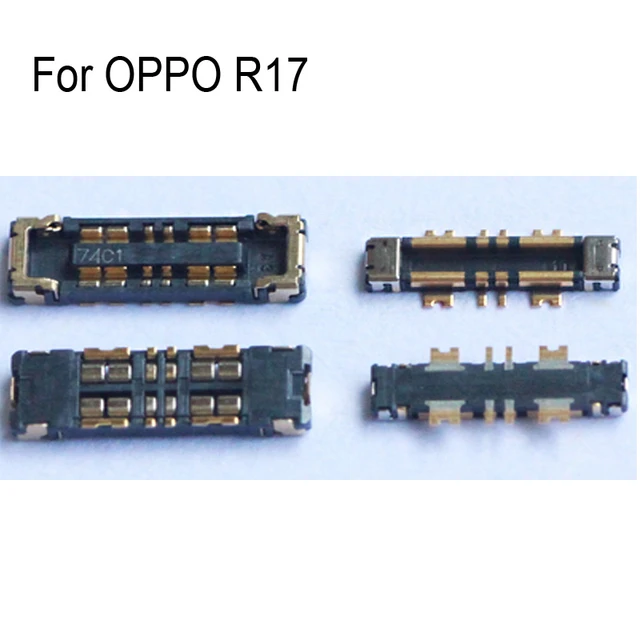

david 874 Posted June 5 Share Posted June 5 4 hours ago, claude0001 said: I haven't made a better picture than the uploaded one. However, @Whitey have a pretty nice one in their post above: Thanks @claude0001! Even though I read this thread, I somehow missed that photo! Here is what @Whitey posted. Here is the charging board I used for my Pro1 battery, with the Xiaomi MI 6 connector. I *think* the Pro1X connector may be the same as an OPPO R17. Here a close-up of both the motherboard end and battery end of the OPPO R17 connector: It looks similar to what @Whitey shows in his photo. Without being able to compare the actual sizes, we can't be sure. My educated guess says it is probably a match though. 2 Quote Link to post Share on other sites
david 874 Posted June 6 Share Posted June 6 On 6/5/2023 at 12:44 PM, david said: It looks similar to what @Whitey shows in his photo. Without being able to compare the actual sizes, we can't be sure. My educated guess says it is probably a match though. I took another look at this. They both have the same arrangement of Dash-Dot-Dot-Dash, for the connector contacts, on the battery cable end, but the dashes seem longer for the OPPO R17 than what is shown in @Whitey's photo. It may still work, but I'm wondering if there is another, similar connector, with the dashes being shorter. If anyone wants to send me a Pro1X battery, I'd be happy to figure it out. Quote Link to post Share on other sites
david 874 Posted June 6 Share Posted June 6 Some other candidates: VIVO B-N8 XlAOMl BM4E M1805E10A, Poco F1 Armoured Edition Globa, Poco F1 Armoured Edition Globa, Pocophone Poco F1: Infinix Smart, X5010: 9 Pro, M2003J6B1I, M2003J6B2G, 9 Pro Max: David 1 Quote Link to post Share on other sites
claude0001 1,175 Posted June 7 Share Posted June 7 13 hours ago, david said: Infinix Smart, X5010: The polarity on that one seems to be inverted with respect to the Pro1-X's ribbon cable (compare the labels P+/P- with those from @Whitey's picture). Everyone, be sure to always connect your charger in the right way ("+ to +, - to -"). Otherwise bad things may happen. 1 Quote Link to post Share on other sites
