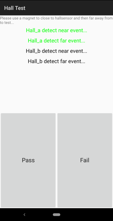

671994 0 Posted August 16, 2020 Share Posted August 16, 2020 (edited) Hi I have two keyboard issues with my Pro 1 (original Android 9, not LineageOS): There is no keyboard backlight. I read that many users complain about low-intensity light, but there is absolutely none in my case. The only key with (the low-intensity) backlight is CapsLock (when turned on). Open keyboard is not detected. When writing on the hardware keyboard, a software one keeps showing despite the fact I have "Show virtual keyboard (keep it on screen while physical keyboard is active)" turned off. Applications such as "Null keyboard" are workarounds, but it is very annoying. Does anybody has a similar issues? Is it just software related, or could there be, e.g., problem with a sensor detecting open keyboard? Edited August 16, 2020 by 671994 1 Quote Link to post Share on other sites

671994 0 Posted August 16, 2020 Author Share Posted August 16, 2020 5 hours ago, EskeRahn said: Try the factory test described in this thread, The magnetic hal sensor is number six from the bottom, just above "OTG" Thanks! I performed the test of the Hall senzor: Closing they keyboard -> the first line becomes green, opening -> the second line becomes green. Even when I repeated the process, I wasn't able to get third and fourth line green. See the final result attached. Is it correct? Quote Link to post Share on other sites
EskeRahn 5,596 Posted August 16, 2020 Share Posted August 16, 2020 19 minutes ago, 671994 said: Thanks! I performed the test of the Hall senzor: Closing they keyboard -> the first line becomes green, opening -> the second line becomes green. Even when I repeated the process, I wasn't able to get third and fourth line green. See the final result attached. Is it correct? Yes, as you can see in the other thread the other one is for detecting e.g. a flip case, You can trigger that one with a strategically placed magnet, but it has nothing to do with the keyboard, So as the sensor works it seems like some software issue. What is the firmware installed on it? 2020-07-07? Quote Link to post Share on other sites
