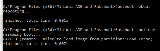

windraver 63 Posted April 21, 2020 Author Share Posted April 21, 2020 tried plugging in, got minimal adb and ran "fastboot reboot". went straight back to the fastboot screen. Not even sure how I got here. Quote Link to post Share on other sites
windraver 63 Posted April 21, 2020 Author Share Posted April 21, 2020 welp, it seems like the partition has gone bad? Help? Quote Link to post Share on other sites
Hook 3,315 Posted April 21, 2020 Share Posted April 21, 2020 I'm not the most knowledgeable person here, but I know from experience that the following instructions will return you to factory state with all partitions restored. You will lose all your data. In fact, it won't properly reboot unless you wipe /userdata, but this should save you. You don't have to type all the commands. When you download the zip, there is a flashall batch file that will issue all the commands, but it does not include the commad to erase /userdata so make sure you issue that command first. When done, you will be on the factory stock Android from last October. Then go to install updates in system settings, taking each one. Make sure you restart after each update. The last update will be 03/06/2020. Reboot after that one too. Hope this helps. 2 Quote Link to post Share on other sites
