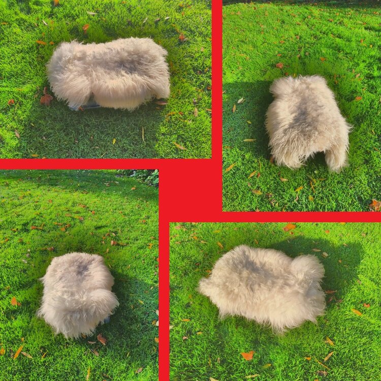

EskeRahn 5,598 Posted November 8, 2020 Author Share Posted November 8, 2020 As the dog exists nu more, I just recreated a similar scene with a box and a sheep skin of similar whitish colour, and made a small collage. Note that the halo is most pronounced if you do not photo in the same direction as the light. The last of the four looks almost decent, where you can misinterpret the halo as a shade. 2 Quote Link to post Share on other sites
