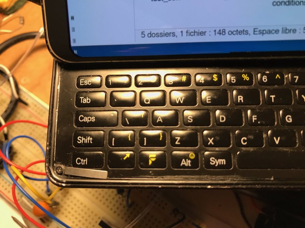

raymo 179 Posted November 8, 2022 Share Posted November 8, 2022 So I fixed my keyboard issue. Hastily way. Since beginnings I had to press hard on several keys, wich is incompatible with a real use of the keyboard. Mainly letters 'a', 'e', 'm', 'h' (and mny more)...are swallowed. But sometimes it has worked as expected (not often), and sometimes it's a real pain (often). Average : a bad experience Example with taping this as fast as possible : "Les chiens aboient la caravane passe" Ls cins aboint la caravan passe Ls chiens aboint l crvane passe Ls cins abint la caaravan pass Digging into software doesn't help to find a workaround. (See this post : https://community.fxtec.com/topic/3679-first-keys-not-working/ ) But, as one of my key fell (fixed with cyanolite), I dig a little into hardware. I experimented that when I press a little the keyboard under the right-ctrl touch the keyboard was working perfectly. *** Warning : Crap makeshift *** I gently pull off the keyboard and put a thin piece of plastic bag under (about 0,2 mm thickness) Then I put a small metal spring who press on the "keyplate" (don't know if it's the exact word here) , fixed with the bottom left screw (replaced it with a longer one). Since two weeks now I have a working keyboard, not 100% perfect, (would say 98%), but really far more usable as at beginning. I had some long conversation with SMS and I really forgott keyboards issues. Oh joy ! It remains me some tricks to correct keyboard issue on the HP-48 calculator with an elastic, tricks who's working with my unit since four years or so and I hope this will work on pro1 since I have a pro1x in hand... 2 3 Quote Link to post Share on other sites
veRYANgry 4 Posted November 10, 2022 Share Posted November 10, 2022 (edited) I made an account just to say that just tightening the screws fixed most of my keyboard issues with my pro1! I was having issues with the m, e, d, l keys, but no longer! =D Thanks for the write up! I'll post if I find out anything else Edit, seems to be only a partial fix. I do still get double presses on the e and l still, but it is much much rarer! Edited November 18, 2022 by veRYANgry 1 3 Quote Link to post Share on other sites
raymo 179 Posted December 14, 2022 Author Share Posted December 14, 2022 (edited) I must say with more as one intensive month of use, my keyboard feels perfect now. I forget all double-press, I had two or three ghost keys (like th*'˜is or something like that with weird characters who suddenly appears) but so rarely that I didn't notice it as a real issue. Edit : I suddenly found a post concerning quadratic equation on this forum but I don't think it's related with any keyboard issue 😄 Edited December 14, 2022 by raymo 2 Quote Link to post Share on other sites
Noob 158 Posted January 24, 2023 Share Posted January 24, 2023 I'm going to try this, as my A key has not been working well recently. @raymoand @veRYANgry, did your keys make a click sound and feel as though they were pressed down when they didn't work, or they didn't feel like the depressed at all? Quote Link to post Share on other sites
raymo 179 Posted January 25, 2023 Author Share Posted January 25, 2023 @Noob : click sound, yes. I would say no mecanic problem here. I glue one touch with cyanocrylate a few months ago as he felt, and had no issue since. I test with three press on different touch like 'aaa eee ddd ccc sss ooo mmm....' and see what happens, then I found this : when pressing the bottom part of the keyboard the bug disappeard. As far as I understand @veRYANgry solve the problem with tightening the two bottom screws, wich could be related to my problem. 2 Quote Link to post Share on other sites
