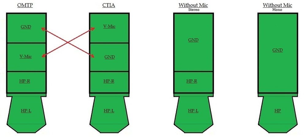

EskeRahn 5,596 Posted October 19, 2024 Share Posted October 19, 2024 Be aware that there - unfortunately, are TWO standards for the four-pinned 3.5mm with microphone, I do not know if the wrong type could cause this. The OMTP and the CTIA. Now most devices (including Pro1/Pro1X) uses CTIA, some years back most (e.g the real Nokia) used OMTP.OMTP is an a LOT more sensible standard BTW, having ground close to a plug housing that could be metal. The easiest way to know if a given headset is CTIA or OMTP (if doc does not tell), is to measure the resistance between the right and left at the tip. Typically something like 320-340 Ω, then measure for he tip to the two others. The ground one will be around half (i.e typ. 160-170 Ω). The mic will typically be much higher.NOTE, You can not expect a sensible measurement measuring this on a whole car system nor a Noise Canceling headset, as there are active components there, (including a battery) As can be seen from the diagram, OMTP to CTIA converters are really simply, and you can find them for as low as £1 on e.g. AliExpress 2 Quote Link to post Share on other sites
--- 129 Posted October 19, 2024 Share Posted October 19, 2024 (edited) 2 hours ago, EskeRahn said: Be aware that there - unfortunately, are TWO standards for the four-pinned 3.5mm with microphone, I do not know if the wrong type could cause this. As the saying goes: "The great thing about standards is there are so many to choose from" P.S. @EskeRahn Agree that a grounded 'sleeve' terminal at the base makes a lot of sense. Edited October 19, 2024 by MonCon 2 Quote Link to post Share on other sites
claude0001 1,424 Posted October 20, 2024 Share Posted October 20, 2024 (edited) On 10/19/2024 at 11:06 AM, EskeRahn said: OMTP is an a LOT more sensible standard BTW, having ground close to a plug housing that could be metal. On 10/19/2024 at 1:10 PM, MonCon said: Agree that a grounded 'sleeve' terminal at the base makes a lot of sense. AFAIK, the advantage of the CTIA standard is greater backwards compatibility. A CTIA headset can be plugged into a traditional (3-contact) stereo-jack socket and still work as an output-only stereo-headphone set (without mic function, obviously). If an OMTP headset is plugged into such a socket, even the earphone function could not work, as there might be no connection of the speakers to common ground (the common ground of the socket contacts the MIC ring instead of GND). Edited October 20, 2024 by claude0001 Quote Link to post Share on other sites
EskeRahn 5,596 Posted October 20, 2024 Share Posted October 20, 2024 6 hours ago, claude0001 said: AFAIK, the advantage of the CTIA standard is greater backwards compatibility. A CTIA headset can be plugged into a traditional (3-contact) stereo-jack socket and still work as an output-only stereo-headphone set (without mic function, obviously). Well it might, depending on where the contact for ground is in the old device. But certainly if plugged into a mono device, CTIA is very likely to work in Left channel. Quote Link to post Share on other sites
