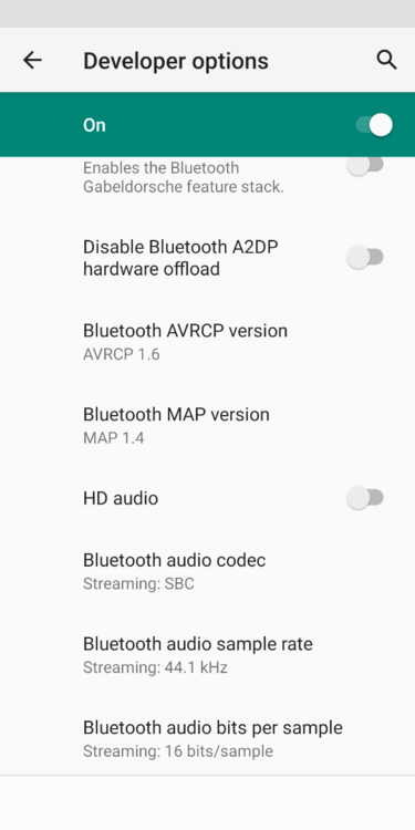

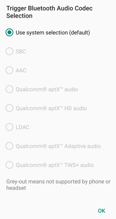

Tim6263 134 Posted December 22, 2022 Share Posted December 22, 2022 My just received Pro 1X says that all bluetooth codec options under developer settings are unsupported - is there something I need to change to enable this pls? I have a pair of Soundcore ear buds that seem to connect via Bluetooth but which don't play any sound. 😪 Quote Link to post Share on other sites
Rob. S. 1,667 Posted December 22, 2022 Share Posted December 22, 2022 (edited) 32 minutes ago, Tim6263 said: My just received Pro 1X says that all bluetooth codec options under developer settings are unsupported - is there something I need to change to enable this pls? My phone looks like your screenshot when no device is connected. When I connect my JVC HA-S30BT headphones or the Logitech BT Adapter attached to my living room stereo, "SBC" is selectable, too, and it is selected by default. I haven't seen any other options yet, but I'm not sure whether those two devices support them. (I think I do have an aptX capable Bluetooth adapter somewhere, but I would need to start an expedition in my house to find out where it is 😉) So far, I was able to connect all of my Bluetooth devices, including headphones, in-ear headsets (mono) and car stereo. Edited December 22, 2022 by Rob. S. 3 Quote Link to post Share on other sites
Tim6263 134 Posted December 23, 2022 Author Share Posted December 23, 2022 11 hours ago, Rob. S. said: My phone looks like your screenshot when no device is connected. When I connect my JVC HA-S30BT headphones or the Logitech BT Adapter attached to my living room stereo, "SBC"Â is selectable, too, and it is selected by default. I haven't seen any other options yet, but I'm not sure whether those two devices support them. Thank you Rob, turns out all I had to do was disable HD audio! 1 4 Quote Link to post Share on other sites
