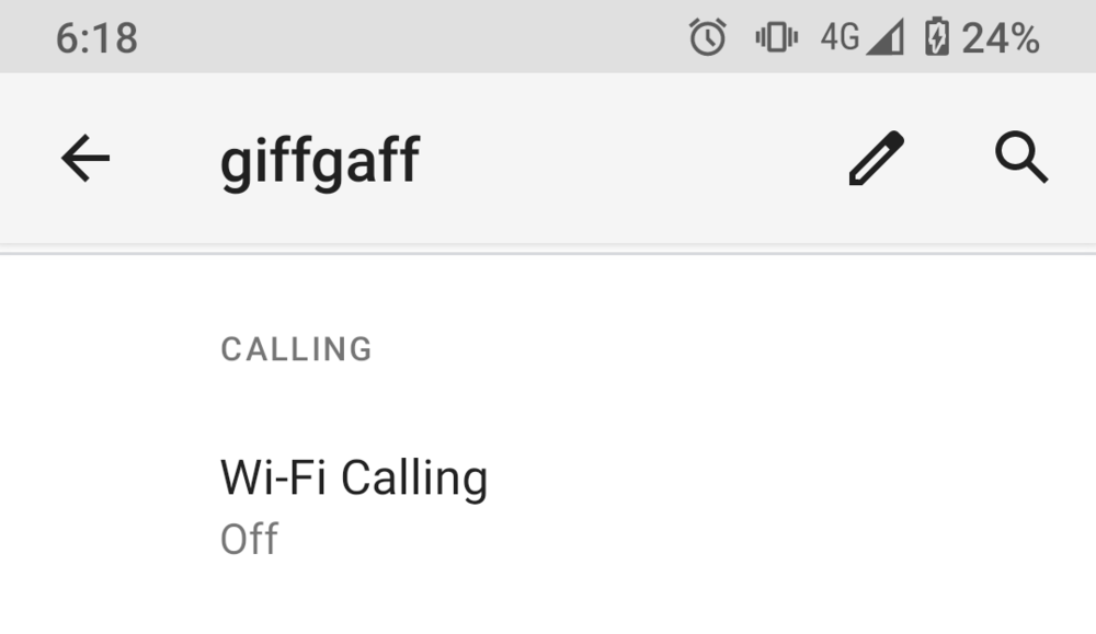

Tim6263 134 Posted January 5, 2023 Author Share Posted January 5, 2023 Thank U 4 yr response @VaZso I've done some more checking, now home from work so in a different WiFi zone. As U can see, WiFi calling is 'Off'. I've uninstalled a few apps, incl. MacroDroid, in case these might be interfering some how. But the only thing that seems to affect accepting in coming calls is whether WiFi is switched On or Off; not whether or not it's connected, just whether it's On or Off. Quote Link to post Share on other sites
