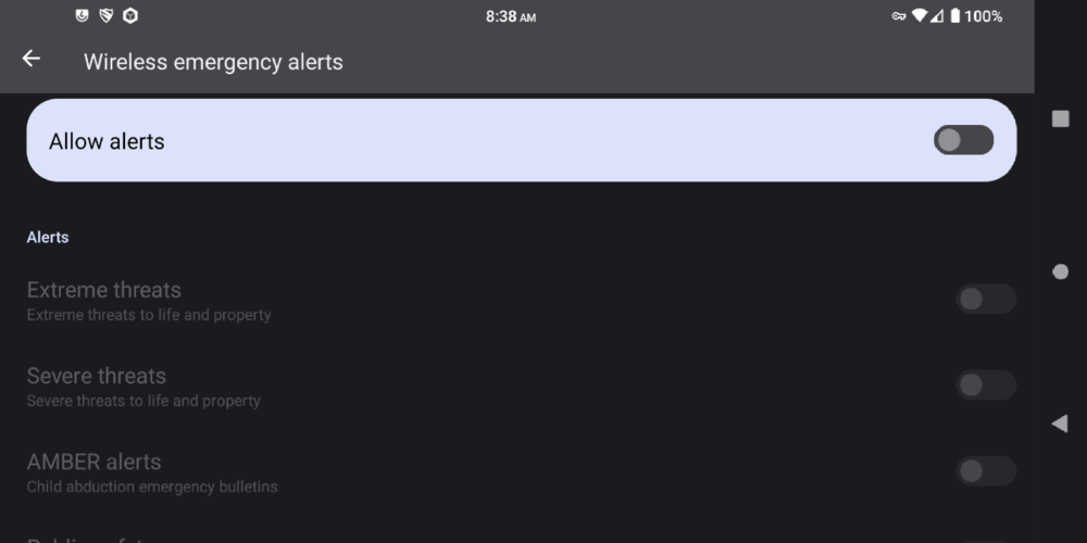

Hook 3,203 Posted May 19, 2023 Share Posted May 19, 2023 3 hours ago, MonCon said: Ia there any way to disable 'Emergency alerts', I can't find a way. (Pro1X LOS20) Settings, Notifications, tap wireless emergency alerts. 1 1 Quote Link to post Share on other sites

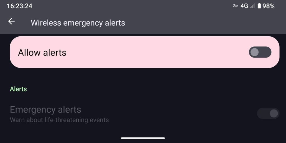

MonCon 129 Posted May 20, 2023 Author Share Posted May 20, 2023 (edited) Thanks @Hook, I've tried settings/notifications/wireless_emergency_alerts and settings/safety_and_emergency/wireless_emergency_alerts and turned off what I can, but one of the selections (emergency_alerts) is greyed-out and active. I don't suppose rooting would make a difference?, maybe I'm stuck with it. Edited May 20, 2023 by MonCon Quote Link to post Share on other sites
EskeRahn 5,574 Posted May 20, 2023 Share Posted May 20, 2023 Guessing here but some countries might have legislation that prevent it from being turned off. It might be something forced deep in the android kernel? Here in DK, on a Pro1 (not X) on LOS20, I AM allowed to turn them off, On both a Pro1X and a Pro1 on stock Android it is the same. I have not flashed a Pro1X with Lineage (yet), but seems unlikely that it should be generally disabled by LOS for the Pro1X.. 2 Quote Link to post Share on other sites
Hook 3,203 Posted May 20, 2023 Share Posted May 20, 2023 Strange, thats not what I see on my Pro1x. I wonder if local carrier policy provided by sim would make a difference. 1 Quote Link to post Share on other sites
