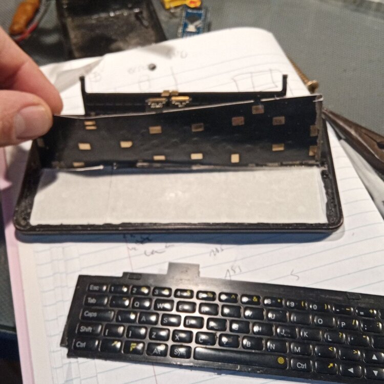

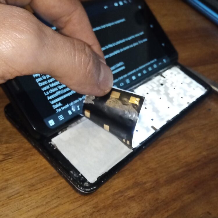

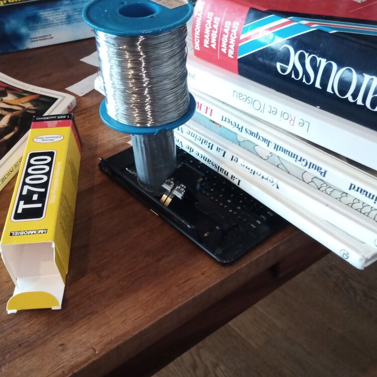

raymo 183 Posted January 19, 2025 Share Posted January 19, 2025 (edited) Hi everyone I think I found a trick to repair my old pro1 keyboard. Facts : -some models have keyboard problems since beginning -some users reported some problems after a few years of use -problems listed are everytime the same : some ghosting touch (example : you type 'a' and nothing appears, or a triple 'a' suddenly pop... -when I removed the keyboard cap (the things with the buttons) a few years ago it solved all keyboards problems, for a few months or so -Completely removing the keyboard "white things" (things with contact touch and led, no idea for the correct name), it appears that the keyboard works as expected. So the idea is that the glue must insulate things under keyboard, and with time of use, or bad quality glue or whatever you could imagine, the keyboard will report some weird results. Maybe. Then I put a thin paper (from an back-adhesive papers) between the metal and the white things, adding electrical insulation. ...and my pro1s keyboard is working again. The hard things is to glue everything back, I use some T7000 adhesive glue and press it with a pencil and books, to press where it should press. You can clean the extra glue with "Essence F" but don't wait too long. If I'm correct this may be a solution, we will see.... Edited January 19, 2025 by raymo typo-clearance 3 Quote Link to post Share on other sites
