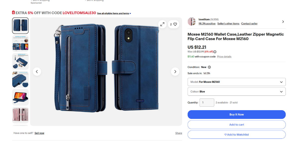

hling 14 Posted April 23, 2025 Author Share Posted April 23, 2025 15 hours ago, Lollerobot said: I've 3d printed the hard case and glued it to a somewhat correct size leather case. There was a topic here somewhere that has a list of leather cases that fit the Pro1x dimension wise, though none just fit without tinkering with the case a bit. I was looking online, and guesstimating. There was a Moxee M2160 that looked similar, except for the charging connector being on the back of the case instead of at the bottom of the case. I might try to get a wallet case for that phone and see how close i get. Thank you for your reply! Quote Link to post Share on other sites

hling 14 Posted May 19, 2025 Author Share Posted May 19, 2025 one more note regarding protecting my battered Pro 1x: I ordered one of these cases, took out the wallet insert quite easily, increased the cut out at the bottom for the charging access, and figured out that if I open my Pro 1x, I can insert the bottom, keyboard portion into the case quite snugly, and then i can slide the phone close and open securely. I just have to memorize the locations of the up, down and power buttons as they don't correspond exactly, but not difficult. Now I don't feel like i'm risking another disaster. Hope this can be of help to others. 2 2 Quote Link to post Share on other sites
