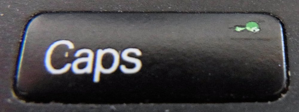

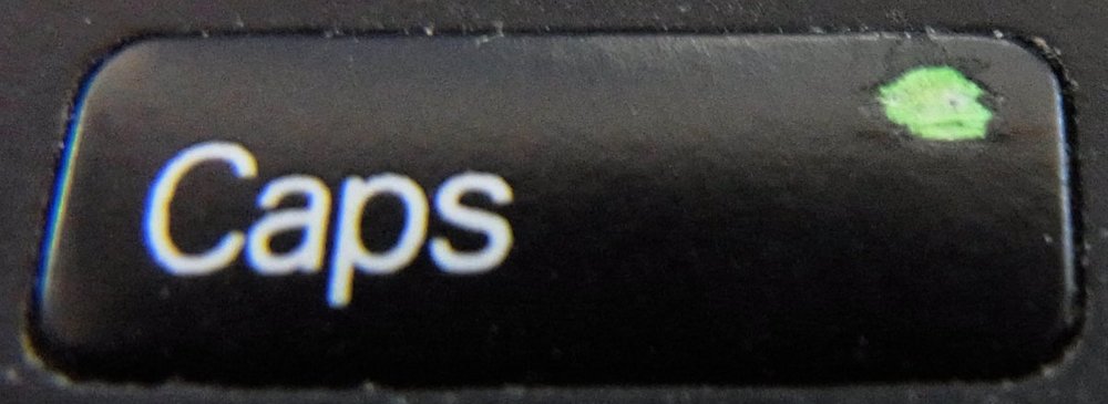

EskeRahn 5,596 Posted February 18, 2020 Share Posted February 18, 2020 18 minutes ago, netman said: That just means the keys are separate parts i guess You should try tipping the keyboard against the light, and at the right angle it can be seen that the yellow print (and the green Caps) is a coloured square slightly lifting the black. If you got sensitive fingertips, you can actually feel the slight 'jump' gliding the finger lightly over the key tops with yellow print. NOTE that some got the mat but NOT the print, I guess prepared for different prints. (e.g. the W on qwertY). It is easiest to spot on Caps. I tried to extend the small green dot on the preProd unit, not that succesful, but it clearly shows the white under green under black... 1 Quote Link to post Share on other sites
netman 1,424 Posted February 18, 2020 Share Posted February 18, 2020 2 minutes ago, EskeRahn said: I tried to extend the small green dot on the preProd unit, not that succesful, but it clearly shows the white under green under black... That does clearly show it is a coating. Now I wonder how they did the colors :). Quote Link to post Share on other sites
EskeRahn 5,596 Posted February 18, 2020 Share Posted February 18, 2020 44 minutes ago, netman said: That does clearly show it is a coating. Now I wonder how they did the colors :). You can see the square 'mat' around the green above... Just did a new more successful attempt expanding it further to a larger part of the mat. (the white damage from my first attempt is roughly in the middle now, as I scratched practically to the lower edge of the 'mat') Quote Link to post Share on other sites

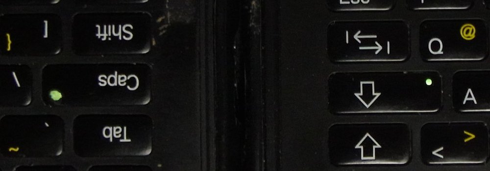

EskeRahn 5,596 Posted February 18, 2020 Share Posted February 18, 2020 PS do NOT expand the caps hole that much on the real units, the LED on the PreProd unit is much weaker (and the hole smaller), hence the need here... PreProd left Retail right. Backlight off, caps on for both. 1 Quote Link to post Share on other sites
