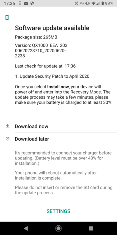

EskeRahn 5,596 Posted June 23, 2020 Share Posted June 23, 2020 5 hours ago, Alwayswithasmile said: You are one of those with the not yet certified software... 😥 EDIT: I have just been offered the new OTA update.... Just checked it passes SafetyNet check now. 🙂 1 1 Quote Link to post Share on other sites
Alwayswithasmile 3 Posted June 23, 2020 Author Share Posted June 23, 2020 Looks like a solution is in sight. @elvissteinjr Made a good point; Quote so I don't know if you can just update from this build to the new certified or have to reflash completely, I will see if an update comes down tonight. Once again thanks for all your help. Quote Link to post Share on other sites
EskeRahn 5,596 Posted June 23, 2020 Share Posted June 23, 2020 1 hour ago, Alwayswithasmile said: I will see if an update comes down tonight. Or try polling using: Settings►System►Advanced►System Update 😉 Quote Link to post Share on other sites
