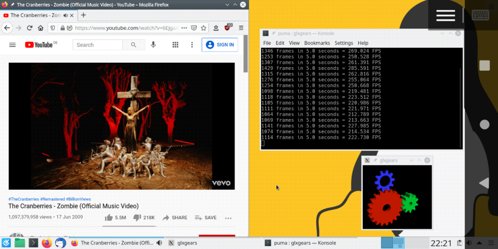

claude0001 1,424 Posted April 1, 2021 Share Posted April 1, 2021 (edited) Update: I can now run the X.org X11 server inside my Devuan chroot. Yes, the real thing, not TigerVNC or TightVNC. The nice thing with X.org is that I can use it with xorgxrdp in the chroot and connect to my Linux distro via a much better-performing (native) RDP connection as compared to using VNC as backend for XRDP. I still use the Microsoft Remote Desktop 8 App combined with the default xrdp-0.9.9 shipping with Devuan 3/Debian 10. As far as I can see, one can find no information on how to do this on the internet. Either it is really tricky and I am a genius, or no one cares about it ... difficult to say. 🙂 So, how to do it? The critical point with the xorgxrdp module for X.org is that it absolutely requires System-V-style shared-memory access. The Android Linux kernel does not provide that, as Google invented their own implentation of shared memory (/dev/ashmem) long ago. So, the first step is to bind-mount /dev/ashmem to your Linux chroot, by having something like this in your chroot setup script (of course this requires root-access to your phone): # Script to set up the Debian/Devuan chroot environment on boot of LineageOS export ROOT=/data/DEBIAN [...] mount -o bind /dev/ashmem $ROOT/dev/ashmem [...] Having /dev/ashmem available to your Linux distribution is not enough, though, as GNU/Linux shared-memory calls are not compatible with that interface out-of-the-box. Luckily, some awesome people have made android-shmem, a library translating Sys-V-shared-memory-calls to Android-shared-memory-calls. You need to compile that library inside your chroot and then preload it previously to running any program depending on Sys-V-style shared memory, as explained on the GitHub page. For xorgxrdp to work, one needs two things: XRDP needs to be started with android-shmem preloaded. In Devuan 3, I do this by having the following edit in "/etc/rc5.d/S12xrdp": [...] # enable Sys-V shared memory access on Android kernel export LD_PRELOAD="/usr/local/bin/libandroid-shmem-aarch64.so" [...] X.org must be started via a wrapper script, also preloading the android-shmem library: #!/bin/bash # # Wrapper script for Xorg when called from XRDP. # Makes sure the 'android-shmem' library is preloaded before execution so that # SYS-V-style shared memory calls will work on Android kernel. # origparams="$@" exec env LD_PRELOAD="/usr/local/bin/libandroid-shmem-aarch64.so" /usr/lib/xorg/Xorg $origparams On Debian/Devuan, most likely, you will want to configure /etc/xrdp/sesman.ini to lauch that wrapper script instead of X.org directly. Attachment: MS Remote Desktop showing an xorgxrdp session on my Pro1 with a youtube browser window (with audio streaming via XRDP) and a simultaneous glxgears benchmark. Edited April 2, 2021 by claude0001 2 7 Quote Link to post Share on other sites
