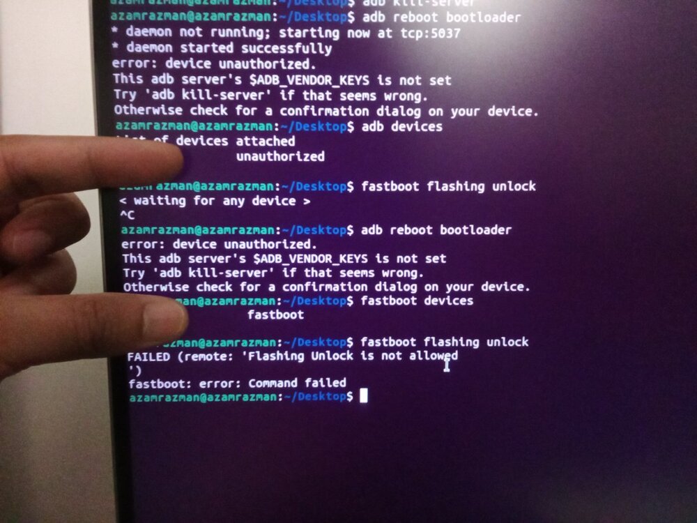

azamrazman 7 Posted May 2, 2023 Share Posted May 2, 2023 Hi Community, I've successfully flashed the official Lineage OS (LOS) (with Gapps) for the Pro1X. But, in an attempt to use banking apps, I was hoping that Locking the Bootloader may help "trick" the Banking Apps to allow me use in on LOS. Sadly... it does not allow me to go back to Unlock mode. I am now stuck in a loop... cannot boot into my LOS. Please help! Thanks! 2 Quote Link to post Share on other sites
Hook 3,370 Posted May 2, 2023 Share Posted May 2, 2023 I think this is your best hope... Note. I've never done this myself. As you've learned the hard way, you cannot OEM lock the bootloader on anything but the OEM stock. If you want a locked bootloader, you will have to stay on stock Android. 1 Quote Link to post Share on other sites

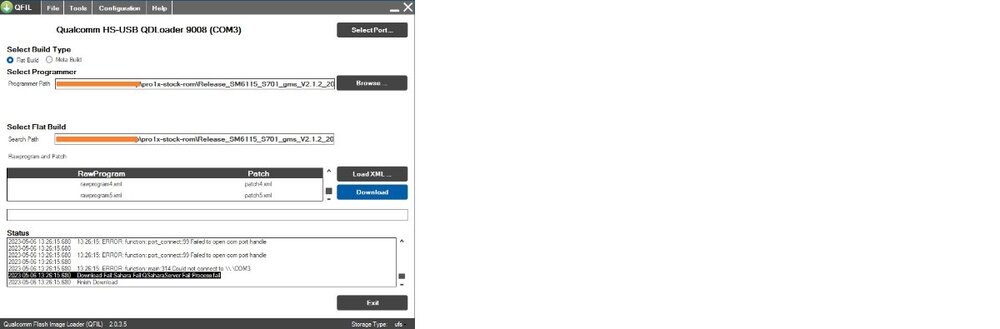

azamrazman 7 Posted May 6, 2023 Author Share Posted May 6, 2023 On 5/3/2023 at 12:56 AM, Hook said: I think this is your best hope... Note. I've never done this myself. As you've learned the hard way, you cannot OEM lock the bootloader on anything but the OEM stock. If you want a locked bootloader, you will have to stay on stock Android. Hi Community, I tried using this method. Unfortunately, it does not seems to work. Is this the end for my Pro1x? Or is there still some hope? Quote Link to post Share on other sites
azamrazman 7 Posted May 8, 2023 Author Share Posted May 8, 2023 On 5/6/2023 at 2:22 PM, azamrazman said: Hi Community, I tried using this method. Unfortunately, it does not seems to work. Is this the end for my Pro1x? Or is there still some hope? Dear Community, I wish to announce that the solution in the provided link does indeed work! It solved my accidental lock on my Lineage OS Bootloader for my Pro1X, by clean install everything. I would like to highlight that you may need to DISABLE DRIVER SIGNATURE ENFORCEMENT on your Windows Machine. This was the one headache I had throughout the process... didn't realise I needed to disable driver inforcement. Silly me! Thank you community for your kind support! Cheers! 1 4 Quote Link to post Share on other sites
