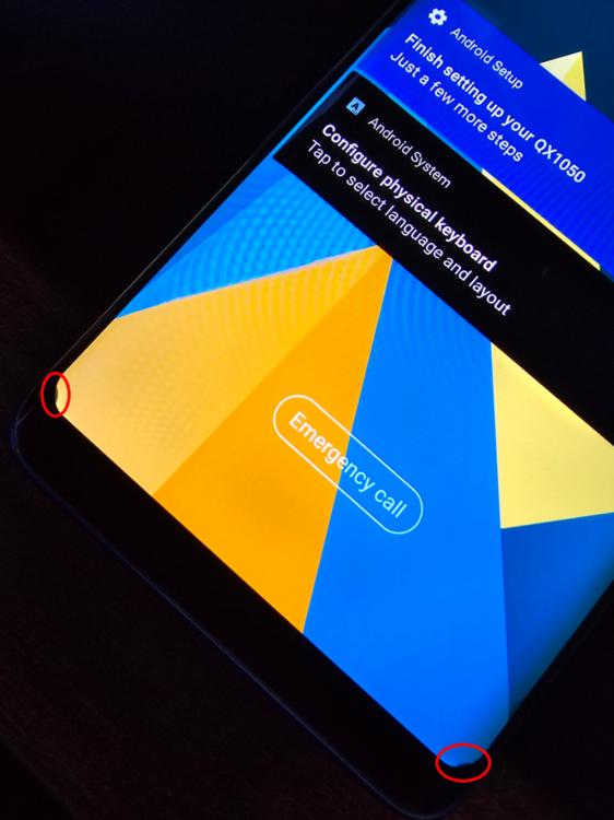

tbp 3 Posted July 2, 2024 Share Posted July 2, 2024 I have the same problem, almost. The earpiece doesn't work, but the mic seems to work in stock android and lineage. Speaker phone works, and bluetooth works. In ubuntu or sailfish both are dead, even bluetooth 😞 I also have some weird blue "bubbles" at the bottom of the screen. Have you got those? Quote Link to post Share on other sites

chrissv 7 Posted July 3, 2024 Author Share Posted July 3, 2024 14 hours ago, clueless said: (despite of both of us seemingly using a Swedish provider) ... I can confirm (at least for my unit). Distinctly pressing at the marked spot (front and back of slot for earpiece) created a squeaking noise, such as plastic parts being clicked into place. After that, phone audio is working fine through the earpiece on my unit. Only question being, how permanent this "fix" will be... Yes, using Swedish/Norwegian provider Telenor. Sadly, this trick does not work for me, it stays silent as the grave, dispite any amount of "firmly pressing" this spot (or the areas around it). I dont get the "click" sound either, so that makes sense, I suppose. 15 hours ago, tbp said: The earpiece doesn't work, but the mic seems to work in stock android and lineage. Speaker phone works, and bluetooth works. ...I also have some weird blue "bubbles" at the bottom of the screen. Have you got those? The mic works for me too, as well as speaker phone. Did not get around to trying bluetooth yet, as I figure the phone is more or less unusable if I cant use it for making calls. I also do have these weird little blobs, just on the lower corners (holding the phone in portrait mode), not on the upper ones. @MonCon, gonna check out those links, thanks. Quote Link to post Share on other sites

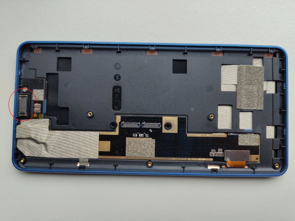

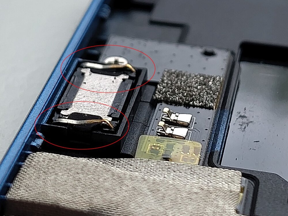

chrissv 7 Posted July 4, 2024 Author Share Posted July 4, 2024 (edited) Ok, so, good news! After some pondering, I decided to open the thing up. It was actually not that hard to take apart, the official Fxtec instructions for disassembling Pro1/Pro1 X (https://vimeo.com/483552998) were easy to follow. Note: I did not use a prying tool, as I found it easier to do with my fingers (as the plastic frame is fitted to the metal quite snuggly, I found it hard to get a prying tool in there). And a word of caution: the black paint on the back of the display chips really easily when removing the 5 screw covers. Once I had the display frame removed and the ribbon cables disconnected, the ear piece was easy to locate. It connects to the rest of the phone with spring connectors. On my device, the springs were not at all that springy, but pressed pretty much flat against the ear piece itself. So what I did was I used a tweezer and ever so slightly bent them upwards, to increase their contact strength. Then I put everything back together, and viola! Now I have a working ear piece. Thanks everyone for your input! I took some photos for reference: Edited July 4, 2024 by chrissv Fixed Vimeo link. 2 5 Quote Link to post Share on other sites
