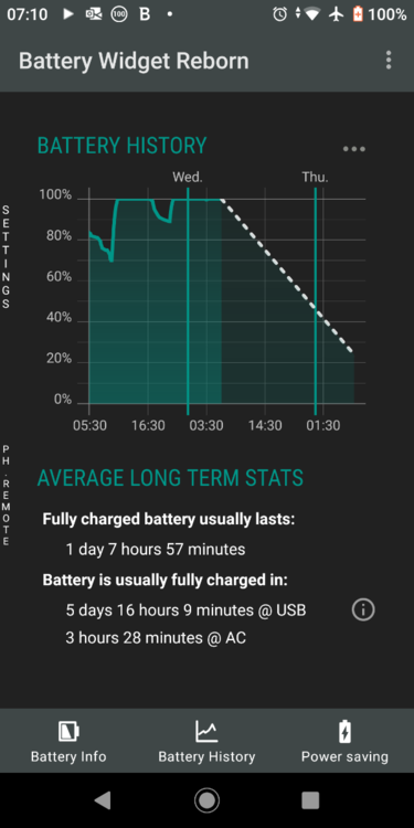

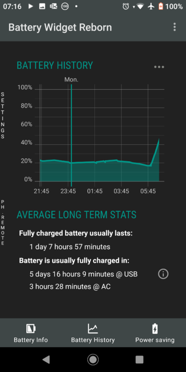

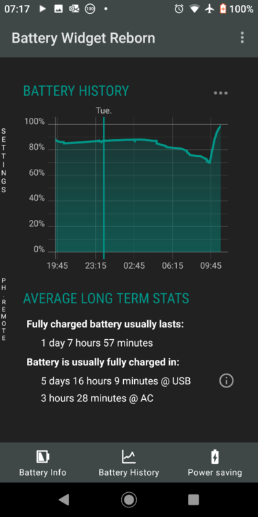

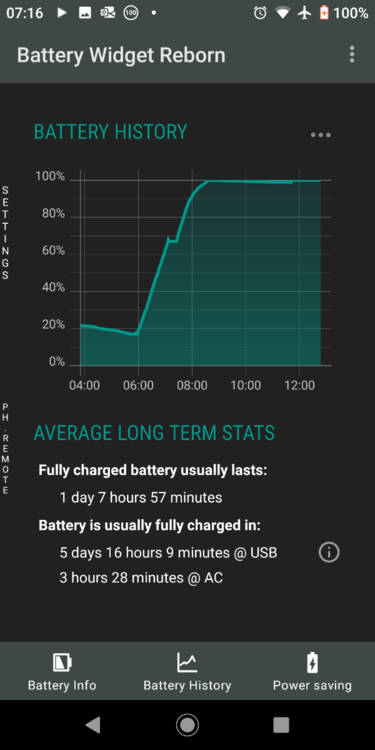

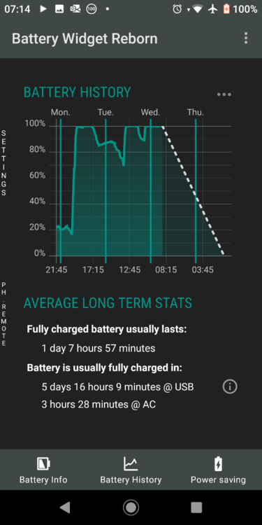

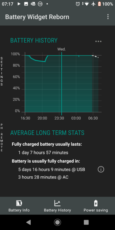

ahunter 108 Posted September 15, 2020 Author Share Posted September 15, 2020 Quote Link to post Share on other sites
ahunter 108 Posted September 15, 2020 Author Share Posted September 15, 2020 (edited) 10 minutes ago, ahunter said: This is the sort of behavior it is exhibiting, you will note glitches on the graph, this is when it stops charging all together. The flat or slight up or downward slop is when it is in slow charging mode, can barely maintain power. Then when I finally get the charge to work it comes up at its normal rate. Edited September 15, 2020 by ahunter Quote Link to post Share on other sites
EskeRahn 5,399 Posted September 16, 2020 Share Posted September 16, 2020 9 hours ago, ahunter said: This is the sort of behavior it is exhibiting, you will note glitches on the graph, this is when it stops charging all together. The flat or slight up or downward slop is when it is in slow charging mode, can barely maintain power. Then when I finally get the charge to work it comes up at its normal rate. Hmm, it seems like normal relative slow charging when charging in 2-3 hours in your third dump. It is quite as it is supposed to be for the charging to slow down the rate significantly when closing to 100%. It is a little difficult from the graphs to guess when the phone is idle and when it is doing 'something' (with or without user-interaction). And also what type of charger that are used at the various charging periods. Percentages are estimates not absolute measurements so this makes interpretations even harder. But what I suppose is idle consumption the night on the second dump, does look a bit steep, so maybe you should have a look at what apps are eating your 'juice'. In Aeroplane mode I would expect no more than 0.3-0.5 %/h drainage idle.ADD: I just noticed that it is not pure Aeroplane mode, but with WiFi. Here the router used can make a significant difference. Quote Link to post Share on other sites
ahunter 108 Posted September 16, 2020 Author Share Posted September 16, 2020 the last dump is where it just would not charge, slow charging displayed... and power still going down. It seems to have sorted its self somewhat. 1 Quote Link to post Share on other sites
