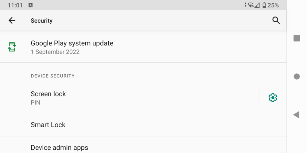

EskeRahn 5,596 Posted October 23, 2022 Share Posted October 23, 2022 In Settings ► Security , down in the group "Device security", what options do you see? I got "Screen lock", "Fingerprint" and "Smart Lock" (...Just to be sure you are on stock Android, right?) Quote Link to post Share on other sites
147 12 Posted October 23, 2022 Author Share Posted October 23, 2022 I just have the two options as per the screenshot below. I believed I have stock Android yes. I tried to reboot the stock OEM ROM and followed all the steps several times and it just wouldn't work so assumed already had it. Then I managed to lock Android to get Google Pay and so on. The fingerprint option wasn't available before and still isn't now! Thank you for your support. Quote Link to post Share on other sites
EskeRahn 5,596 Posted October 23, 2022 Share Posted October 23, 2022 Now that is weird, Maybe you need to check with support ( https://fxtec.com/contact-us ) But maybe first ask the seller if (s)he had the fingerprint-reader working? I know from the old Pro1 that some disliked the fingerprint-reader so much that they unplugged it, and who knows, the previous owner might have done so on your Pro1X? Quote Link to post Share on other sites

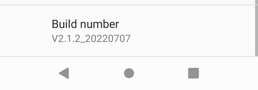

EskeRahn 5,596 Posted October 24, 2022 Share Posted October 24, 2022 I'm not totally sure but Settings ► About Phone ► Build Number Should say V2.1.2_20220707 There is a version without Google-apps available available (non-GMS) here, I do not know if it got the same stamp. The beta-versions available I expect will have newer stamps. Quote Link to post Share on other sites
Casey 321 Posted October 24, 2022 Share Posted October 24, 2022 11 hours ago, Ryan said: I am afraid not. No option for it at all! Odd I thought as everything else so far seems OK. Welcome! Could you take a screenshot of the build number in Settings -> About phone -> (scroll to bottom) Build number. Quote Link to post Share on other sites
147 12 Posted October 24, 2022 Author Share Posted October 24, 2022 (edited) Thank you guys it is that build number yes Edited October 24, 2022 by Ryan 1 Quote Link to post Share on other sites

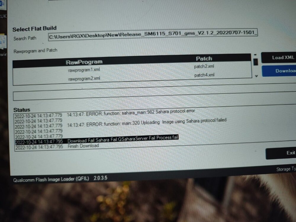

147 12 Posted October 24, 2022 Author Share Posted October 24, 2022 Thank you. I have factory reset several times to no avail. I tried to install the stock OEM yesterday but it didn't work. What I will do now I am aware of this excellent support network is show the error message I am getting on QFIL. 1 Quote Link to post Share on other sites

Casey 321 Posted October 24, 2022 Share Posted October 24, 2022 1 hour ago, Ryan said: show the error message I am getting on QFIL What type of error do you get when you tried flashing the stock OS on QFIL? Best to check if your PC is able to recognise your Pro1-X under EDL mode. Go to device manager on your computer and boot your phone into EDL mode, see if there's either an exclamation mark or e.g. COM10 port available. Either way, feel free to email all the info you've got so far to our support desk [email protected] and let me know the ticket number. I'll take a look. 2 Quote Link to post Share on other sites

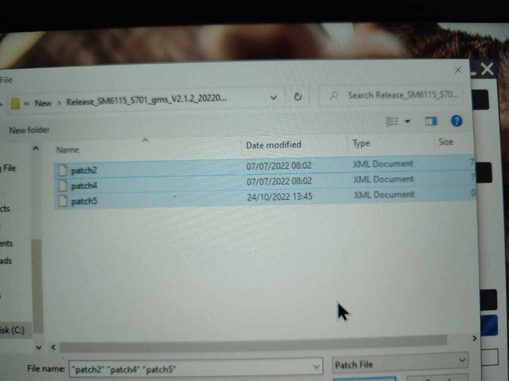

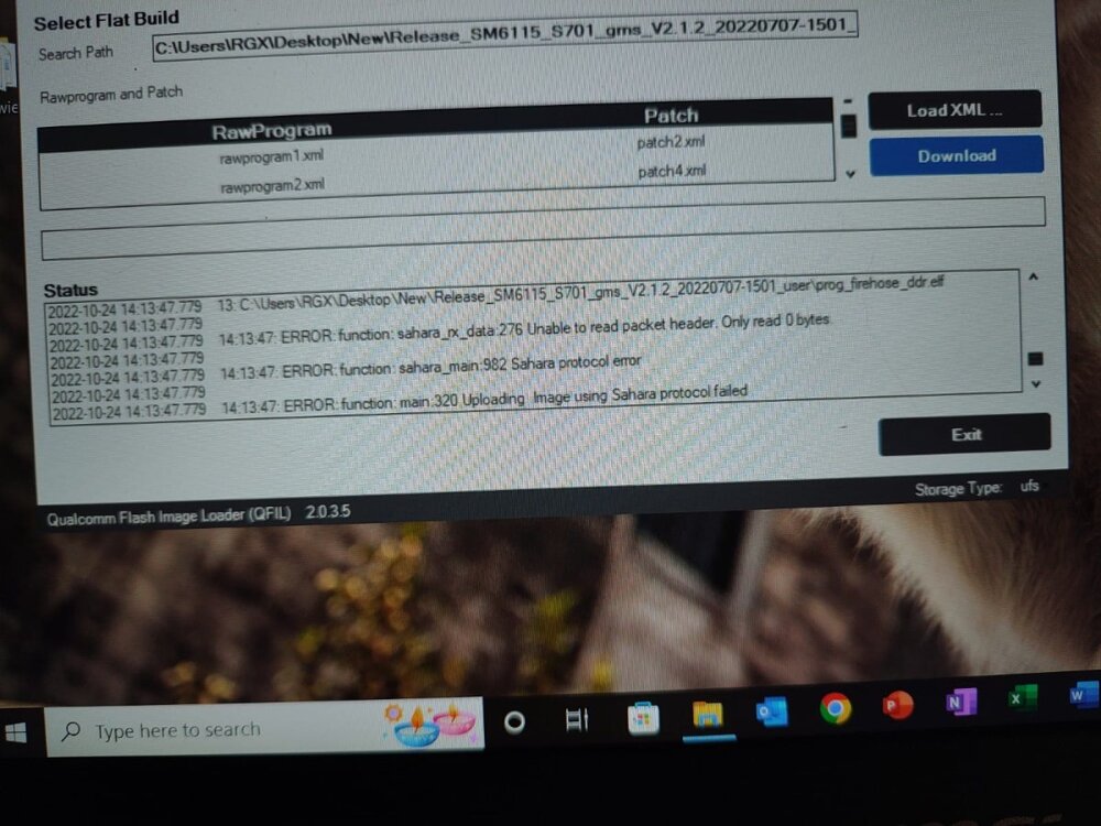

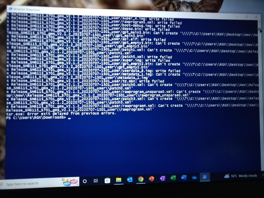

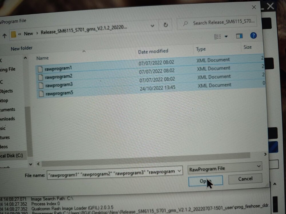

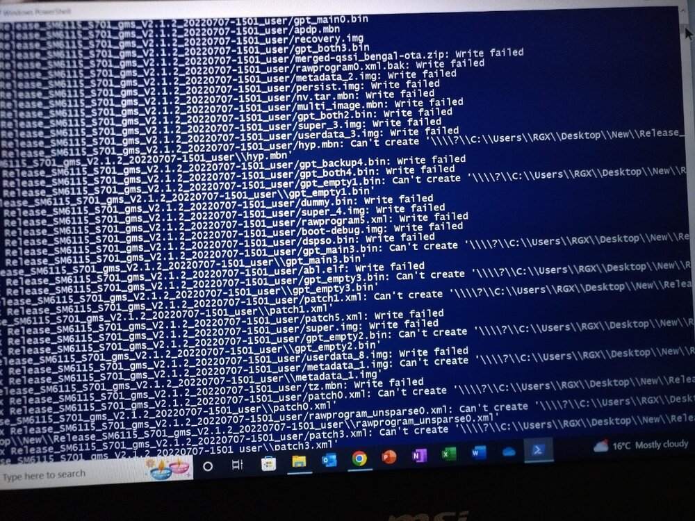

147 12 Posted October 24, 2022 Author Share Posted October 24, 2022 I will do that. Just to confirm phone is fine in EDL mode and can be seen on the PC as per the instruction pack. I thought I'd share these photos from the extraction of the file. Had this every time I have run it. Starts fine and as per the screenshot in the instruction pack. Not sure if it is normal. But wondered if this was why my flashing attempt was unsuccessful 1 Quote Link to post Share on other sites

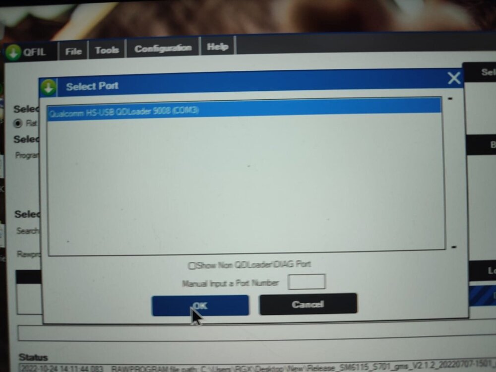

147 12 Posted October 24, 2022 Author Share Posted October 24, 2022 I am afraid my efforts to flash the ROM have failed again with the same issues as yesterday. Have included some images incase anyone can offer any advice. I've checked the document and followed it I believe to the letter several times but not getting anywhere! 1 Quote Link to post Share on other sites
EskeRahn 5,596 Posted October 24, 2022 Share Posted October 24, 2022 Hmm, I do not know much on the QFIL-flashing, But my hunch is that the partitioning is wrong. Could it be that something have resized partitions, in a way the standard flashing procedure do not overwrite? It reminds me of bugs on disks or usb-sticks where the partition table is incorrect. Obviously there is also the risk of a defective storage chip. Let us hope @Casey can help.... Quote Link to post Share on other sites
147 12 Posted October 25, 2022 Author Share Posted October 25, 2022 Thank you, I hope so too! Quote Link to post Share on other sites
Casey 321 Posted October 25, 2022 Share Posted October 25, 2022 @Ryan, I see, it's the infamous sahara error. I've got quite a few of those before too. According to your screenshots, you don't have the correct number of XML files (rawprogram and patch files). The correct files should be: rawprogram_unsparse0 rawprogram1 rawprogram2 rawprogram3 rawprogram4 rawprogram5 AND patch0 patch1 patch2 patch3 patch4 patch5 I suggest you to re-extract the tar.gz file again using a free software called 7zip. Once downloaded, right click on the tar.gz file and select "7zip >" to extract. Additionally, here's some tips to avoid getting the sahara error: 1. Download a previous version of QFIL v2.0.2.3 and try again. Make sure to select and tick the correct boxes in Configuration settings. 2. Try out a different USB-C cable and USB port on your PC. 3. Make sure there's no space in your file path when you select the ddr.elf file. 4. And just try a few more times... Good luck! 😄 Quote Link to post Share on other sites

147 12 Posted October 26, 2022 Author Share Posted October 26, 2022 Hi @Casey, apologies for the delay but I was working away yesterday so only had the chance to try these steps out last night. So good news and bad news! The extraction process worked with 7Zip and I have managed to get all the correct files and I am using the older version of QFil but I am still getting the Sahara issue after several attempts. As I locked the phone to Andorid, do I need to unlock it for this to work? Now I have all the extracted files, should I try the newer version of Qfil? Is there an alternative way I can flash the stock ROM? I will keep trying in the meantime! Thank you so much for helping me get this resolved. Quote Link to post Share on other sites
