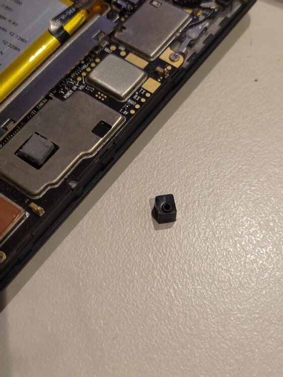

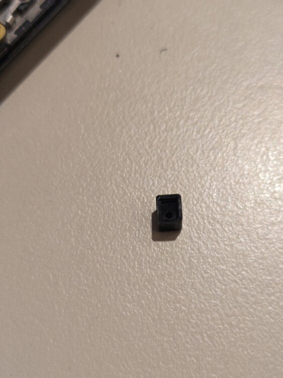

Noob 158 Posted July 28, 2023 Author Share Posted July 28, 2023 (edited) So I've taken my phone apart, and it's been pretty disastrous. The only good news is that my battery still holds a lot of charge, the multimeter reported a voltage of 4.13v. The problems started when I tried to reassemble it. The connector for the fingerprint sensor is rage-inducing to snap back on, and after 40 mins I though I finally succeeded when I realised I broke off the ribbon cable. So no more fingerprint sensor. 😠 While doing so, some small piece of rubber seems to have fallen off, and I can't figure out where it goes after scouring the inside of the phone, the case, and Fxtec's video for replacing the battery. I've attached pictures, does anyone know what it's for? Finally, I tried putting it all together minus a working fingerprint sensor (which I never use anyway), and decided to hook up the display assembly from my Pro1x. Still no sign of life. At this point I realised that the volume controls no longer work; the rocker buttons don't seem to extrude any more. I don't know if it's the cause, but there's a thin black coating of something (paint? membrane) that's sheared off possibly when I took the back cover off. Maybe that's just to insulate it from the metal contacts of the switch, I don't know. Either way I've tried pulling apart and reattaching the back case, but no go. So I think I've ruled out charging, but no closer to understanding why. If it's a serious issue with the motherboard I'm really worried because my data is likely lost. Plus my Pro1 can't be fully reassembled any more. Edited July 28, 2023 by Noob 2 Quote Link to post Share on other sites
david 929 Posted July 29, 2023 Share Posted July 29, 2023 (edited) @Noob - did you try booting it with the phone apart and the battery plugged in? If not, you can try holding in the power button for 30+ seconds and see if it will boot. My pro1 is still apart, and the only thing I can see that sort of resembles that piece is the rubber insert by the mic port. But it doesn't look exactly like your mystery piece of rubber. Edited July 29, 2023 by david Quote Link to post Share on other sites
foxfreejack 60 Posted July 29, 2023 Share Posted July 29, 2023 I am no longer sure for which one, but there are two microphones, one at the bottom and one on the back, near the camera. This rubber is for one of the two. 1 Quote Link to post Share on other sites
Noob 158 Posted July 30, 2023 Author Share Posted July 30, 2023 Thanks @davidand @foxfreejack for your replies. I sent an email to fxtec support, and they said the same thing (mic cover). I think the cover is still inside the reae case for the bottom mic, so I'm guessing it's the top one. Asked them for a photo to confirm. I tried booting the phone while disassembled and the battery reconnected, no luck. Support suggested trying to recharge the battery somehow in case it's dead, otherwise it'll be much harder to recover data. I don't want to wait a couple of weeks for AliExpress, and the local sellers with battery charging boards don't have the Mi6 connector, but a Mi6 battery is locally available so I'll give that a try. I don't have much hope due to the 4.13v reading, but I guess it's possible the battery has a high internal resistance and the voltage drops when a load is drawn. I don't have an easy way to test this (maybe if I hook it up to my LED light strip, but I think that needs 12v and I don't think it'll be easy to connect anyway). Quote Link to post Share on other sites
