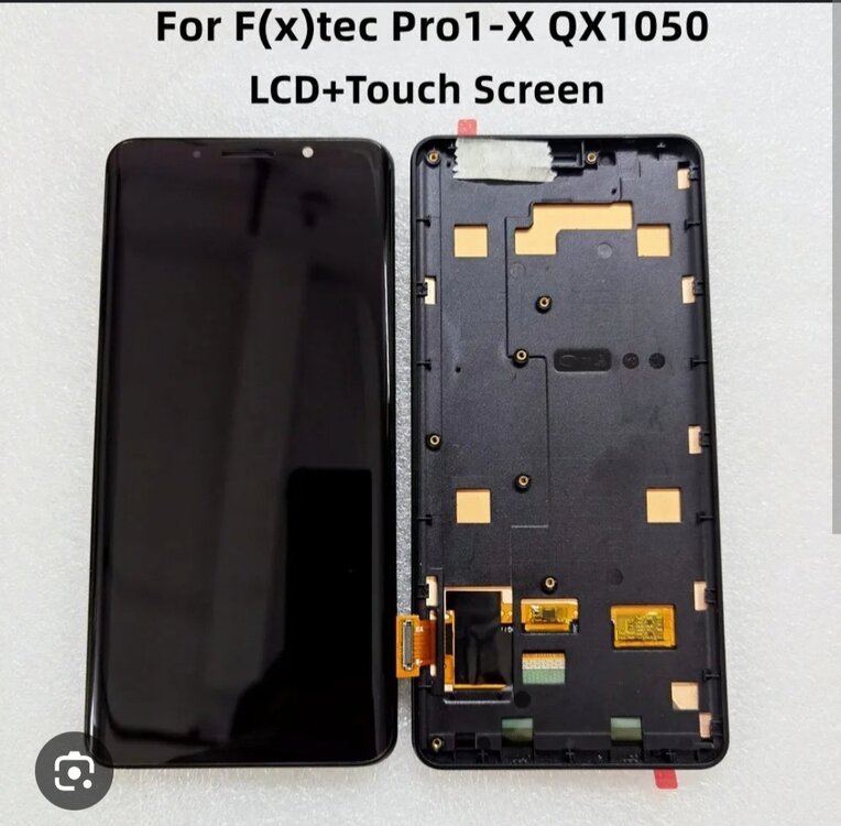

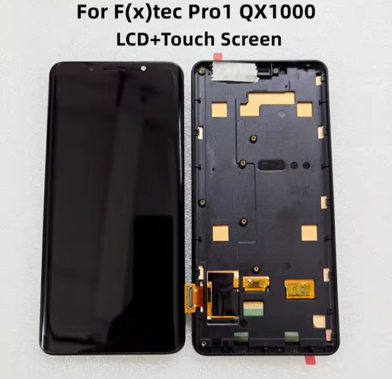

FlyingAntero 871 Posted September 5, 2024 Share Posted September 5, 2024 1 hour ago, Hook said: I was under the impression that the frame for the Pro1 is not 100% identical to the frame for the Pro1x (different camera? Other subtle differences?). Anyone know. I can't remember. I was thinking that they are the same. Is the selfie camera different? I thought that only rear camera is different. But anyway, maybe @gusscan confirm? I think guss ordered pro1 screen panel with frame for Pro1-X. Also, some sellers list same screen for both Pro1 and Pro1-X (see attachments). 1 Quote Link to post Share on other sites
Hook 3,368 Posted September 5, 2024 Share Posted September 5, 2024 1 hour ago, FlyingAntero said: I was thinking that they are the same. Is the selfie camera different? I thought that only rear camera is different. But anyway, maybe @gusscan confirm? I think guss ordered pro1 screen panel with frame for Pro1-X. Also, some sellers list same screen for both Pro1 and Pro1-X (see attachments). That's good news then. Quote Link to post Share on other sites
