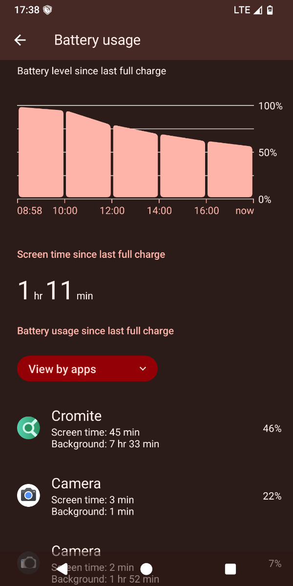

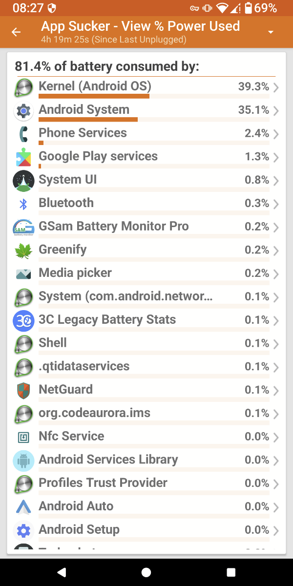

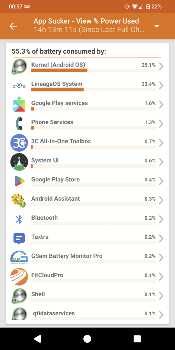

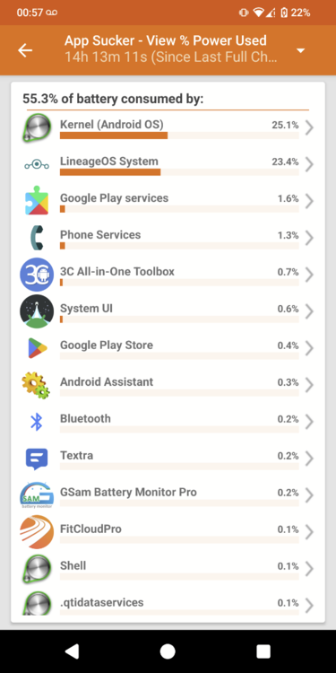

EskeRahn 5,596 Posted May 6, 2025 Share Posted May 6, 2025 5 hours ago, TeZtdevice said: Updated / now closed ticket: Nolen Johnson1 hour ago No such drain here - must be something you're doing mod or app wise. Hmm the below seems to say otherwise. But It MIGHT be the lacking factory reset that triggered the bug. Quote Link to post Share on other sites

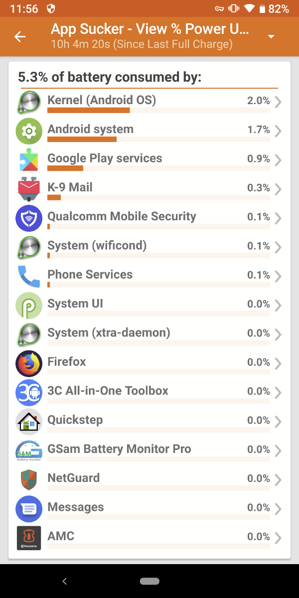

EskeRahn 5,596 Posted May 6, 2025 Share Posted May 6, 2025 ....For comparison here an old one from stock: Note that it is at 82% after 10h, and even among that MUCH lesser usage, a lesser portion is apps. 1 Quote Link to post Share on other sites

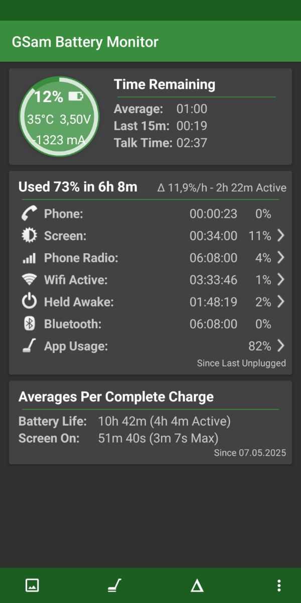

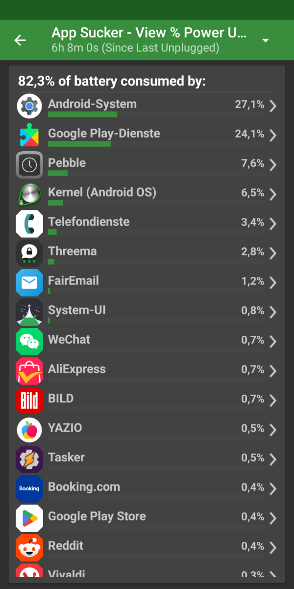

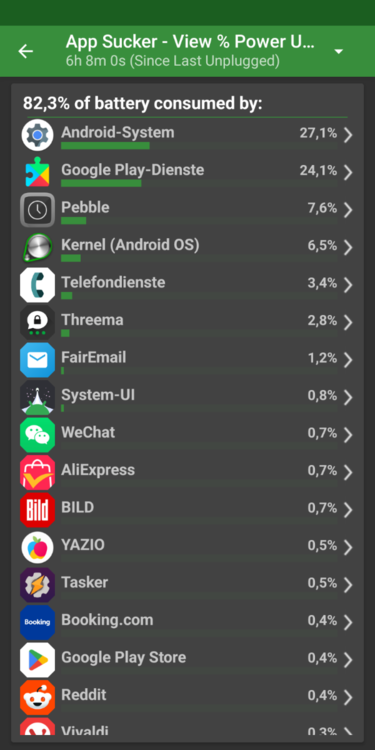

TeZtdevice 365 Posted May 7, 2025 Author Share Posted May 7, 2025 That´s my stats (only 34min. screen time this day): Quote Link to post Share on other sites

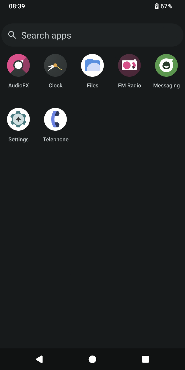

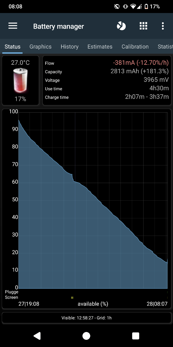

EskeRahn 5,596 Posted May 13, 2025 Share Posted May 13, 2025 On 22.2 (without factory reset) it went from 100 to 72% in 8h idle over night, so 28% compared to 6% for 8h on 22.1! ..Just did a factory reset, no net, no sim, no account, and disabled all I can (leaving it totally useless - see attached), and will recharge and see how things goes... 1 1 Quote Link to post Share on other sites
EskeRahn 5,596 Posted May 13, 2025 Share Posted May 13, 2025 (BTW it seems so greedy that the reduced current at 98% makes it hard to reach 99%, it has been at "98% - charging" for over half an hour 🙈... display off, checks about every five minute...)UPDATE: Got it charged to 100% and after 3h it is down to 96% and that is OK. So now I will try to reenable the stuff I disabled, and recharge. But still No sim, no WiFi, no appsUPDATE: After 75m it is down to 99% and that is OK. So now I tried to add sim and WiFi, no account, no apps, and recharged.UPDATE: After 4h it is down from 100 to 82% and that is not good, 4½ %/h... I will now remove WiFi, and recharge...UPDATE: After less than 1h like that it is down from 100 to 93% and that is really bad. I will try to add WiFi and remove the sim. And recharge... UPDATE: After 6h it is down to 96% and that is OK.SO the 22.2 bug seems to be related to the presence of a SIM card!! The next interesting question is if it is a specific sim card, or some specific bands the 22.2 can not handle properly??? Note that it is left at the default state of mobile data being disabled. Next I just reinserted the sim to verify, that it is here the culprit is.UPDATE: After slightly under 1h it is down from 100 to 95% and that is not good, ~5 %/h... ...I have turned it OFF. I use "3" in Denmark, and AFAIK they use B1(2100MHz) and B8(900MHz) for UMTS as well as B3(1800MHz). Those of you that tested 22.2 without the issue, do you have a sim inserted, and if so, what bands are you using? 3 Quote Link to post Share on other sites
EskeRahn 5,596 Posted May 14, 2025 Share Posted May 14, 2025 This is a ping-post, as i updated the above post multiple times, and the conclussion this far isThe 22.2 bug seems to be related to the presence of a SIM card!! Quote Link to post Share on other sites
