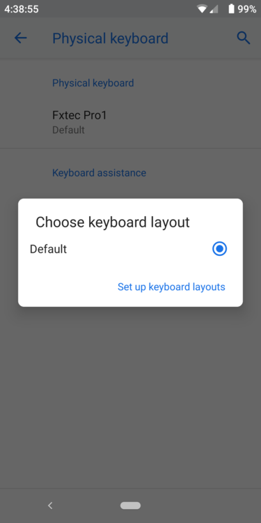

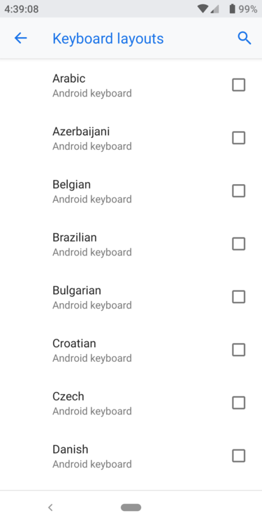

D1ggs 141 Posted February 10, 2020 Share Posted February 10, 2020 (edited) Sorry for not being specific. I wasn't happy with the FinQwerty layouts. In another post, someone had mentioned it's possible to restore functionality by disabling all of the keyboard layouts. Sounds counterintuitive, but if the keyboard input profiles are all blank (deselect all of the profiles and then hit the back arrow) the phone will go to "default". All of the keys, shift, and special characters will work. See my attached photos. There will be a notification prompt urging you to select a keyboard input profile. You can tell Android to silence it which is what I did by swiping it partially left or right. Hope this makes sense, I can be more specific if you need a step by step. Just let me know 😊 Edited February 10, 2020 by D1ggs 2 Quote Link to post Share on other sites
Craig 1,435 Posted February 10, 2020 Share Posted February 10, 2020 Shift will only work for capital letters in that case. Not for anything on the number row for example. 1 1 Quote Link to post Share on other sites

D1ggs 141 Posted February 10, 2020 Share Posted February 10, 2020 3 hours ago, Craig said: Shift will only work for capital letters in that case. Not for anything on the number row for example. Weird, when I press the yellow arrows ↗ on the bottom row in conjunction with the number keys, I get the special characters like @$^*^. I'm running the latest version of stock. Quote Link to post Share on other sites
Craig 1,435 Posted February 10, 2020 Share Posted February 10, 2020 5 minutes ago, D1ggs said: Weird, when I press the yellow arrows ↗ on the bottom row in conjunction with the number keys, I get the special characters like @$^*^. I'm running the latest version of stock. Not weird, that's the case for all qwerty devices with no layout selected on all the versions they've released (thru 2020-01-06). Quote Link to post Share on other sites
D1ggs 141 Posted February 10, 2020 Share Posted February 10, 2020 31 minutes ago, Craig said: Not weird, that's the case for all qwerty devices with no layout selected on all the versions they've released (thru 2020-01-06). Sorry Craig, I'm totally confused now. We want Shift to be the button that calls up special characters instead of the yellow arrow? If that's the case, then I'm just going to sit quietly in this corner. Just ignore me. My bad guys! 1 Quote Link to post Share on other sites
Craig 1,435 Posted February 10, 2020 Share Posted February 10, 2020 (edited) I don't know what "we" want. I was just referring to what happens the way it is now. Right now on qwerty with no layout selected, shift only works for capitol letters, it does not work for the rest of the second level keys, only those weird slanted arrow keys, sometimes referred to oem keys or Fn keys, do that. If I don't like any of the available layouts, I'd bug the finqwerty guy, he's fast to make changes if there's good reason, etc. Until OTA includes some useful layouts, anyway. But as to how I'd like it to work? Of course I'd like shift to work normally for 2nd level. I'd like the right slant arrow to act as slash key (and level 2 would be question mark). I'd like left slant arrow to be 3rd level modifier for us-international layout. I'd like all modifier keys to be sticky (including that left slant arrow). I do not want 3rd layer keys assigned to alt like I believe some finqwerty layouts use, as alt should be reserved for use as Alt. And in the kernel itself, I'd like Sym to be changed to right-alt (for symbol keyboard) and Fxtec key to be Meta (for global shortcuts). One other thing I'd like is Fx+number row to be F1-F12. But I understand if Fx key is assigned to meta as I want, only program shortcuts can be used, not keyboard shortcuts; so unless someone writes individual programs to send F1-F12, that won't work with the way Android is now. If I knew how to do that, I think it'd be worth the effort. I considered suggesting using the left slant-arrow, except then can't have standard us-intl 3rd level keys, and I do occasionally use ¹²£€ so don't want to mess with those. Perhaps the sym key can be used that way, dunno if thats possible or not, but I keep learning new things every day. I'm just looking forward to see what stock does with their next OTA and what LOS does when they get a little closer to release... If they'd just given us a slash key in the first place, the standard layouts would have worked fine, it seems really odd they chose to give us those two weird keys, and a whole bunch of less important (but standard) symbols, but not even include slash/question mark, keys used constantly (slash for urls and paths, question mark for regular English). Edited February 10, 2020 by Craig 1 Quote Link to post Share on other sites
