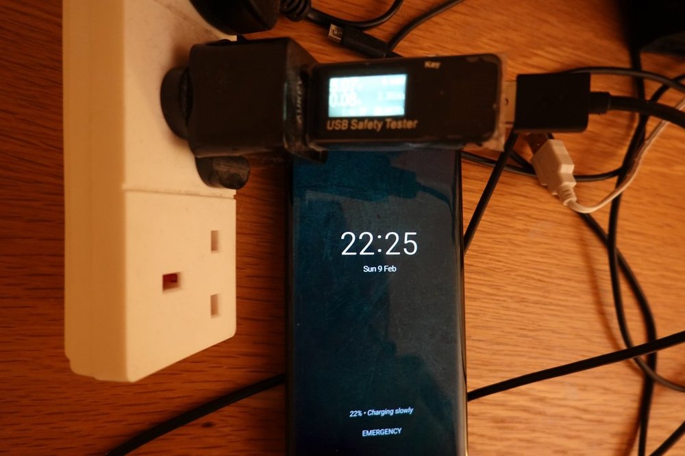

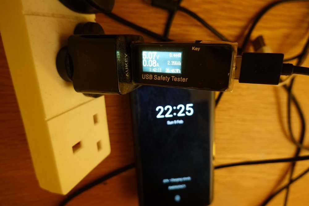

ncvb 5 Posted February 13, 2020 Share Posted February 13, 2020 On 2/10/2020 at 1:36 PM, ncvb said: Recently had an issue with charging, using two different Aukey chargers one with QC support, another without. Will post pictures later. Though I could not reproduce it every time, I managed to take photo's during one of the issue occurence. Phone was charging with 5.00V and 0.02-0.08A. On screen it appeared charging slowly, estimated time for full charge 1 day 17 hours. Battery was about 14%. Did not manage to reproduce using stock charger. This happened both on Aukey PA-U32 and PA-T16. If you disconnect and connect back, it may start charging quickly. 2 1 Quote Link to post Share on other sites
