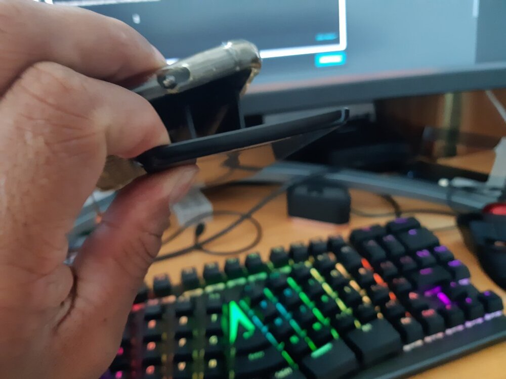

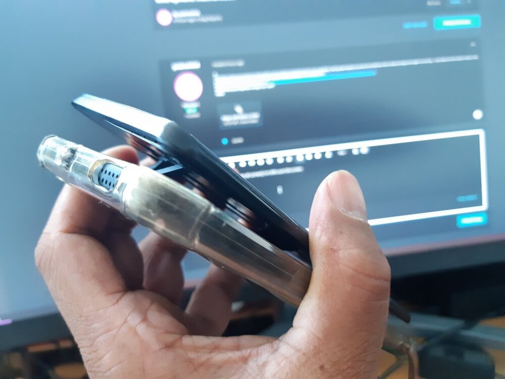

pedro4444 36 Posted June 10, 2021 Author Share Posted June 10, 2021 No.... it is ok.... My corners have everything ok. I tried pressing a and do not working... I wrote on support and sent photos for warranty now i waitnig on respond... On 6/8/2021 at 3:22 PM, DieBruine said: Check the corners and snap them back by pressing the screen to the back of the frame. Pretty sure that's your deal... Quote Link to post Share on other sites
