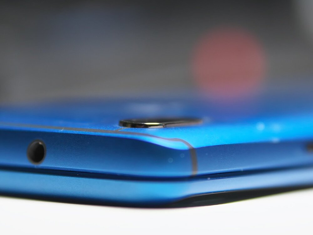

Mysti-Que2020 20 Posted August 21, 2022 Share Posted August 21, 2022 I've been messing around my with my pro 1x for the past 3 days and notice the camera on the back of the phone seem loose. When I apply pressure on the camera lens it slightly wiggles and makes a crunchy sound. Has anyone notice this problem on their units? 2 Quote Link to post Share on other sites
Rob. S. 1,667 Posted August 21, 2022 Share Posted August 21, 2022 (edited) My phone doesn't exhibit what you describe, but then again I think we can give you the all-clear there, because what you can touch on the back of the phone is not the camera itself, it is just a clear window over the camera, part of the phone's casing. The camera unit is fixed inside on the opposite plate, the one on top of which is the keyboard. Edited August 21, 2022 by Rob. S. 2 Quote Link to post Share on other sites
Mysti-Que2020 20 Posted August 21, 2022 Author Share Posted August 21, 2022 2 hours ago, Rob. S. said: My phone doesn't exhibit what you describe, but then again I think we can give you the all-clear there, because what you can touch on the back of the phone is not the camera itself, it is just a clear window over the camera, part of the phone's casing. The camera unit is fixed inside on the opposite plate, the one on top of which is the keyboard. Does your camera stick out a bit because mine isn't flushed and when I do apply pressure to it and goes in about 1-2 mm and makes that crunchy sound. Just want to check make sure it doesn't affect the camera in the future Quote Link to post Share on other sites
EskeRahn 5,596 Posted August 21, 2022 Share Posted August 21, 2022 1 hour ago, Mysti-Que2020 said: Does your camera stick out a bit because mine isn't flushed and when I do apply pressure to it and goes in about 1-2 mm and makes that crunchy sound. Just want to check make sure it doesn't affect the camera in the future The Pro1X camera do protrude about 0.8mm, which is more than on the Pro1, where it is less than what I can measure. 2 Quote Link to post Share on other sites
Rob. S. 1,667 Posted August 21, 2022 Share Posted August 21, 2022 It sticks out a bit, it just doesn't let itself be pushed inwards. If you could look at it from the inside, you would see it having a substantial margin with which it is glued to the frame. On your phone it would seem that the glue doesn't stick well. If I were you, I'd try to not fiddle with it, as to not let it become completely unglued. 1 Quote Link to post Share on other sites
Mysti-Que2020 20 Posted August 21, 2022 Author Share Posted August 21, 2022 1 hour ago, Rob. S. said: It sticks out a bit, it just doesn't let itself be pushed inwards. If you could look at it from the inside, you would see it having a substantial margin with which it is glued to the frame. On your phone it would seem that the glue doesn't stick well. If I were you, I'd try to not fiddle with it, as to not let it become completely unglued. I'm like a toddler, i now I shouldn't fiddle with it but I do anyway 🤣. But I'll will hold myself back and let it be 3 Quote Link to post Share on other sites
EskeRahn 5,596 Posted August 21, 2022 Share Posted August 21, 2022 3 hours ago, Rob. S. said: It sticks out a bit, it just doesn't let itself be pushed inwards. If you could look at it from the inside, you would see it having a substantial margin with which it is glued to the frame. On your phone it would seem that the glue doesn't stick well. If I were you, I'd try to not fiddle with it, as to not let it become completely unglued. Well the problem here is that it is sticking out, so very hard to not press it inadvertently. Every time you put it on a table (without a shell or case) it will get a slight bump, also using the keyboard placed at a table every key press, will press slightly on the camera... So I would strongly suggest all Pro1X users to consider using a case OR at the very least add some suitable strip of self-adhesive rubber, at the least 1-1½mm thick along the long or short edge towards the camera, (can be found for next to nothing on ebay, thou bot likely in blue), so that the rubber hits the table first (that will also prevent the Pro1X from wobbling slightly used on a table. e.g. https://www.ebay.ie/itm/403661273701 or clear https://www.ebay.ie/itm/325258934223 Clear silicone feet will have similar effect, e.g. https://www.ebay.ie/itm/203824798272 Quote Link to post Share on other sites

claude0001 1,424 Posted August 26, 2022 Share Posted August 26, 2022 On 8/21/2022 at 5:14 PM, EskeRahn said: The Pro1X camera do protrude about 0.8mm, which is more than on the Pro1, where it is less than what I can measure. The Pro1's camera window is actually sunken-in by a tiny amount, to protect it when the phone is put on a table for keyboard operation. I remember f(x)tec were quite proud they had achieved that in designing the back of the phone ... Quote Link to post Share on other sites
EskeRahn 5,596 Posted August 26, 2022 Share Posted August 26, 2022 1 hour ago, claude0001 said: The Pro1's camera window is actually sunken-in by a tiny amount, to protect it when the phone is put on a table for keyboard operation. I remember f(x)tec were quite proud they had achieved that in designing the back of the phone ... yup, and this is the only outer difference between the two models, The Pro1 is almost flush, the Pro1X protrudes slightly 1 Quote Link to post Share on other sites
