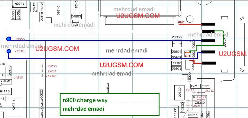

VaZso 1,999 Posted December 27, 2022 Share Posted December 27, 2022 As far as I know, usually N900 had its USB connector torn off. (That way smaller or larger part(s) of PCB traces are remain at connector side instead of the PCB, so it is also a question of luck.) That means it is usually not as simple as soldering any connectors back to the board but also USB lines should be found somewhere on the PCB. Basically it has GND, VCC, DATA- and DATA+ connections and if I remember well, it also used fifth connection to identify a proper charging cable. So to tell something valuable, one have to see the phone, especially its PCB and only may say something valuable then. ...and depending on luck, it can be repaired by somebody who knows what to do or may not... However, be aware if you give it to somebody for repair who does not know how to do it, it can easily result an unrepairable USB connector. I have seen such "repairs" where the guy destructed remaining PCB traces and also saw N900 what was repairable. 1 Quote Link to post Share on other sites

suicidal_orange 103 Posted December 28, 2022 Share Posted December 28, 2022 Assuming the pads are ripped off you need to follow the traces to find somewhere to solder to. If they end in holes they will continue on the other side so take a pic of both sides without moving the camera then flip one and make it semi-transparent in a graphics program (gimp is free). Or post the pics and I'll have a look 🙂 1 Quote Link to post Share on other sites
VaZso 1,999 Posted December 28, 2022 Share Posted December 28, 2022 1 hour ago, suicidal_orange said: If they end in holes they will continue on the other side so take a pic of both sides However, I would think N900 also had a multi-layer PCB, so a photo of both sides may, or may not help... 1 Quote Link to post Share on other sites
CornholioGSM 370 Posted December 28, 2022 Share Posted December 28, 2022 Rapair missing pads/ways is simple on n900. ...always is better to use new usb connector...old one have have loose soo solder back old one is repair for short time. 5 Quote Link to post Share on other sites
