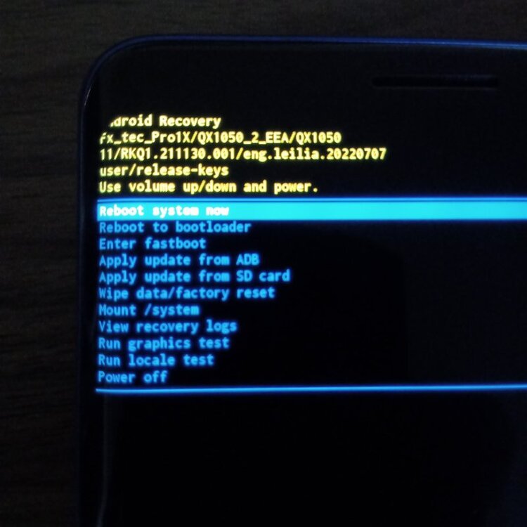

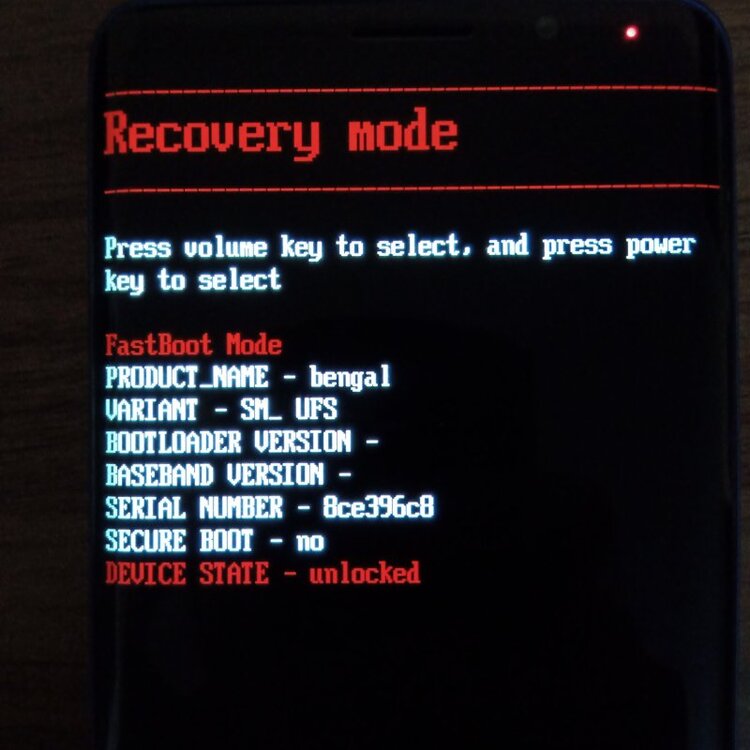

kevg 14 Posted January 26, 2023 Share Posted January 26, 2023 I just got a new Pro1-X and I'm following the rooting with Magisk document: https://community.fxtec.com/topic/3690-pro1-x-rooting-with-magisk/ Everything works up to step 11 of the "Root Pro1-X via Magisk" section. I have magisk_patched-25200_HsxJg.img locally downloaded from step 10. Next, in step 11, I run adb reboot bootloader. It restarts to the attached image (IMG_20230125_213340_947.jpg). If I try to run fastboot flash boot magisk_patched-25200_HsxJg.img, I just get the following: $ fastboot flash boot magisk_patched-25200_HsxJg.img < waiting for any device > So then I tried scrolling to Recovery mode, and pressing power. That then restarts to the "No command" screen (IMG_20230125_213942_773.jpg). I get the same "waiting for any device" output if I try the fastboot flash command here. I found elsewhere that from this screen, I can hold the power button and press the volume up key and then release both and I see the Android recovery screen (IMG_20230125_214520_909.jpg). I get the same "waiting for any device" output if I try the fastboot flash command here. Then I scroll down to Enter fastboot and press power to enter that. But I get the same "waiting for any device" output if I try the fastboot flash command here. If I go back to recovery mode, and instead go to Apply update from ADB, I then see the following from adb devices, but I still can't run fastboot flash. $ adb devices List of devices attached 8ce396c8 sideload How do I run fastboot flash? Quote Link to post Share on other sites
EskeRahn 5,604 Posted January 26, 2023 Share Posted January 26, 2023 There is a difference between "Enter Fastboot" and "Reboot to boatloader". I'm pretty sure you want the second Quote Link to post Share on other sites
Casey 321 Posted January 26, 2023 Share Posted January 26, 2023 7 hours ago, kevg said: $ fastboot flash boot magisk_patched-25200_HsxJg.img < waiting for any device > If you're using a Windows computer, try installing the Qualcomm driver. It might be due to your computer is unable to recognise your Pro1-X under bootloader mode. I'd also suggest trying out a different USB-C cable. Quote Link to post Share on other sites
kevg 14 Posted January 26, 2023 Author Share Posted January 26, 2023 9 hours ago, EskeRahn said: There is a difference between "Enter Fastboot" and "Reboot to boatloader". I'm pretty sure you want the second Choosing reboot to bootloader just takes me back to the first screenshot. Do I choose something other than Recovery mode there? Quote Link to post Share on other sites

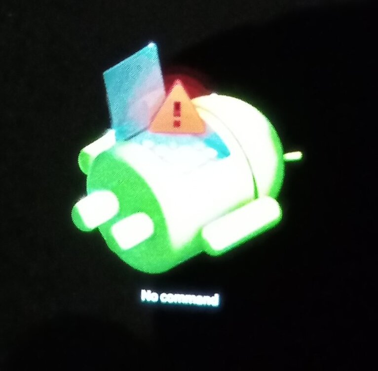

kevg 14 Posted January 28, 2023 Author Share Posted January 28, 2023 (edited) I bought a Raspberry Pi 3 B and microSD, installed Raspbian, installed adb and fastboot, connected to phone (normal boot), authorized the Pi, ran adb reboot bootloader, entered recovery mode, phone goes to "No command" screen, but then I get a popup on my Raspberry Pi desktop that says: Unable to open MTP device "001,013" Clicked OK and ran adb devices, and I'm back to the "unauthorized" status and adb and fastboot don't work. Tried this in the Raspberry Pi as both a normal user and root (with adb kill-server in between). Tried with another USB C cable and got a similar error, although it ended with "001,016". Any ideas? Edited January 28, 2023 by kevg Quote Link to post Share on other sites
Hook 3,364 Posted January 28, 2023 Share Posted January 28, 2023 I'm a little confused by your descriptions. When you reboot to bootloader using adb, you should get the bootloader screen which is the same as your first screen shot way above except I think it says "START" in green at the top. I don't think it matters if you use the volume control to change what is at the top to "RECOVERY mode" because those are options you are scrolling through, but nothing changes unless you press power. That bootloader screen (with "START" or whatever at the top) is the bootloader. That is where fastboot is used. Going into recovery mode (by pressing the power button) doesn't help you here. This is where you have to figure out why fastboot isn't working. Sorry, this is an attempt at clarifying, but it doesn't help that fastboot is not working for you on that screen. And, so far, I'm not seeing anything obvious after trying different cables, different OSs, different ports. I'm hoping someone else will be more helpful. I assume you have enabled "developer options" on the phone and USB debugging is on and on first connect to a new computer you authorize the debugging connection on the phone on the popup that occurs when you do "ADB devices." These are all early steps in the instructions so I'm assuming everything went fine there. 1 Quote Link to post Share on other sites
claude0001 1,424 Posted January 28, 2023 Share Posted January 28, 2023 I agree with @Hook. That screen in the first screenshot should be shown while you use fastboot to flash the boot.img. adb, on the other hand, does its job only from recovery, not from that bootloader screen. That said, just flashing the Magisk-patched boot.img (which I understand is what you are trying to achieve) does not require any action to be performed from recovery. You should not go there at all for this. The no-command-screen usually indicates that the recovery image fails to boot. It normally should not be shown at any step of a reflashing procedure, and probably indicates that something has gone wrong in your flashing attemps. 2 Quote Link to post Share on other sites
kevg 14 Posted January 28, 2023 Author Share Posted January 28, 2023 Ahh, that's it, thank you! I ran fastboot right on the "START" screen and it worked. Even worked on my X270 without needing to boot up the Raspberry Pi. 2 Quote Link to post Share on other sites
