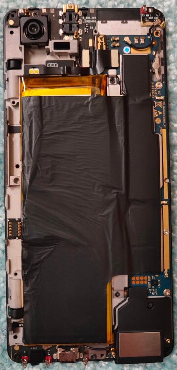

david 929 Posted September 21, 2024 Share Posted September 21, 2024 (edited) On 8/14/2024 at 6:05 AM, FlyingAntero said: Edit: Pro1 and Pro1-X are more different than I first thought so you cannot swap parts that easily. Differences identified so far: ... Screen panel with the frame Same screen panel and frame but the selfie camera different (source) The screen flex cable on my Pro1X went bad (and no response from [email protected] about a replacement). I am using the flex cable from my Pro1. The screen works, but the GCam and snapdragon camera apps crash whenever I run it. My assumption is it can't communicate with the selfie camera through the cable for some reason (missing/different wire paths), even though the cable plugs into the ports on each end successfully. I am able to use Open Camera, but there is no way to take a selfie with it. I am guessing it is gracefully failing to communicate with the selfie camera. Open Camera, with this phone, doesn't take nearly as good pictures as the GCam app does. It also freezes the camera view if you try zooming in. I don't know if that is due to the cable issue or just a bug in Open Camera with this camera hardware. Edited September 21, 2024 by david 1 1 Quote Link to post Share on other sites
