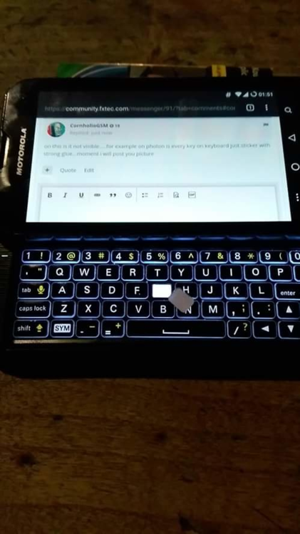

Craig 1,435 Posted January 16, 2020 Share Posted January 16, 2020 (edited) Photon Q used stickers by default, I didn't even realize until Cornholio pointed it out, they are very well done and very well adhered. It would certainly help with custom keyboard maps, for example finqwerty-us-intl on on qwertz cuz otherwise hard to remember where the non-letter keys are mapped to. It might also allow us to print 3rd level characters from us-intl on the keys to remember those symbols too. The problem I see is even if we get perfectly made stickers, putting them on straight on every single key will be a challenge and time consuming! That and the backlight issue already mentioned. Edited January 16, 2020 by Craig 2 1 Quote Link to post Share on other sites
EskeRahn 5,596 Posted January 16, 2020 Share Posted January 16, 2020 18 minutes ago, Craig said: The problem I see is even if we get perfectly made stickers, putting them on straight on every single key will be a challenge and time consuming! That and the backlight issue already mentioned. Well I guess the best thing would be a transparent ark with mild adhesive on the print size (think like a large piece of writing tape) with some guide-marks, so all labels can be applied in one go, and in parallel. And then most likely one by one should be pressed firm in place by the heat of a finger. As the keys are not flat-topped, labels are not easy, but perhaps some suitable flexible material, that gets shapeable by the heat of a finger, can do the trick. 1 Quote Link to post Share on other sites

Craig 1,435 Posted January 16, 2020 Share Posted January 16, 2020 Maybe there is a chemical process that works better than scraping. Like remove the keyboard and soak it in (something) then they just wipe off with a towel... 1 Quote Link to post Share on other sites

SchattengestaIt 563 Posted January 16, 2020 Share Posted January 16, 2020 38 minutes ago, EskeRahn said: Well I guess the best thing would be a transparent ark with mild adhesive on the print size (think like a large piece of writing tape) with some guide-marks, so all labels can be applied in one go, and in parallel. And then most likely one by one should be pressed firm in place by the heat of a finger. As the keys are not flat-topped, labels are not easy, but perhaps some suitable flexible material, that gets shapeable by the heat of a finger, can do the trick. Those things exist for cars and guide marks aren't even needed. It's the stickers with two covers, one of them being transparent to align them. But I wonder if it isn't enough to just change a handful of keys? Or are we trying to shift a non-shifted keyboard? 1 Quote Link to post Share on other sites

EskeRahn 5,596 Posted January 22, 2020 Share Posted January 22, 2020 8 hours ago, jlavi said: I have ordered QWERTZ model and will need to cover 5 keys to achieve Finnish layout: Y, Z, ẞ, Ü, and +. I could try black laptop key stickers for Finnish layout and then trim them to fit Pro1 keys. Note that the keys are not flat, so it must be some elastic foil to get a good fit. And the labels for a laptop would most likely need to be cropped into the letters to fit on the key. So I would hunt for something for some smaller devices. Quote Link to post Share on other sites
