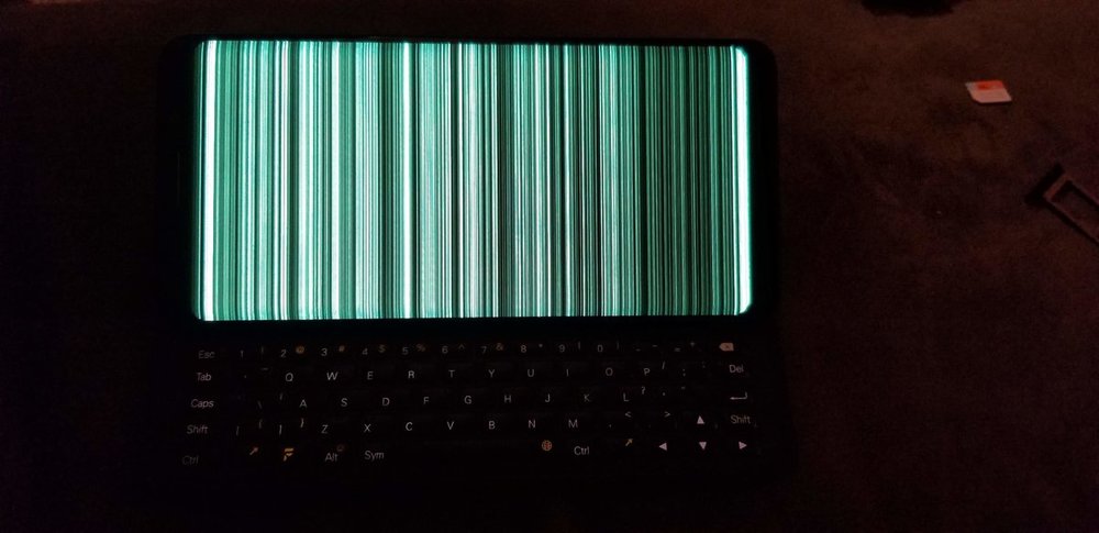

kBPkH4r2VcQXmOX9PBq3 3 Posted January 28, 2020 Share Posted January 28, 2020 Well it seems my unit has a defective screen. All I see are horizontal green lines or green "static". Has anyone else had this issue? I already submitted a ticket to support so I'll see what they say. I am disappointed to say the least. I really hope they set aside a few devices for replacements... 6 Quote Link to post Share on other sites

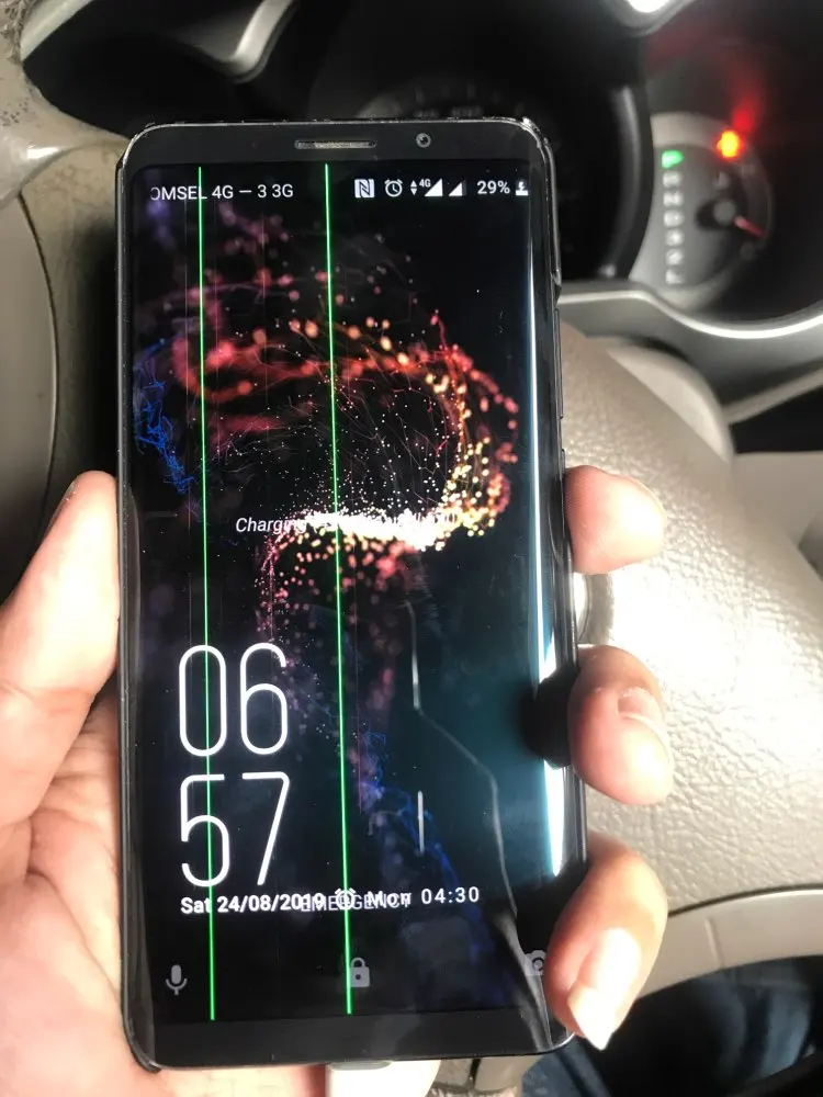

david 929 Posted January 28, 2020 Share Posted January 28, 2020 There have been some people who have purchased replacement screens for the Elephone U/U Pro (which is the same screen the Pro1 uses) from chinese suppliers and had issues with green lines (or other colored lines in some cases). It didn't look exactly like your situation, but is related, so I'm posting for added info. 2 Quote Link to post Share on other sites

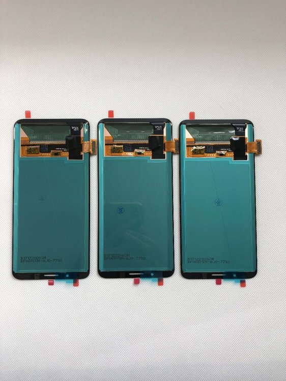

EskeRahn 5,595 Posted January 28, 2020 Share Posted January 28, 2020 7 hours ago, david said: There have been some people who have purchased replacement screens for the Elephone U/U Pro (which is the same screen the Pro1 uses) from chinese suppliers and had issues with green lines (or other colored lines in some cases). It didn't look exactly like your situation, but is related, so I'm posting for added info. Unfortunately we do not know if those bugs are relate to defective display OR they require some special caution when installing a display that just MIGHT not have been known to the one replacing the display. Of course optimally neither of those happened, but just saying that we d not know (yet?)I also saw in a aliexpress listing that the display exists with the same primary number in (at the least) three versions that looks slightly different at the back. EDIT: Reflection of a phone used for images Quote Link to post Share on other sites
david 929 Posted January 28, 2020 Share Posted January 28, 2020 What is different between those 3? I didn't spend too long looking, but I didn't spot it. And agreed about not knowing if it was the installation or the screen itself, but there is something about the variables involved that did result in issues with lines. Quote Link to post Share on other sites
EskeRahn 5,595 Posted January 28, 2020 Share Posted January 28, 2020 7 hours ago, david said: What is different between those 3? I didn't spend too long looking, but I didn't spot it. The image shows then ordered by the number in he first line, could be serial could be variant number. The second looks like there is something slightly thicker in the lower left quarter. And If they changed to that and back, I guess there might be other differences too. The first and third I can not spot either, except the way the foil folds around the components - but the last could be specimen variation, and mean nothing EDIT: I was wrong. Reflection of a phone used for images Quote Link to post Share on other sites
david 929 Posted January 28, 2020 Share Posted January 28, 2020 3 hours ago, EskeRahn said: The image shows then ordered by the number in he first line, could be serial could be variant number. I saw the top numbers were different, but I just assumed that was the serial number. 3 hours ago, EskeRahn said: The second looks like there is something slightly thicker in the lower left quarter. And If they changed to that and back, I guess there might be other differences too. The first and third I can not spot either, except the way the foil folds around the components - but the last could be specimen variation, and mean nothing Are you sure it isn't the reflection of the hand and camera of the person taking the picture that you are seeing? When I looked at it further away at first, I thought it was bulged too, but then I zoomed in. I thought maybe the foil differences were just the light hitting them differently. They seem to have the same shapes under them. And like you said, the foil could have just been pressed differently, even if what is under them is identical. 1 Quote Link to post Share on other sites
EskeRahn 5,595 Posted January 28, 2020 Share Posted January 28, 2020 3 hours ago, david said: Are you sure it isn't the reflection of the hand and camera of the person taking the picture that you are seeing? Oh you are right, we can actually see the fingers also holding a mobile. Would never have imagined they did not use a real camera 🤣 2 Quote Link to post Share on other sites

kBPkH4r2VcQXmOX9PBq3 3 Posted January 29, 2020 Author Share Posted January 29, 2020 19 hours ago, Noir said: Any influence on the display when opening/closing the pro1 slowly and turning the display off and on on different opening levels? It´s mandatory to turn off the display and reawake the phone after each movement of the slider. Maybe you´ll get a working image doing that to troubleshoot the flex cable, it´s connection, or the screen itself.. Thanks for the suggestion. I tried turning on/off the phone at various positions between opened and closed and it did not make a difference. Perhaps it is the ribbon cable, but I'm not going to mess with trying to take it apart and test. I'll wait for support to get back with me. 3 Quote Link to post Share on other sites
Spider-Dan 25 Posted March 2, 2021 Share Posted March 2, 2021 On 1/29/2020 at 7:47 AM, kBPkH4r2VcQXmOX9PBq3 said: Thanks for the suggestion. I tried turning on/off the phone at various positions between opened and closed and it did not make a difference. Perhaps it is the ribbon cable, but I'm not going to mess with trying to take it apart and test. I'll wait for support to get back with me. Any update on this issue? I'm now having the same problem. Quote Link to post Share on other sites
