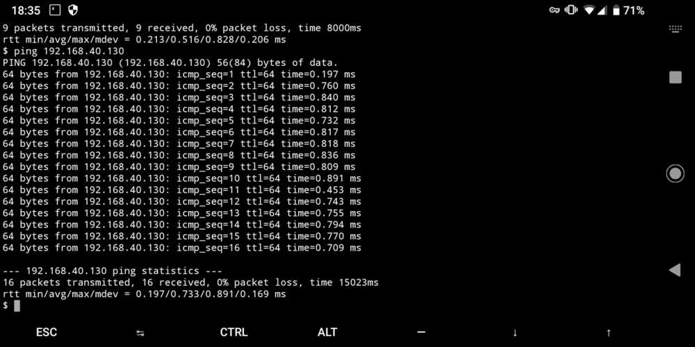

david 929 Posted January 30, 2020 Author Share Posted January 30, 2020 I did the same test with localhost. It is something within the network stack that is slowing down when it is accessing outside the phone. I even set my old phone as a hotspot and got the same results. However, if I set the Pro1 as a hotspot and connect to it from my old phone, I get *under* 1 ms pings, consistently. I downloaded a couple ping apps and they get the same results pinging the wireless access point. For those of you who are getting fast pings reported in speed test apps, who are on fiber, can you try pinging google.com or some other known endpoint on the internet? Preferably close to you. When I do that, I get about 20+ more ms on the Pro1 than on my old phone, due to this extra time to get to the router over wifi. Quote Link to post Share on other sites

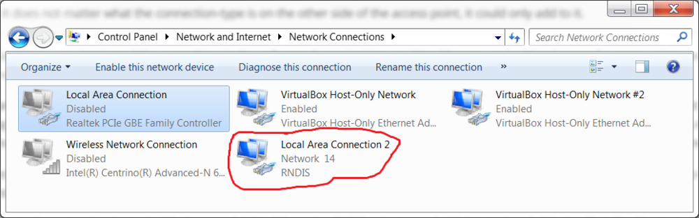

david 929 Posted January 30, 2020 Author Share Posted January 30, 2020 (edited) 17 minutes ago, EskeRahn said: Please read above, Pinging the ACCESS POINT from Termux gives the same about 20ms results So it does not matter what the connection-type is on the other side of the access point, it could only add to it. Well, in theory, yes, but it could be something in the software that is looking at LAN addresses and adding latency for some unknown reason. That was the only reason for asking for that test. I did another test. I plugged the phone into my laptop and enabled USB Tethering. I then pinged the phone from the laptop and got 1-5 ms times. I pinged the laptop from the phone and got the same. So the network stack by itself is not wholly doing this. And the terminal application is not doing this. The common variables seem to be wifi to an address outside the phone. I have tried 2.4 and 5.8 ghz wifi and both exhibit the same latency issue. If anyone else wants to test USB Tethering, you have to go into USB Preferences and pick "USB tethering" once you are connected to the computer. The easiest way to find the IP address of both sides is to either: A) Go into the network adapter in Windows and right click on the RNDIS adapter and pick "status" and click the "Details..." button. This will give you the ipv4 address of something like 192.168.42.x. It will also give you the phone's ip address on this tethered network as the IPv4 Default Gateway, which again will be a 192.168.42.x address, I'm guessing. 42 is the subnet it has been consistently using for me anyway. NOTE: To get to the network adapter screen, in Windows 7, go to the start menu, type in "network connections". Pick "View Network Connections" from the list. You will get something like this: When you right click on that and pick Status or double click on it, you will get this: After clicking on Details..., you will get this: or B) Go into a command window and type "ipconfig /all". Find the RNDIS entry and it will have the same information as option (A) above. Edited January 30, 2020 by david Quote Link to post Share on other sites

david 929 Posted January 30, 2020 Author Share Posted January 30, 2020 More testing... Just in case it was only a problem with ICMP (the protocol ping uses), I found a way to test TCP latency. By using the app PingTools Network Utilities, and changing the Ping feature's settings to use TCP, I get the same results -- 20+ ms typical latency (TCP pinging port 80 on my router). It also has an option to test with HTTP, which gives slightly higher latency. Testing over the USB tethered network to my laptop gives the normal, low latency pings again (using the TCP test in PingTools). The main reason why all of this is important is because if there is added latency, web pages will load slower than they otherwise could. Unlike a file download, where 20 ms won't matter, a web page with 100 objects (the average, modern web page has over 100 objects to download, each though a separate request) will take 2+ seconds longer to load with that added 20+ ms latency on top. If the delay to the router is only 5 ms, then the added delay is only half a second. To be clear, this is *added* delay, on top of the latency introduced by the hops to the internet server in question. So if the latency from the router to the website is 30 ms, then a web page could take a total of 5 seconds to load with 20 ms to from the phone to the router, instead of 3.5 seconds with 5 ms from the phone to the router. It isn't the end of the world, but if this can be fixed, it will just make web pages feel more snappy on the Pro1. Oh, and for those people who are into interactive games, the latency may have an effect on how the game perceives their response time. Quote Link to post Share on other sites
