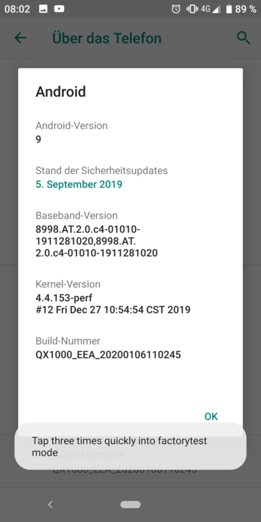

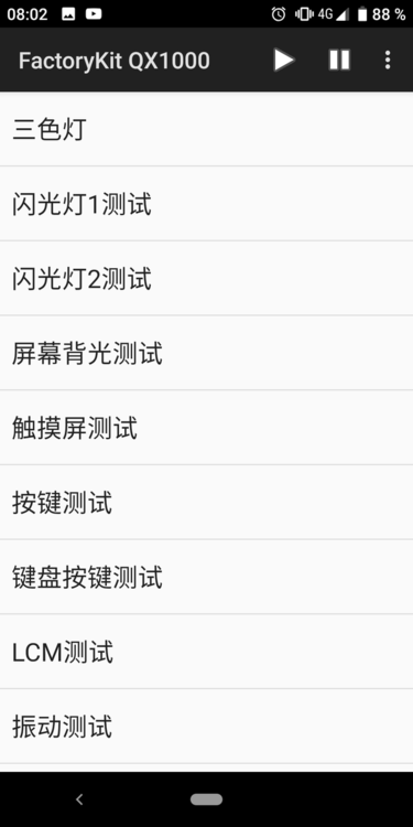

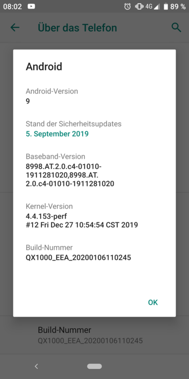

Nighplyer32 38 Posted February 14, 2020 Share Posted February 14, 2020 I found the factory test mode. It can be used to test all functions to determine whether the cell phone is working or not. You can test eg Screen, Backlight, Touch, Sensors, Flashlight, camera... And more !!!! But be careful there is an emergency call test !!!!!! To get there you go into the settings, about the phone and there click on the Android 9 button then a popup window appears. If you now click on the build number you get a toast message that you should click 3 times quickly. Then the factory tool opens. It is all in Chinese but if you go into the menus it is quite self-explanatory 4 Quote Link to post Share on other sites

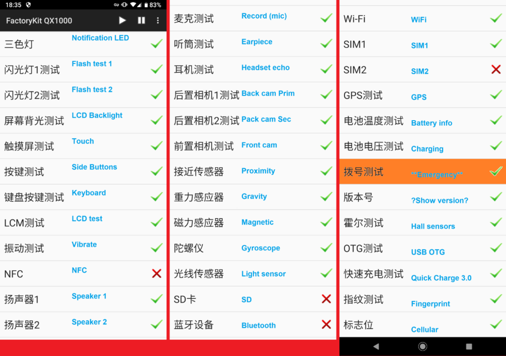

EskeRahn 5,608 Posted February 14, 2020 Share Posted February 14, 2020 2 hours ago, Nighplyer32 said: I found the factory test mode. It can be used to test all functions to determine whether the cell phone is working or not. You can test eg Screen, Backlight, Touch, Sensors, Flashlight, camera... And more !!!! But be careful there is an emergency call test !!!!!! That is the four glyphs long one no three after the GPS (after the battery and charger). It gives NO warning, but calls directly on click!!! "Hall_a" is in keyboard half close to camera button,"Hall_b" is in the display half, slightly above the volume rocker (ssn in portrait). I guess it is intended to detect a Flip-case closed! 5 Quote Link to post Share on other sites
EskeRahn 5,608 Posted February 14, 2020 Share Posted February 14, 2020 ...For those that want a short-cut, it is available as an activity also, that can be launched by some launchers directly, or by tools creating a short-cut for 'any' launcher. 1 4 Quote Link to post Share on other sites

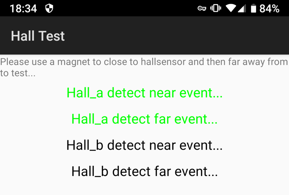

anonim001 105 Posted February 16, 2020 Share Posted February 16, 2020 (edited) On 2/15/2020 at 2:51 PM, divstar said: You are my hero, @EskeRahn. I don't knoe what's wrong with it, but my display kept going to landscape. I turned auto-rotation off, but it still did. Turning off auto-landscape in Slider did the trick. Now whenever I type using the physical keyboard, I just rotate it manually (which is fine by me). Does everything else work fine? I think You may have the same problem I do - my phone kept switching to landscape mode until I switched off autorotation when hwkb open (slider section in settings). It's probably due to some hardware problem with the "hwkb open" sensor - at the beginning mine stopped switching back to portrait, then started to switch to landscape all by itself when lying on the desk untouched, then was permanently stuck in landscape until factory reset, which got it stuck in portrait. All problems were kinda resolved by turning the rotation with hwkb off, but then the swkb keeps popping up always when writing. I'm going to send my on a guarantee repair (it's waiting for it since beginning of January, but there were more important things in my private life) next week. Edit: @EskeRahn could You show what what should the test look like? I run the test, but nothing happens when I flip the keyboard back and forth. Edited February 16, 2020 by anonim001 Quote Link to post Share on other sites
EskeRahn 5,608 Posted February 16, 2020 Share Posted February 16, 2020 1 hour ago, anonim001 said: Edit: @EskeRahn could You show what what should the test look like? I run the test, but nothing happens when I flip the keyboard back and forth. The lines goes green when it see a change. That is line two light op after first opening-event, and line one after first closing-event If you do not see this you most likely have a hardware error. If you do see this, what you report is most likely a software issue. Quote Link to post Share on other sites
EskeRahn 5,608 Posted February 16, 2020 Share Posted February 16, 2020 Here a (collage) version with my descriptions (and colouring) added. 6 Quote Link to post Share on other sites
anonim001 105 Posted February 16, 2020 Share Posted February 16, 2020 Nothing happens for me - both lines remain black after opening and closing, I tried a few times 😞 the backlight of the keyboard also does not turn on after opening. That would confirm the hardware issue I guess... I wanted to give it last chance and did a factory reset once again, but still nothing. I have just packed it with a ton of bubble wrap, small carton box and stretch foil, next week I'll try to send it back (I just started new job a 2 weeks ago, still moving to a different city so not much spare time to go to the post office...) 1 Quote Link to post Share on other sites

EskeRahn 5,608 Posted November 19, 2021 Share Posted November 19, 2021 On 2/14/2020 at 11:37 AM, EskeRahn said: "Hall_a" is in keyboard half close to camera button,"Hall_b" is in the display half, slightly above the volume rocker (ssn in portrait). I guess it is intended to detect a Flip-case closed! Show this at 100% (Portrait, USB down), and the magnet for the open&close detection is below the arrow about a third down between the display bottom and device bottom. (And thus obviously the hall sensor beneath it in the lower part when closed) Quote Link to post Share on other sites
