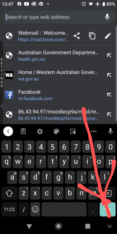

Shilor 71 Posted April 16, 2020 Share Posted April 16, 2020 (edited) On 4/13/2020 at 5:59 PM, Craig said: Sounds like you have a warranty issue. But as a workaround you could use a rotation control app to force portrait when needed. I am not sure.It might be a Hardware issue, but it might be a Software error. A reset might fix it, but I don't want to go through all the trouble of resetting my phone right now. It nothing helps, I have to do that - or just live with the current state. Here is what I tried so far: I found a setting in the preferences under "Slider" called "Landscape orientation Lock" which was activated and I disabled it. (see Picture 1) This worked fine for a while. ------------------ But now my problem is reversed and the virtual keyboard is ALWAYS displayed. It doesn't matter if I turn the setting "Show Virtual Keyboard if physical Keyboard is active" on or off. (see Picture 2) At the moment, using the Pro1 feels like driving an old beat-down car.. It kind of has its own life and you are always afraid it's gonna break down 🙄 (and like an old beat-down car.. I don't want any other than that... I want to keep my Pro1 😉 ) And in4b someone asks, I tried to switch it on and off again..and multiple reboots. nothing did help so far. 🥺PS: If it is important to know: I have a QWERTY slider and use the US layout (via FinQwerty). Android is set to the German language. Edge Null is active as well. Edited April 16, 2020 by Shilor formating the text and spelling. Quote Link to post Share on other sites
anonim001 105 Posted April 17, 2020 Share Posted April 17, 2020 On 4/16/2020 at 12:06 PM, Shilor said: I am not sure.It might be a Hardware issue, but it might be a Software error. A reset might fix it, but I don't want to go through all the trouble of resetting my phone right now. It nothing helps, I have to do that - or just live with the current state. Here is what I tried so far: I found a setting in the preferences under "Slider" called "Landscape orientation Lock" which was activated and I disabled it. (see Picture 1) This worked fine for a while. ------------------ But now my problem is reversed and the virtual keyboard is ALWAYS displayed. It doesn't matter if I turn the setting "Show Virtual Keyboard if physical Keyboard is active" on or off. (see Picture 2) At the moment, using the Pro1 feels like driving an old beat-down car.. It kind of has its own life and you are always afraid it's gonna break down 🙄 (and like an old beat-down car.. I don't want any other than that... I want to keep my Pro1 😉 ) And in4b someone asks, I tried to switch it on and off again..and multiple reboots. nothing did help so far. 🥺PS: If it is important to know: I have a QWERTY slider and use the US layout (via FinQwerty). Android is set to the German language. Edge Null is active as well. I had exactly the same thing - run the hall sensor diagnostics and You will know if the problem is software or hardware, but looks like a hardware issue to me. You can try to push the housing here and there or gently twist the device back and forth, it worked for me for 1 day before becoming completely unresponsive to open/close. Too bad they don't have any replacements on stock, so if You send Yours on warranty You'll end up being without a phone for... who knows how long, I'm already waiting almost 2 months and something tells me there are a few more weeks to go... 1 1 Quote Link to post Share on other sites
