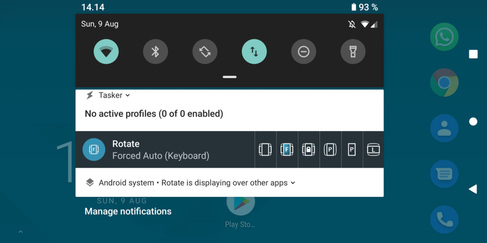

OKSun 103 Posted August 9, 2020 Author Share Posted August 9, 2020 On 7/2/2020 at 12:53 PM, FlyingAntero said: Forcing applications to landscape Not all applications, such as Instagram, support landscape mode, even if "Landscape Orientation lock" is selected in the Slider settings. However, applications can be forced horizontally with Ultimate Rotation Control (URC, paid) and Lock Screen Rotation (LSR, free). URC in Forced Auto mode and CSR in Lock Landscape mode places screen to landscape with the keyboard in the open position and portrait in the closed position. If you want to rotate the screen while the keyboard is closed, you must do it manually or turn off the application. FlyingAntero thanks again for your great input above. Ultimate rotation control: I have been using this app in the past with other keyboard phones. I liked that the various icons (auto, forced auto, landscape, etc) were displayed in the dropdown menu from the top of the screen (for notifications and quick settings). In pro1 I do not have these icons and do not manage to make them appear. Did I miss a setting? Quote Link to post Share on other sites
FlyingAntero 871 Posted August 9, 2020 Share Posted August 9, 2020 1 hour ago, OKSun said: FlyingAntero thanks again for your great input above. Ultimate rotation control: I have been using this app in the past with other keyboard phones. I liked that the various icons (auto, forced auto, landscape, etc) were displayed in the dropdown menu from the top of the screen (for notifications and quick settings). In pro1 I do not have these icons and do not manage to make them appear. Did I miss a setting? I have the icons there but I haven't changed any settings. They were there from the start. However, I do not use them because they seem to work oddly when the Landscape orientation lock is enabled from the stock settings. 1 1 Quote Link to post Share on other sites
OKSun 103 Posted August 9, 2020 Author Share Posted August 9, 2020 (edited) 4 hours ago, FlyingAntero said: I have the icons there but I haven't changed any settings. They were there from the start. However, I do not use them because they seem to work oddly when the Landscape orientation lock is enabled from the stock settings. Thanks. I cleared the cache and data. Icons are now there in the dropdown menu. clearing cache and data is becoming the standard procedure for all problems. Edited August 9, 2020 by OKSun 1 Quote Link to post Share on other sites
