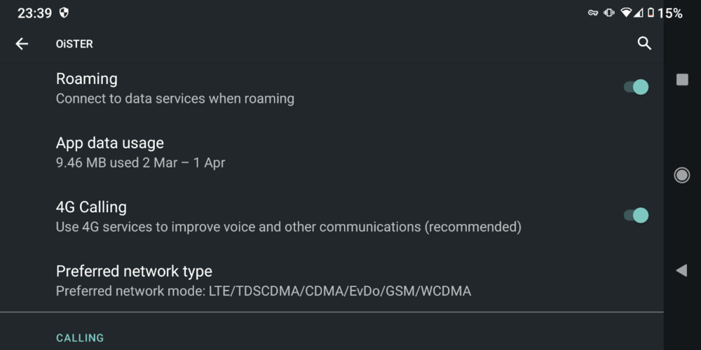

Rob. S. 1,667 Posted March 22, 2021 Share Posted March 22, 2021 (edited) Looks like the suspicion I wrote about earlier was correct. Since I disabled "4G calling" (HD voice aka wideband audio) in "Network and Internet" -> "Mobile Network", I didn't get any calls anymore with too loud in-call audio. I'm quite confident about this now as one specific caller which always used to be too loud when calling from his home line wasn't too loud anymore after I made that change. So far I don't see any disadvantages of that change, either. [Edit:] This is LineageOS 17.1. Sorry I didn't mention this earlier... Edited March 23, 2021 by Rob. S. 1 5 Quote Link to post Share on other sites

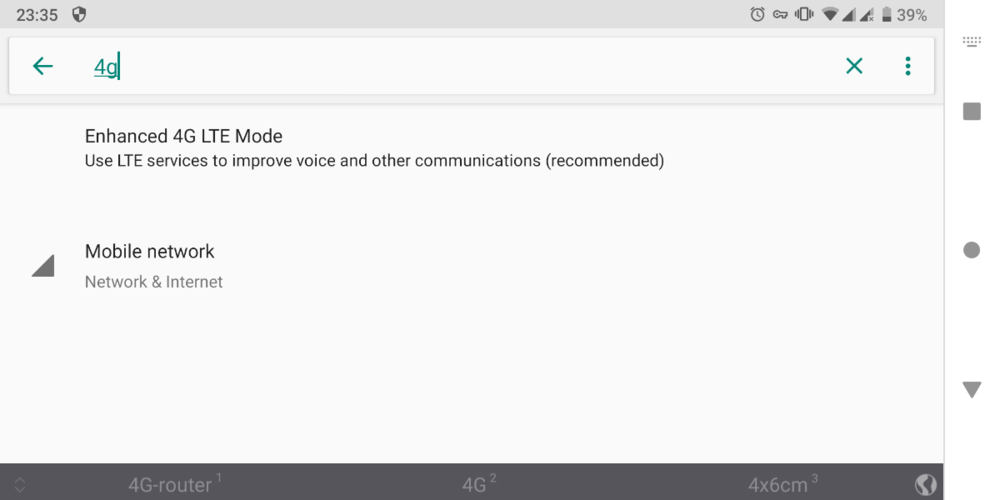

EskeRahn 5,596 Posted March 23, 2021 Share Posted March 23, 2021 If you in stock settings do a search for 4G, it suggests an option. BUT clicking that option does not bring me to that setting, as my carrier does not Support VoLTE for the Pro1 . (If I do the same on AICP, it IS available to me) Quote Link to post Share on other sites

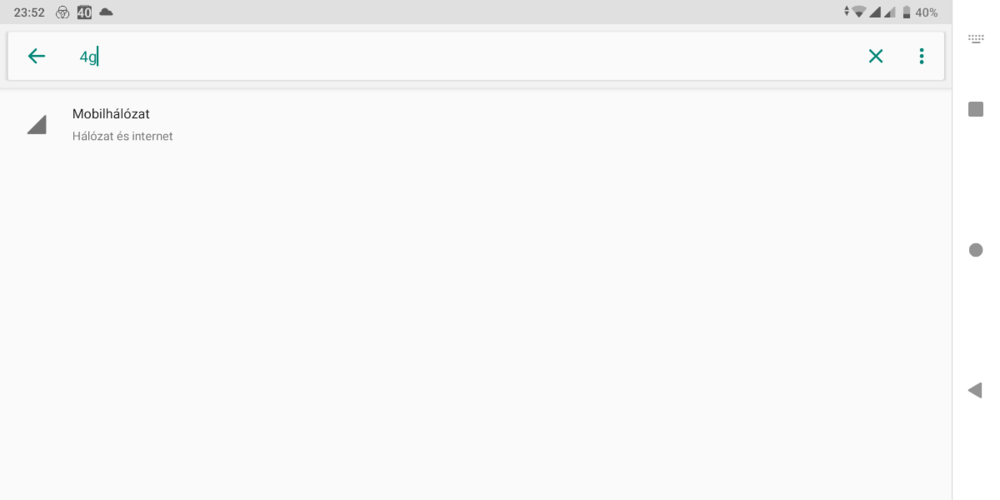

VaZso 1,999 Posted March 23, 2021 Share Posted March 23, 2021 10 minutes ago, EskeRahn said: If you in stock settings do a search for 4G, it suggests an option. BUT clicking that option does not bring me to that setting, as my carrier does not Support VoLTE for the Pro1 Interesting... I don't even have this ghost option: However, one of my carriers has VoLTE (and VoWiFi) support and it is turned on (however, I don't know if they have a whitelist), the other one still does not support it. Quote Link to post Share on other sites
EskeRahn 5,596 Posted March 23, 2021 Share Posted March 23, 2021 5 minutes ago, VaZso said: Interesting... I don't even have this ghost option: How odd, does this also go if you type LTE? It could be some national translation playing you a trick. Quote Link to post Share on other sites
VaZso 1,999 Posted March 23, 2021 Share Posted March 23, 2021 17 minutes ago, EskeRahn said: How odd, does this also go if you type LTE? It could be some national translation playing you a trick. Yes, I have tried that. 1 Quote Link to post Share on other sites
