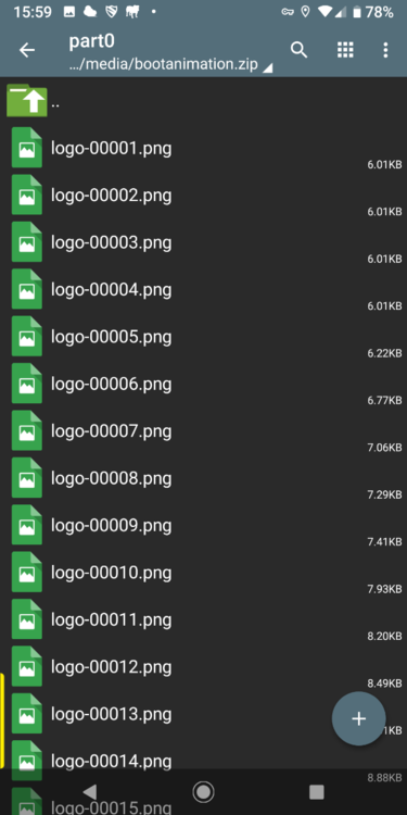

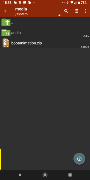

MickH 211 Posted June 20, 2021 Share Posted June 20, 2021 While poking around with ZArchiver app I found the FX boot logo animation. 🤔 Each frame is a .PNG image. Thinking back to the N900 days, would it be possible to replace the animation with one of our own? It probably won't work with a video file, but if we create animations in .PNG format it may work. Anyone brave enough to try?😛 4 1 Quote Link to post Share on other sites
CornholioGSM 268 Posted June 20, 2021 Share Posted June 20, 2021 (edited) ...yesss you can replace it 🙂 just create bootanimation.zip , set permission to rw-r-r and reboot 🙂  ...here are some from xda user @mauam https://drive.google.com/drive/folders/1RpFcoEWYsRt2MX7FotKcLICqYq6l5MFY Edited June 20, 2021 by CornholioGSM 4 Quote Link to post Share on other sites
