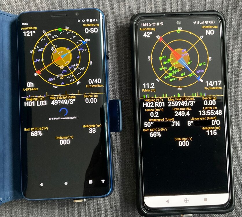

Jormsen 12 Posted October 18, 2022 Share Posted October 18, 2022 I also have very bad to no GPS accuracy. GPS Status App and Locus both show many found satellites (more than my Redmi Note 10 Pro) but it never gets more than one or two locked, so no positioning via GPS. I'm in contact with fxtec since i got my pro1x and can confirm that they are not sure if it's hardware or software. I tried Beta firmware and there it seems like many more do have the same issues. Seems like everything support related is on hold until they found if it's hardware or fixed it in software. 1 Quote Link to post Share on other sites
Craig 1,435 Posted October 18, 2022 Share Posted October 18, 2022 (edited) Hmmm bummer. I was hoping everyone was getting the intermittent "lost signal" as other recent pro1x recipients on discord are also having it. My signal appears strong and connected to plenty of satellites when I check it with gps checking software, so that doesn't seem to be my issue. In any case sounds like it's worth holding out on firmware before trying for warranty repair. (I never had Pro¹ or any other phone report gps signal lost while navigating til this Pro¹-X). Edited October 18, 2022 by Craig 1 Quote Link to post Share on other sites

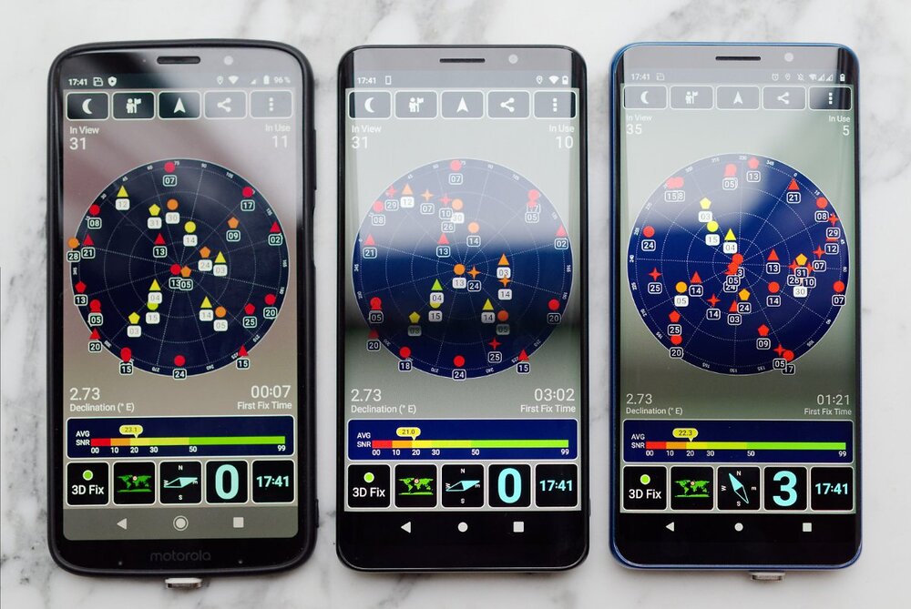

Rob. S. 1,667 Posted October 20, 2022 Share Posted October 20, 2022 (edited) A quick comparison on my window sill that confirms some of the observations here (Left to right—Moto Z3 Play, Pro1, Pro1 X) : Images show the three phones three minutes after AGPS clear and update. The Motorola is the quickest to get the first fix (7 s), the Pro1 by far the slowest (~3 min), the Pro1 X in between (~1 min 20 s). The Pro1 X "sees" the highest number of satellites satellites but "uses" the lowest number. The Pro1 X is much less constant in its readings than the other two, they chance permanently. That includes losing a fix every when there are only few satellites in "use". Especially compass and altitude seem erratic, but position isn't precise, either. For me, GPS is mostly usable for everything I use it for (Google Maps navigation, hiking with Locus), but only just, and for some applications it is hardly precise enough. At least I rarely ever lose the fix outside... Edited October 20, 2022 by Rob. S. 1 Quote Link to post Share on other sites
Rob. S. 1,667 Posted October 20, 2022 Share Posted October 20, 2022 Hmm... Looking at the satellite views, the Pro1 X seems to draw their positions completely different than the other two phones. Could there be a bug in the underlying code, not getting the positions right? Quote Link to post Share on other sites
EskeRahn 5,596 Posted October 20, 2022 Share Posted October 20, 2022 56 minutes ago, Rob. S. said: Hmm... Looking at the satellite views, the Pro1 X seems to draw their positions completely different than the other two phones. Could there be a bug in the underlying code, not getting the positions right? Look at the compass, 90 degree off. I had the same issue initially. Related to the slider, but it solved itself (when in portrait) Just tried again, and it is off again.... Add: Sorry, remembered wrong. It is an autorotate-bug.IF you open it, with an app supporting landscape THEN the orientation is shown correctly. Quote Link to post Share on other sites
Rob. S. 1,667 Posted October 20, 2022 Share Posted October 20, 2022 (edited) 4 minutes ago, EskeRahn said: Look at the compass, 90 degree off That´s interesting indeed. Edited October 20, 2022 by Rob. S. Quote Link to post Share on other sites
