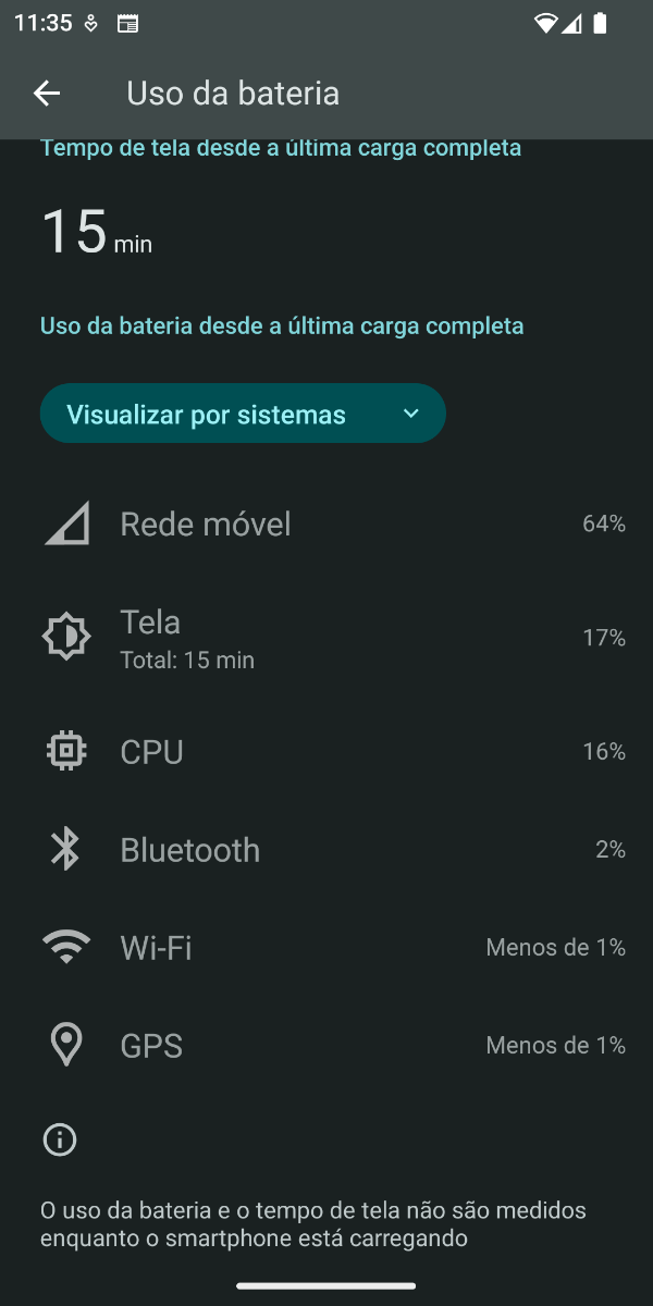

agent008 248 Posted July 6, 2025 Share Posted July 6, 2025 (edited) On 7/3/2025 at 2:14 PM, agent008 said: Thanks, this is info that's good to know, if I ever go back to stock. Currently giving LOS 22.1 a chance. Although it is eating away at the battery almost as fast as 22.2... 🤦♂️ Update on the battery, it seems the radio is to blame, and changing the network type seems to help. This night the phone was on my nightstand and over the course of 6 hours went from 100 to 34%. Network was set to LTE/TDSCDMA/CDMA/EVDO/GSM/WCDMA. Looking at battery usage over system showed the radio as the big culprit. (See image). I've set it before to LTE/TDSCDMA/GSM which seems to work for my local cell network, and battery life seemed to be good, however sometimes the phone would hang while on standby and I changed the network type hoping this would not happen. It didn't happen but then the battery drain issue happened. So now I'm back to LTE/TDSCDMA/GSM and will keep watch of the battery duration and if the hanging issue will return. Edited July 6, 2025 by agent008 1 1 Quote Link to post Share on other sites
