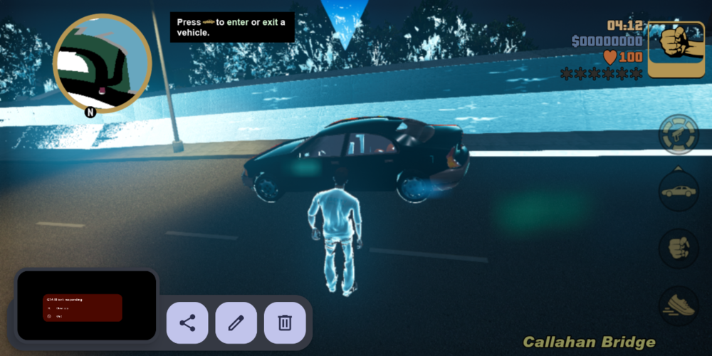

CornholioGSM 370 Posted February 6, 2024 Author Share Posted February 6, 2024 (edited) ...in oddsolutions builds is it classic problem from los19 i mean. Updater always says , that is new version for you. BUT it is same version as you have. You must check date of build 🙂  ...soo wait for new build (date)   BTW i have two problems. Both not too important. i have reinstalled and reflashed in recovery magisk...all looks working - root, rooted apps etc - but magisk always says , that is needed to reinstall due " recovery mode cannot get correct device info"  And another problem ...this problem was on los20 too. I want to play sometime games ...in train, on toilet etc 🙂 I am unable to run any last remastered GTA games (definitive) without problems. Game loads, but i have graphics problems . It looks like 3d rendering problems.  Same game i have tested on pro1x on los21 and was ok (but slow due 6xx chipset) Edited February 6, 2024 by CornholioGSM 1 1 Quote Link to post Share on other sites
