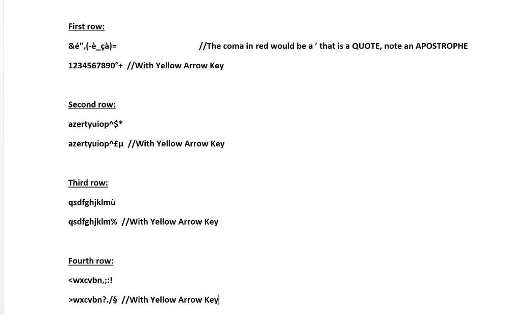

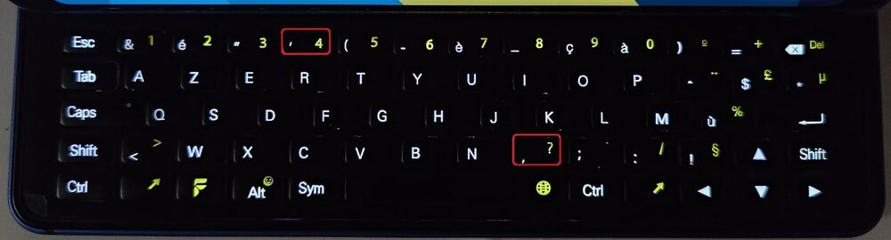

zegoo 13 Posted August 1, 2024 Share Posted August 1, 2024 (edited) Hi all I have a Pro1X rooted under A11 on azerty layout on my physical keyboard and i have some issues when tapping some keys. when I want to type the apostrophe, I get the comma. And when I type the comma, I get the comma. Does anyone know how to correct the problem? Can we access the responsible file and modify it or is this managed by the kernel? Also, how to type the pipe character | ? Other questions: I plan to go under LOS with MicroG. Does anyone know if the AZERTY keyboard will have the same issues and if FM Radio is supported under LOS21 as on A11? Thanks Edited August 1, 2024 by zegoo Quote Link to post Share on other sites

zegoo 13 Posted August 3, 2024 Share Posted August 3, 2024 @Kilrah Thanks for your reply. On Android 11 Stock, all my keyboard keys are working except for that: In French (Azerty Layout), the simple Quote (') is very important. I would a Quote and i got a Coma. And on Row 2, ¨ character with the Yellow Arrow is missing too. But this is not the priority. 😁 And the Pipe (|) character is missing. So i need it too. ☹️ @FlyingAntero, thanks too for your reply. So, you wrote "You cannot modify kcm files without root" but i wrote first that "I have a Pro1X rooted under A11". And regarding FinQwerty, that should be a great idea i deeply looked already but there is no Azerty Layout on FinQwerty kcm Repo. And i don't know how to upload a kcm file i could make by myself (This is not very hard to do ...). So, regarding LineageOS 21, i took a look into LineageOS-21 Fxtec_Pro1-X.kcm GitHub Repo, only one qwerty layout. 😔 I could make the right azerty kcm file by myself and also configuring the following file to right match with the kcm made but in don"t know how to build a personnal LOS21. 🤔 @EskeRahn, thanks too for you reply. As i wrote below, FinQwerty would be nice but even if it is open source, i don't have skills to build a FinQwerty apk with my azerty kcm file. I don't know what is the process to get more layouts working for this app. I can make the right kcm file but how to upload it ? 🤔 Quote Link to post Share on other sites
