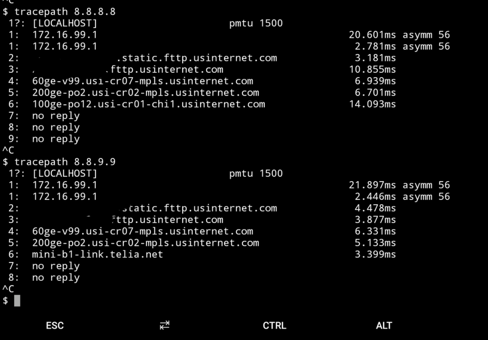

david 929 Posted January 31, 2020 Author Share Posted January 31, 2020 Another data point. I tested a Pixel 4 XL (android 10) and it gets about 2-3 ms to the wireless access point, best case scenario. For anyone else testing, if the router is busy with a lot of other devices talking to it, or you have a lot of apps running on the phone at the same time, that can affect the speed too. Quote Link to post Share on other sites

SirBaconIII 66 Posted January 31, 2020 Share Posted January 31, 2020 (edited) Here's another data point. The second time pinging the gateway is consistantly low, in the 2ms range for me. I could be misreading it though. Also, this is initial testing on my work network. I'd be more confident in my home network where I know how traffic is routed. Edited January 31, 2020 by SirBaconIII Swap picture Quote Link to post Share on other sites
david 929 Posted January 31, 2020 Author Share Posted January 31, 2020 (edited) 1 hour ago, SirBaconIII said: Here's another data point. The second time pinging the gateway is consistantly low, in the 2ms range for me. I could be misreading it though. Also, this is initial testing on my work network. I'd be more confident in my home network where I know how traffic is routed. Those are interesting results, but traceroute does weird things with calculating the latency based on TTL, I think, vs actual pings. What do you get if you ping those DNS servers instead of using traceroute? You mentioned pinging the gateway, but I don't see that test. UPDATE: I just realized it is tracepath, not traceroute. I don't have that, since I'm on Windows. Is it showing the delta between each hop? It must be, since later hops should take longer to get to. If so, then that does make sense. The first hop (to the gateway) is 20+ ms, which is consistent with what we've been seeing. And then the other hops are deltas on top of that, but since they are between each hop, it isn't including the overhead of previous hops and not including the latency issue the Pro1 has. That second entry for the gateway is probably just the gateway talking to itself on different interfaces (although you'd think that would have a different IP address) or something. It is inside the gateway, so is just a delta between them, I'm guessing. Edited January 31, 2020 by david Quote Link to post Share on other sites
sdx 45 Posted February 1, 2020 Share Posted February 1, 2020 There is something funky with the Wifi driver currently. This seems to relate mainly to roaming. Usually, this sounds like you're hitting buffered data that's sent when a timer expires: https://en.wikipedia.org/wiki/Nagle's_algorithm Or you're just on 2,4GHz in a noisy environment. 🙂 I did however try myself with HE network tools. It gives me 1.23ms katency with 0.09ms jitter. This was measured over wifi on 5GHz only. More info about the connection: Performance Signal Strength: -54 dBm Signal Quality: 39 dB Connection Speed: 867 Mbps Channel Width: 80 MHz Capabilities 802.11ac (5GHz) Spatial Stream: 2 1 Quote Link to post Share on other sites

david 929 Posted February 1, 2020 Author Share Posted February 1, 2020 10 hours ago, sdx said: There is something funky with the Wifi driver currently. This seems to relate mainly to roaming. Can you explain this in more detail? What type of roaming are you referring to? 10 hours ago, sdx said: Usually, this sounds like you're hitting buffered data that's sent when a timer expires: https://en.wikipedia.org/wiki/Nagle's_algorithm Yeah, some sort of timer could be involved. 10 hours ago, sdx said: Or you're just on 2,4GHz in a noisy environment. 🙂 This is a consistent issue though, with the latency around 20 ms. With a congested environment, the values would jump around more. 10 hours ago, sdx said: I did however try myself with HE network tools. It gives me 1.23ms katency with 0.09ms jitter. This was measured over wifi on 5GHz only. More info about the connection: Performance Signal Strength: -54 dBm Signal Quality: 39 dB Connection Speed: 867 Mbps Channel Width: 80 MHz Capabilities 802.11ac (5GHz) Spatial Stream: 2 I downloaded the app to the Pro1, but I can't find which tool to run that gives a jitter value. The Ping function in the HE network tools I downloaded runs 3 pings very fast (no delay, which is what other ping tools usually do) and gives an average, std. dev (maybe that is what you are referring to as jitter?), last, best and worst values. For some reason, it does normally show 2-3 ms for me, which is much better than the normal value I get from other ping tools. So the question is, what is it doing that the other tools are not doing? It isn't delaying between pings, so maybe that has some effect on this behavior. I did try this: ping -i .2 192.168.1.3 That ran the pings 200 ms apart instead of 1 second, but I still got 20 ms as a frequent latency. Quote Link to post Share on other sites
sdx 45 Posted February 1, 2020 Share Posted February 1, 2020 7 minutes ago, david said: Can you explain this in more detail? What type of roaming are you referring to? Yeah, some sort of timer could be involved. This is a consistent issue though, with the latency around 20 ms. With a congested environment, the values would jump around more. I downloaded the app to the Pro1, but I can't find which tool to run that gives a jitter value. The Ping function in the HE network tools I downloaded runs 3 pings very fast (no delay, which is what other ping tools usually do) and gives an average, std. dev (maybe that is what you are referring to as jitter?), last, best and worst values. For some reason, it does normally show 2-3 ms for me, which is much better than the normal value I get from other ping tools. So the question is, what is it doing that the other tools are not doing? It isn't delaying between pings, so maybe that has some effect on this behavior. I did try this: ping -i .2 192.168.1.3 That ran the pings 200 ms apart instead of 1 second, but I still got 20 ms as a frequent latency. Roaming between AP's. I have three AP's in my apartment, controlled by one wireless controller. They're all Cisco 2700 series AP's. Yes, jitter is the std deviation as seen in HE network tools. So given that HE network tools maybe sends three ICMP echo requests very fast, maybe that's enough to flush the buffer? In that case, this is more of a cosmetic problem in most cases, unless you want to infrequently transfer low amounts of data with low latency. 1 Quote Link to post Share on other sites
DieBruine 397 Posted February 1, 2020 Share Posted February 1, 2020 I've tried several pings using Fring. Only the first ping is 20ms. Out of 15 tries 9 times the first ping, never the second. 5GHz connection, tried 2 different brands, one of whick Unifi. Didn't seem to make any difference. Quote Link to post Share on other sites
david 929 Posted February 2, 2020 Author Share Posted February 2, 2020 (edited) 12 hours ago, sdx said: Roaming between AP's. I have three AP's in my apartment, controlled by one wireless controller. They're all Cisco 2700 series AP's. Yes, jitter is the std deviation as seen in HE network tools. So given that HE network tools maybe sends three ICMP echo requests very fast, maybe that's enough to flush the buffer? In that case, this is more of a cosmetic problem in most cases, unless you want to infrequently transfer low amounts of data with low latency. Yeah, I guess that is possible. Not a very big buffer then. I just tried pinging with more data instead of the default amount and that didn't cause the latency to decrease. It would have to be based on number of requests, rather than size of the data, to work like you theorized, I think. ping -s 10000 192.168.1.3 That's what I ran, in case anyone else wants to try. That sends 10000 bytes instead of the default 56 bytes (not including the IP header). Edited February 2, 2020 by david Quote Link to post Share on other sites
