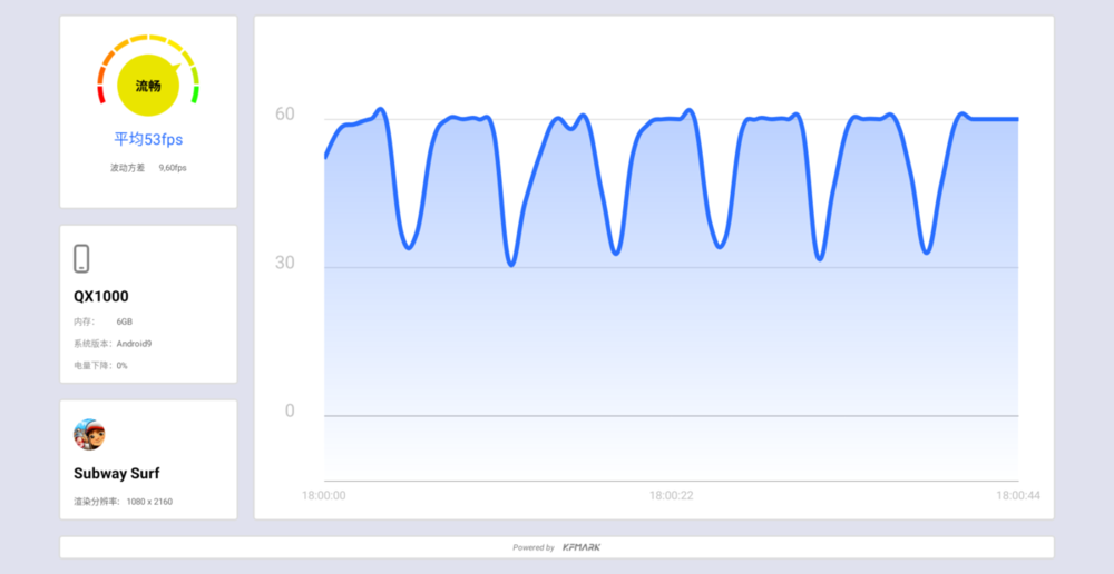

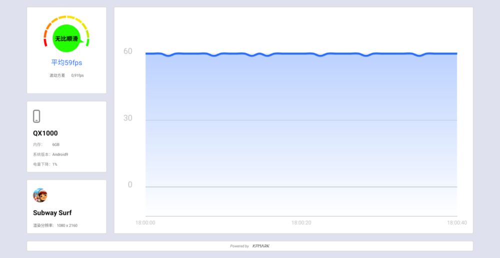

Digging this up again with an old new discovery. Well, something I noticed back in February on my old unit but only now bugged me again which made me remember.
If you've used HDMI before, it might've triggered some bug that causes periodical stutter every few seconds. It feels a bit like there are vsync misses, so depending on how apps are coded, they may slow down or skip frames or even run faster for a brief moment. Though it can also be just observed when scrolling menus if you pay attention.
At first I thought only rebooting fixes it, but as the bug appears to be random, just plugging in HDMI again may also work.
Here's two GFXBench graphs, one while stutter bug is active, and one after fixing it (via HDMI plugging, no reboots in-between):
Screenshot_20200829-222836.thumb.png.6c740e9fadae29d30ec74b6f6ad69c24.pngScreenshot_20200830-030816.thumb.png.e3ffce163cb08f7a4e9c1e6b12086c80.png
The benchmark itself doesn't matter. This one wasn't making the Pro1 sweat all and was limited by vsync. The graphs are pretty telling though.
I'm not sure if I'm really onto something here, but the graph looks awfully similar to what FlyingAntero had in their benchmarks in May. I wonder if they ever used HDMI on their phone.
If not, then I'll still leave this info here as a warning for anyone who dares to plug in their phone via HDMI. Could go wrong. Perhaps it's my cable, but otherwise HDMI is working fine here, so dunno.

Interesting found! I did a clean flash some time ago and I have not plugged my device to HDMI after that. So today, I performed the FPS test again and faced no issues 💪.
I will test later on if plugging to HDMI triggers the issue again.
Edit:
I can confirm, plugging the phone to HDMI triggers the issue. Performance was OK when device was plugged but after I removed the cable the issue was there. See from below.
