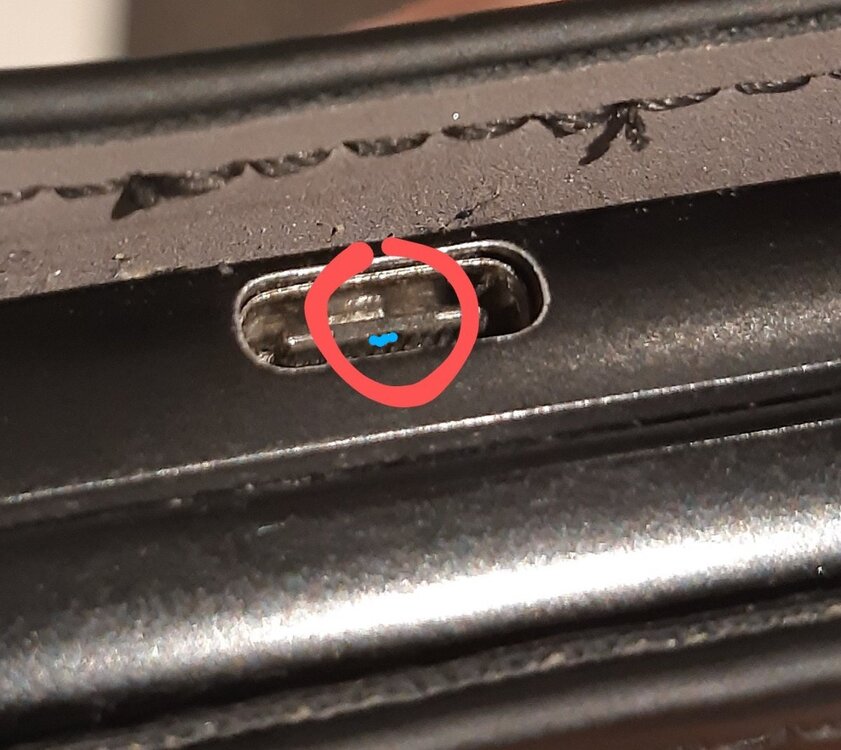

FlyingAntero 871 Posted November 5, 2020 Share Posted November 5, 2020 (edited) Unfortunately, it seems that the USB port on my Pro1 does not work like it should anymore. Everything was fine a while ago but now I can't get HDMI output. It was working great with the same monitor earlier. Also, fast charging is not activated every time when I connect phone to the original QC3.0 charger. However, I can get fast charging activated every time with different USB-PD charger but only if I connect the cable right way. If I rotate the cable 180 degrees it does not charge at all. I checked that there is not any visible dirt in the port but I can see a tiny "cleft" in the pin. It is on the screen side of the pin and in the middle (see the picture below). I am not sure if it is a defect. Can anyone check if there is a similar thing on your phone? @DieBruine Was your USB type-C HDMI output issue resolved? Link: https://imgur.com/a/9VdUALy Edited November 5, 2020 by FlyingAntero Quote Link to post Share on other sites
VaZso 1,999 Posted November 5, 2020 Share Posted November 5, 2020 37 minutes ago, FlyingAntero said: Can anyone check if there is a similar thing on your phone? I find mine similar but cleaner. So there is a metal part at the two sides but not in the middle, it seems the connector was designed that way. Anyway, that Type-C connector was designed to be on a standalone panel, so it can be replaced more easily. However it is a question if F(x)tec has replacement panels, but a question may worth a try... 1 1 Quote Link to post Share on other sites

FlyingAntero 871 Posted November 5, 2020 Share Posted November 5, 2020 3 hours ago, VaZso said: I find mine similar but cleaner. So there is a metal part at the two sides but not in the middle, it seems the connector was designed that way. Anyway, that Type-C connector was designed to be on a standalone panel, so it can be replaced more easily. However it is a question if F(x)tec has replacement panels, but a question may worth a try... Thanks for your reply. However, I was not talking about the top of the pin where metal parts can be found from both sides. I was talking about the part where the connectors are. I marked that part with blue color on picture below. It is really small "cleft". Quote Link to post Share on other sites
netman 1,424 Posted November 5, 2020 Share Posted November 5, 2020 (edited) 2 hours ago, FlyingAntero said: Thanks for your reply. However, I was not talking about the top of the pin where metal parts can be found from both sides. I was talking about the part where the connectors are. I marked that part with blue color on picture below. It is really small "cleft". Mine does not have this cleft. It does on the other side than pictured but it's hard to see and even harder to get on photo. Edited November 5, 2020 by netman 1 Quote Link to post Share on other sites

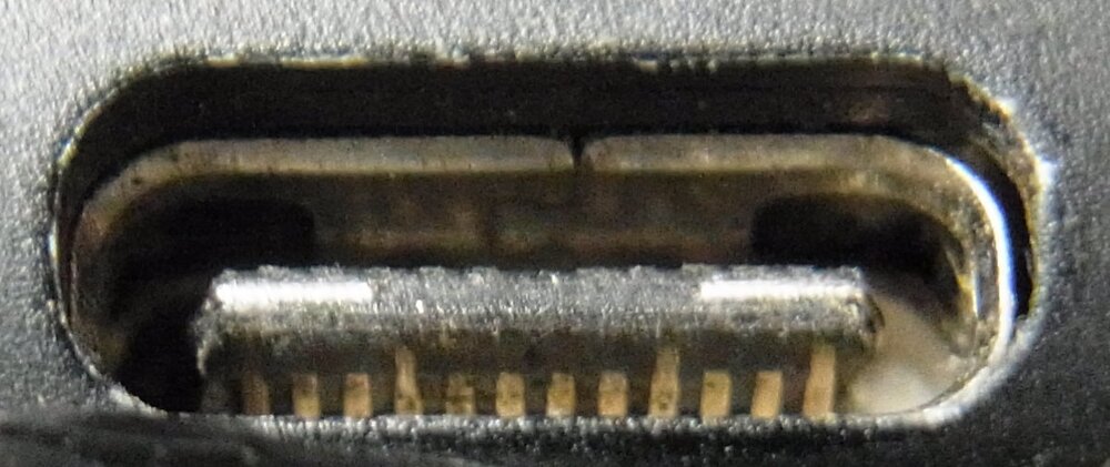

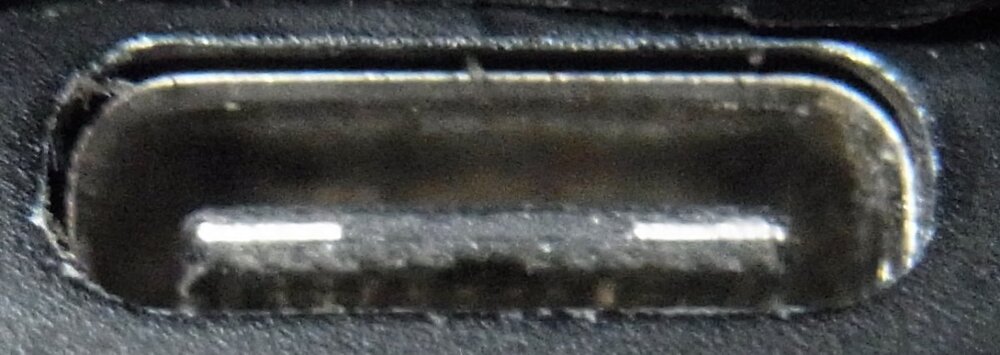

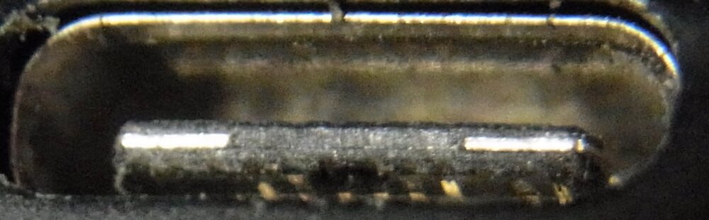

EskeRahn 5,598 Posted November 5, 2020 Share Posted November 5, 2020 I do have the same cleft on the TOP side of the connector first tried they slightly easier photo from below, and here I see no cleft 1 Quote Link to post Share on other sites
VaZso 1,999 Posted November 5, 2020 Share Posted November 5, 2020 (edited) 16 minutes ago, EskeRahn said: I do not see this (Tough photo to get decent BTW) That is the other direction anyway. I have tried to look at mine and I clearly see what @EskeRahntook a photo of but at the opposite side I suspect it is also have "something" in the middle. Anyway, I have a Pro1 which was only connected to the charger once. I can clearly see both sides of its connector, there isn't any differences of the connection. I think this is because I am charging it using a cable which also has a light at Type-C side which I covered earlier but that "cover" felt off, so I always plug it facing down as I don't like such lights. So that means I usually use only one side of that connector and apparently that is the side worn a bit. (Basically Type-C is a reversible connector which means the connector side has all of the connections at both sides, basically it is a dual connector in one component - also that is why it may work if you turn around the cable.) Edit: I see you took a photo also of other side. Edited November 5, 2020 by VaZso Quote Link to post Share on other sites
FlyingAntero 871 Posted November 5, 2020 Share Posted November 5, 2020 (edited) 9 minutes ago, EskeRahn said: I do have the same cleft on the TOP side of the connector first tried they slightly easier photo from below, and here I see no cleft Thanks! That looks similar to my device. I think that the issue might be somewhere else. Most probably it is a hardware thing but I am planning to flash LOS 17.1 when it is released just to be sure. Edited November 5, 2020 by FlyingAntero 1 Quote Link to post Share on other sites
EskeRahn 5,598 Posted November 5, 2020 Share Posted November 5, 2020 18 minutes ago, VaZso said: Edit: I see you took a photo also of other side. (Yeah, and killed the old post to avoid confusion, but not fast enough *LOL* ) Quote Link to post Share on other sites
netman 1,424 Posted November 5, 2020 Share Posted November 5, 2020 39 minutes ago, EskeRahn said: I do have the same cleft on the TOP side of the connector Checking again by eye with a bright lamp I can also see this on mine, I am sorry for any confusion caused. The top side I can't seem to capture on photo any good. 1 Quote Link to post Share on other sites
EskeRahn 5,598 Posted November 5, 2020 Share Posted November 5, 2020 1 hour ago, netman said: The top side I can't seem to capture on photo any good. It took me a number of attempts too to get anything sensible. It is (relatively) much easier to get a photo of the other side. 1 Quote Link to post Share on other sites
