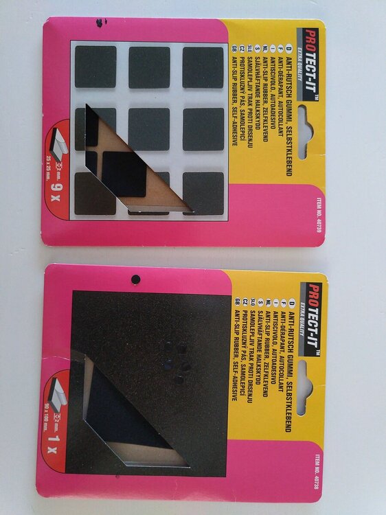

Slion 1,201 Posted July 3, 2020 Author Share Posted July 3, 2020 (edited) 2mm neoprene. I'll try with those 3 for a while they should flatten over time, they are really squishy. Just setting up those three is fixing any rattling when closed. Edited July 3, 2020 by Slion 3 Quote Link to post Share on other sites

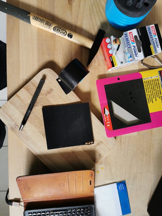

Slion 1,201 Posted July 3, 2020 Author Share Posted July 3, 2020 5mm hole punch does the job just fine then you can try any material you want. 6 Quote Link to post Share on other sites
Slion 1,201 Posted July 5, 2020 Author Share Posted July 5, 2020 I did some trials with various materials and thickness. If you just want to cover the screws any black tape will do. If you want to get ride of the rattling while closed you probably need 2mm squishy foam on every corner of the screen. Nothing else would do for me. I tried 1mm hard rubber in seven emplacements, including the four corners and the two screws in the middle and that does not help at all with the rattling. I've settled with 2mm rubber foam on every corner and 1mm hard rubber for those two screws in the middle. 1 1 Quote Link to post Share on other sites

EskeRahn 5,598 Posted August 5, 2020 Share Posted August 5, 2020 1 hour ago, OKSun said: Where did you purchase them? in which material did you punch the holes? You can easily find mats of various thickness on e.g. ebay. Search for "adhesive neoprene" (or rubber) and you will find it offered as mats or bands in various thickness. 3 Quote Link to post Share on other sites
Slion 1,201 Posted August 5, 2020 Author Share Posted August 5, 2020 3 hours ago, OKSun said: Where did you purchase them? in which material did you punch the holes? From an old batch I bought like 10 years ago in a hardware store in Germany. 1 2 Quote Link to post Share on other sites

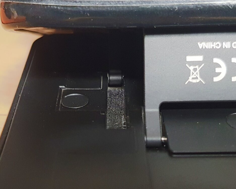

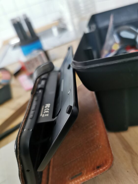

OKSun 103 Posted August 6, 2020 Share Posted August 6, 2020 (edited) I have been reading the following post: I understand that the tape should be pasted there?? EskeRahn had suggested another location at the begining (see picture). Edited August 6, 2020 by OKSun 2 Quote Link to post Share on other sites
