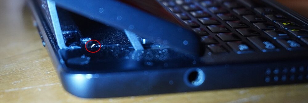

foxfreejack 60 Posted November 19, 2021 Share Posted November 19, 2021 I don't know that there are other hardware revisions, but on mine I found a leaf switch near the hinge (see the image), it can be blocked from making contact to ground and would make the device think it's open permanently. Quote Link to post Share on other sites
Maplesteel 97 Posted November 19, 2021 Author Share Posted November 19, 2021 48 minutes ago, foxfreejack said: I don't know that there are other hardware revisions, but on mine I found a leaf switch near the hinge (see the image), it can be blocked from making contact to ground and would make the device think it's open permanently. Ooh, thanks for this. I tested pressing that down on mine with a little screwdriver, didn't seem to have much effect. Apparently my microphone on the device is also dead. So...I'm gonna send it in to FxTec and let 'em replace the screen + fix whatever I did when I dropped it again. Even if the device has to take a few months break and/or be a backup device, I want to have it for the long haul. 1 Quote Link to post Share on other sites
EskeRahn 5,598 Posted November 19, 2021 Share Posted November 19, 2021 3 hours ago, foxfreejack said: I don't know that there are other hardware revisions, but on mine I found a leaf switch near the hinge (see the image), it can be blocked from making contact to ground and would make the device think it's open permanently. As far as I know this is not a switch. My guess is that it is a spring dampening the close. 1 Quote Link to post Share on other sites
VaZso 1,999 Posted November 19, 2021 Share Posted November 19, 2021 53 minutes ago, EskeRahn said: As far as I know this is not a switch. My guess is that it is a spring dampening the close. Right, that seems to be a small spring. There is a screw which locks it to the base and it is curved similarly like some battery connections of older phones. It is definitively not a switch, the "switch" is a hall effect sensor combined with a magnet at the opposite part. 1 Quote Link to post Share on other sites
foxfreejack 60 Posted November 20, 2021 Share Posted November 20, 2021 18 hours ago, VaZso said: Right, that seems to be a small spring. There is a screw which locks it to the base and it is curved similarly like some battery connections of older phones. It is definitively not a switch, the "switch" is a hall effect sensor combined with a magnet at the opposite part. Hi, I just did the experiment and yep, contact or not it still detects when display is closed. Quote Link to post Share on other sites
VaZso 1,999 Posted November 20, 2021 Share Posted November 20, 2021 18 minutes ago, foxfreejack said: I just did the experiment and yep, contact or not it still detects when display is closed. How? Haven't you tried to check it using a magnetized screwdriver? It seems the magnet at display side is really close, so there should be a hall effect sensor relatively close to that spring. 1 Quote Link to post Share on other sites
EskeRahn 5,598 Posted November 21, 2021 Share Posted November 21, 2021 The hall sensor for open/close is at the other side (between the usb-port and camera button) The other sensor has no real effect by default (sends a key comb) but with @Slion 's toolpack it can turn screen off with a flipcase with strategically placed magnet. 1 Quote Link to post Share on other sites
