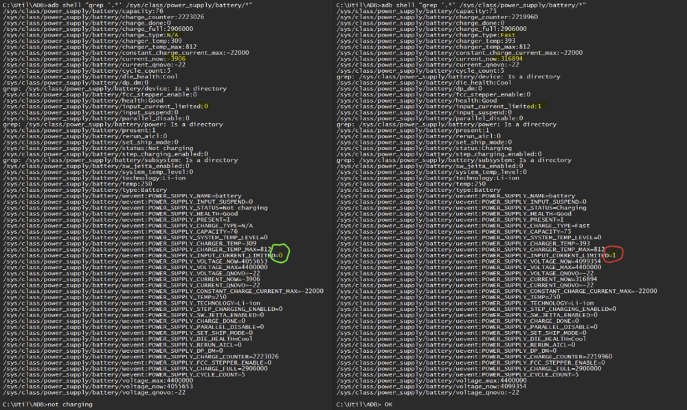

EskeRahn 5,598 Posted September 6, 2022 Author Share Posted September 6, 2022 8 hours ago, brunoais said: While on it, this can help too understanding if there's changes in "file" permissions there. When the bug is present: C:\Util\ADB>adb shell "grep '.*' /sys/class/power_supply/battery/*" /sys/class/power_supply/battery/capacity:85 /sys/class/power_supply/battery/charge_counter:2491300 /sys/class/power_supply/battery/charge_done:0 /sys/class/power_supply/battery/charge_full:2906000 /sys/class/power_supply/battery/charge_type:N/A /sys/class/power_supply/battery/charger_temp:296 /sys/class/power_supply/battery/charger_temp_max:812 /sys/class/power_supply/battery/constant_charge_current_max:-22000 /sys/class/power_supply/battery/current_now:-3417 /sys/class/power_supply/battery/current_qnovo:-22 /sys/class/power_supply/battery/cycle_count:5 /sys/class/power_supply/battery/die_health:Cool /sys/class/power_supply/battery/dp_dm:0 /sys/class/power_supply/battery/fcc_stepper_enable:0 grep: /sys/class/power_supply/battery/device: Is a directory /sys/class/power_supply/battery/health:Good /sys/class/power_supply/battery/input_current_limited:0 /sys/class/power_supply/battery/input_suspend:0 /sys/class/power_supply/battery/parallel_disable:0 grep: /sys/class/power_supply/battery/power: Is a directory /sys/class/power_supply/battery/present:1 /sys/class/power_supply/battery/rerun_aicl:0 /sys/class/power_supply/battery/set_ship_mode:0 /sys/class/power_supply/battery/status:Not charging /sys/class/power_supply/battery/step_charging_enabled:0 grep: /sys/class/power_supply/battery/subsystem: Is a directory /sys/class/power_supply/battery/sw_jeita_enabled:0 /sys/class/power_supply/battery/system_temp_level:0 /sys/class/power_supply/battery/technology:Li-ion /sys/class/power_supply/battery/temp:240 /sys/class/power_supply/battery/type:Battery /sys/class/power_supply/battery/uevent:POWER_SUPPLY_NAME=battery /sys/class/power_supply/battery/uevent:POWER_SUPPLY_INPUT_SUSPEND=0 /sys/class/power_supply/battery/uevent:POWER_SUPPLY_STATUS=Not charging /sys/class/power_supply/battery/uevent:POWER_SUPPLY_HEALTH=Good /sys/class/power_supply/battery/uevent:POWER_SUPPLY_PRESENT=1 /sys/class/power_supply/battery/uevent:POWER_SUPPLY_CHARGE_TYPE=N/A /sys/class/power_supply/battery/uevent:POWER_SUPPLY_CAPACITY=85 /sys/class/power_supply/battery/uevent:POWER_SUPPLY_SYSTEM_TEMP_LEVEL=0 /sys/class/power_supply/battery/uevent:POWER_SUPPLY_CHARGER_TEMP=296 /sys/class/power_supply/battery/uevent:POWER_SUPPLY_CHARGER_TEMP_MAX=812 /sys/class/power_supply/battery/uevent:POWER_SUPPLY_INPUT_CURRENT_LIMITED=0 /sys/class/power_supply/battery/uevent:POWER_SUPPLY_VOLTAGE_NOW=4167713 /sys/class/power_supply/battery/uevent:POWER_SUPPLY_VOLTAGE_MAX=4400000 /sys/class/power_supply/battery/uevent:POWER_SUPPLY_VOLTAGE_QNOVO=-22 /sys/class/power_supply/battery/uevent:POWER_SUPPLY_CURRENT_NOW=-3417 /sys/class/power_supply/battery/uevent:POWER_SUPPLY_CURRENT_QNOVO=-22 /sys/class/power_supply/battery/uevent:POWER_SUPPLY_CONSTANT_CHARGE_CURRENT_MAX=-22000 /sys/class/power_supply/battery/uevent:POWER_SUPPLY_TEMP=240 /sys/class/power_supply/battery/uevent:POWER_SUPPLY_TECHNOLOGY=Li-ion /sys/class/power_supply/battery/uevent:POWER_SUPPLY_STEP_CHARGING_ENABLED=0 /sys/class/power_supply/battery/uevent:POWER_SUPPLY_SW_JEITA_ENABLED=0 /sys/class/power_supply/battery/uevent:POWER_SUPPLY_CHARGE_DONE=0 /sys/class/power_supply/battery/uevent:POWER_SUPPLY_PARALLEL_DISABLE=0 /sys/class/power_supply/battery/uevent:POWER_SUPPLY_SET_SHIP_MODE=0 /sys/class/power_supply/battery/uevent:POWER_SUPPLY_DIE_HEALTH=Cool /sys/class/power_supply/battery/uevent:POWER_SUPPLY_RERUN_AICL=0 /sys/class/power_supply/battery/uevent:POWER_SUPPLY_DP_DM=0 /sys/class/power_supply/battery/uevent:POWER_SUPPLY_CHARGE_COUNTER=2491300 /sys/class/power_supply/battery/uevent:POWER_SUPPLY_FCC_STEPPER_ENABLE=0 /sys/class/power_supply/battery/uevent:POWER_SUPPLY_CHARGE_FULL=2906000 /sys/class/power_supply/battery/uevent:POWER_SUPPLY_CYCLE_COUNT=5 /sys/class/power_supply/battery/voltage_max:4400000 /sys/class/power_supply/battery/voltage_now:4167713 /sys/class/power_supply/battery/voltage_qnovo:-22 C:\Util\ADB>adb shell "ls -la /sys/class/power_supply/battery/*" -rw-r--r-- 1 root root 4096 2022-09-06 13:54 /sys/class/power_supply/battery/capacity -r--r--r-- 1 root root 4096 2022-09-06 13:54 /sys/class/power_supply/battery/charge_counter -r--r--r-- 1 root root 4096 2022-09-06 13:54 /sys/class/power_supply/battery/charge_done -r--r--r-- 1 root root 4096 2022-09-06 13:54 /sys/class/power_supply/battery/charge_full -r--r--r-- 1 root root 4096 2022-09-06 13:54 /sys/class/power_supply/battery/charge_type -r--r--r-- 1 root root 4096 2022-09-06 13:54 /sys/class/power_supply/battery/charger_temp -r--r--r-- 1 root root 4096 2022-09-06 13:54 /sys/class/power_supply/battery/charger_temp_max -r--r--r-- 1 root root 4096 2022-09-06 13:54 /sys/class/power_supply/battery/constant_charge_current_max -r--r--r-- 1 root root 4096 2022-09-06 13:54 /sys/class/power_supply/battery/current_now -r--r--r-- 1 root root 4096 2022-09-06 13:54 /sys/class/power_supply/battery/current_qnovo -r--r--r-- 1 root root 4096 2022-09-06 13:54 /sys/class/power_supply/battery/cycle_count lrwxrwxrwx 1 root root 0 1972-06-25 08:20 /sys/class/power_supply/battery/device -> ../../../800f000.qcom,spmi:qcom,pmi8998@2:qcom,qpnp-smb2 -r--r--r-- 1 root root 4096 2022-09-06 13:54 /sys/class/power_supply/battery/die_health -rw-r--r-- 1 root root 4096 2022-09-06 13:54 /sys/class/power_supply/battery/dp_dm -r--r--r-- 1 root root 4096 2022-09-06 13:54 /sys/class/power_supply/battery/fcc_stepper_enable -r--r--r-- 1 root root 4096 2022-09-06 13:54 /sys/class/power_supply/battery/health -rw-r--r-- 1 root root 4096 2022-09-06 13:54 /sys/class/power_supply/battery/input_current_limited -rw-r--r-- 1 root root 4096 2022-09-06 13:54 /sys/class/power_supply/battery/input_suspend -rw-r--r-- 1 root root 4096 2022-09-06 13:54 /sys/class/power_supply/battery/parallel_disable -r--r--r-- 1 root root 4096 2022-09-06 13:54 /sys/class/power_supply/battery/present -rw-r--r-- 1 root root 4096 2022-09-06 13:54 /sys/class/power_supply/battery/rerun_aicl -r--r--r-- 1 root root 4096 2022-09-06 13:54 /sys/class/power_supply/battery/set_ship_mode -r--r--r-- 1 root root 4096 2022-09-06 13:54 /sys/class/power_supply/battery/status -rw-r--r-- 1 root root 4096 2022-09-06 13:54 /sys/class/power_supply/battery/step_charging_enabled lrwxrwxrwx 1 root root 0 1972-06-25 08:20 /sys/class/power_supply/battery/subsystem -> ../../../../../../../../class/power_supply -rw-r--r-- 1 root root 4096 2022-09-06 13:54 /sys/class/power_supply/battery/sw_jeita_enabled -rw-r--r-- 1 root root 4096 2022-09-06 13:54 /sys/class/power_supply/battery/system_temp_level -r--r--r-- 1 root root 4096 2022-09-06 13:54 /sys/class/power_supply/battery/technology -r--r--r-- 1 root root 4096 2022-09-06 13:54 /sys/class/power_supply/battery/temp -r--r--r-- 1 root root 4096 2022-09-06 13:54 /sys/class/power_supply/battery/type -rw-r--r-- 1 root root 4096 2022-09-06 13:54 /sys/class/power_supply/battery/uevent -r--r--r-- 1 root root 4096 2022-09-06 13:54 /sys/class/power_supply/battery/voltage_max -r--r--r-- 1 root root 4096 2022-09-06 13:54 /sys/class/power_supply/battery/voltage_now -r--r--r-- 1 root root 4096 2022-09-06 13:54 /sys/class/power_supply/battery/voltage_qnovo /sys/class/power_supply/battery/power: total 0 drwxr-xr-x 2 root root 0 2022-09-06 13:54 . drwxr-xr-x 3 root root 0 2022-09-06 13:54 .. -rw-r--r-- 1 root root 4096 2022-09-06 13:54 autosuspend_delay_ms -rw-r--r-- 1 root root 4096 2022-09-06 13:54 control -r--r--r-- 1 root root 4096 2022-09-06 13:54 runtime_active_time -r--r--r-- 1 root root 4096 2022-09-06 13:54 runtime_status -r--r--r-- 1 root root 4096 2022-09-06 13:54 runtime_suspended_time -rw-r--r-- 1 root root 4096 2022-09-06 13:54 wakeup -r--r--r-- 1 root root 4096 2022-09-06 13:54 wakeup_abort_count -r--r--r-- 1 root root 4096 2022-09-06 13:54 wakeup_active -r--r--r-- 1 root root 4096 2022-09-06 13:54 wakeup_active_count -r--r--r-- 1 root root 4096 2022-09-06 13:54 wakeup_count -r--r--r-- 1 root root 4096 2022-09-06 13:54 wakeup_expire_count -r--r--r-- 1 root root 4096 2022-09-06 13:54 wakeup_last_time_ms -r--r--r-- 1 root root 4096 2022-09-06 13:54 wakeup_max_time_ms -r--r--r-- 1 root root 4096 2022-09-06 13:54 wakeup_prevent_sleep_time_ms -r--r--r-- 1 root root 4096 2022-09-06 13:54 wakeup_total_time_ms Quote Link to post Share on other sites
brunoais 335 Posted September 6, 2022 Share Posted September 6, 2022 (edited) 51 minutes ago, EskeRahn said: When the bug is present: C:\Util\ADB>adb shell "grep '.*' /sys/class/power_supply/battery/*" /sys/class/power_supply/battery/capacity:85 /sys/class/power_supply/battery/charge_counter:2491300 /sys/class/power_supply/battery/charge_done:0 /sys/class/power_supply/battery/charge_full:2906000 /sys/class/power_supply/battery/charge_type:N/A /sys/class/power_supply/battery/charger_temp:296 /sys/class/power_supply/battery/charger_temp_max:812 /sys/class/power_supply/battery/constant_charge_current_max:-22000 /sys/class/power_supply/battery/current_now:-3417 /sys/class/power_supply/battery/current_qnovo:-22 /sys/class/power_supply/battery/cycle_count:5 /sys/class/power_supply/battery/die_health:Cool /sys/class/power_supply/battery/dp_dm:0 /sys/class/power_supply/battery/fcc_stepper_enable:0 grep: /sys/class/power_supply/battery/device: Is a directory /sys/class/power_supply/battery/health:Good /sys/class/power_supply/battery/input_current_limited:0 /sys/class/power_supply/battery/input_suspend:0 /sys/class/power_supply/battery/parallel_disable:0 grep: /sys/class/power_supply/battery/power: Is a directory /sys/class/power_supply/battery/present:1 /sys/class/power_supply/battery/rerun_aicl:0 /sys/class/power_supply/battery/set_ship_mode:0 /sys/class/power_supply/battery/status:Not charging /sys/class/power_supply/battery/step_charging_enabled:0 grep: /sys/class/power_supply/battery/subsystem: Is a directory /sys/class/power_supply/battery/sw_jeita_enabled:0 /sys/class/power_supply/battery/system_temp_level:0 /sys/class/power_supply/battery/technology:Li-ion /sys/class/power_supply/battery/temp:240 /sys/class/power_supply/battery/type:Battery /sys/class/power_supply/battery/uevent:POWER_SUPPLY_NAME=battery /sys/class/power_supply/battery/uevent:POWER_SUPPLY_INPUT_SUSPEND=0 /sys/class/power_supply/battery/uevent:POWER_SUPPLY_STATUS=Not charging /sys/class/power_supply/battery/uevent:POWER_SUPPLY_HEALTH=Good /sys/class/power_supply/battery/uevent:POWER_SUPPLY_PRESENT=1 /sys/class/power_supply/battery/uevent:POWER_SUPPLY_CHARGE_TYPE=N/A /sys/class/power_supply/battery/uevent:POWER_SUPPLY_CAPACITY=85 /sys/class/power_supply/battery/uevent:POWER_SUPPLY_SYSTEM_TEMP_LEVEL=0 /sys/class/power_supply/battery/uevent:POWER_SUPPLY_CHARGER_TEMP=296 /sys/class/power_supply/battery/uevent:POWER_SUPPLY_CHARGER_TEMP_MAX=812 /sys/class/power_supply/battery/uevent:POWER_SUPPLY_INPUT_CURRENT_LIMITED=0 /sys/class/power_supply/battery/uevent:POWER_SUPPLY_VOLTAGE_NOW=4167713 /sys/class/power_supply/battery/uevent:POWER_SUPPLY_VOLTAGE_MAX=4400000 /sys/class/power_supply/battery/uevent:POWER_SUPPLY_VOLTAGE_QNOVO=-22 /sys/class/power_supply/battery/uevent:POWER_SUPPLY_CURRENT_NOW=-3417 /sys/class/power_supply/battery/uevent:POWER_SUPPLY_CURRENT_QNOVO=-22 /sys/class/power_supply/battery/uevent:POWER_SUPPLY_CONSTANT_CHARGE_CURRENT_MAX=-22000 /sys/class/power_supply/battery/uevent:POWER_SUPPLY_TEMP=240 /sys/class/power_supply/battery/uevent:POWER_SUPPLY_TECHNOLOGY=Li-ion /sys/class/power_supply/battery/uevent:POWER_SUPPLY_STEP_CHARGING_ENABLED=0 /sys/class/power_supply/battery/uevent:POWER_SUPPLY_SW_JEITA_ENABLED=0 /sys/class/power_supply/battery/uevent:POWER_SUPPLY_CHARGE_DONE=0 /sys/class/power_supply/battery/uevent:POWER_SUPPLY_PARALLEL_DISABLE=0 /sys/class/power_supply/battery/uevent:POWER_SUPPLY_SET_SHIP_MODE=0 /sys/class/power_supply/battery/uevent:POWER_SUPPLY_DIE_HEALTH=Cool /sys/class/power_supply/battery/uevent:POWER_SUPPLY_RERUN_AICL=0 /sys/class/power_supply/battery/uevent:POWER_SUPPLY_DP_DM=0 /sys/class/power_supply/battery/uevent:POWER_SUPPLY_CHARGE_COUNTER=2491300 /sys/class/power_supply/battery/uevent:POWER_SUPPLY_FCC_STEPPER_ENABLE=0 /sys/class/power_supply/battery/uevent:POWER_SUPPLY_CHARGE_FULL=2906000 /sys/class/power_supply/battery/uevent:POWER_SUPPLY_CYCLE_COUNT=5 /sys/class/power_supply/battery/voltage_max:4400000 /sys/class/power_supply/battery/voltage_now:4167713 /sys/class/power_supply/battery/voltage_qnovo:-22 C:\Util\ADB>adb shell "ls -la /sys/class/power_supply/battery/*" -rw-r--r-- 1 root root 4096 2022-09-06 13:54 /sys/class/power_supply/battery/capacity -r--r--r-- 1 root root 4096 2022-09-06 13:54 /sys/class/power_supply/battery/charge_counter -r--r--r-- 1 root root 4096 2022-09-06 13:54 /sys/class/power_supply/battery/charge_done -r--r--r-- 1 root root 4096 2022-09-06 13:54 /sys/class/power_supply/battery/charge_full -r--r--r-- 1 root root 4096 2022-09-06 13:54 /sys/class/power_supply/battery/charge_type -r--r--r-- 1 root root 4096 2022-09-06 13:54 /sys/class/power_supply/battery/charger_temp -r--r--r-- 1 root root 4096 2022-09-06 13:54 /sys/class/power_supply/battery/charger_temp_max -r--r--r-- 1 root root 4096 2022-09-06 13:54 /sys/class/power_supply/battery/constant_charge_current_max -r--r--r-- 1 root root 4096 2022-09-06 13:54 /sys/class/power_supply/battery/current_now -r--r--r-- 1 root root 4096 2022-09-06 13:54 /sys/class/power_supply/battery/current_qnovo -r--r--r-- 1 root root 4096 2022-09-06 13:54 /sys/class/power_supply/battery/cycle_count lrwxrwxrwx 1 root root 0 1972-06-25 08:20 /sys/class/power_supply/battery/device -> ../../../800f000.qcom,spmi:qcom,pmi8998@2:qcom,qpnp-smb2 -r--r--r-- 1 root root 4096 2022-09-06 13:54 /sys/class/power_supply/battery/die_health -rw-r--r-- 1 root root 4096 2022-09-06 13:54 /sys/class/power_supply/battery/dp_dm -r--r--r-- 1 root root 4096 2022-09-06 13:54 /sys/class/power_supply/battery/fcc_stepper_enable -r--r--r-- 1 root root 4096 2022-09-06 13:54 /sys/class/power_supply/battery/health -rw-r--r-- 1 root root 4096 2022-09-06 13:54 /sys/class/power_supply/battery/input_current_limited -rw-r--r-- 1 root root 4096 2022-09-06 13:54 /sys/class/power_supply/battery/input_suspend -rw-r--r-- 1 root root 4096 2022-09-06 13:54 /sys/class/power_supply/battery/parallel_disable -r--r--r-- 1 root root 4096 2022-09-06 13:54 /sys/class/power_supply/battery/present -rw-r--r-- 1 root root 4096 2022-09-06 13:54 /sys/class/power_supply/battery/rerun_aicl -r--r--r-- 1 root root 4096 2022-09-06 13:54 /sys/class/power_supply/battery/set_ship_mode -r--r--r-- 1 root root 4096 2022-09-06 13:54 /sys/class/power_supply/battery/status -rw-r--r-- 1 root root 4096 2022-09-06 13:54 /sys/class/power_supply/battery/step_charging_enabled lrwxrwxrwx 1 root root 0 1972-06-25 08:20 /sys/class/power_supply/battery/subsystem -> ../../../../../../../../class/power_supply -rw-r--r-- 1 root root 4096 2022-09-06 13:54 /sys/class/power_supply/battery/sw_jeita_enabled -rw-r--r-- 1 root root 4096 2022-09-06 13:54 /sys/class/power_supply/battery/system_temp_level -r--r--r-- 1 root root 4096 2022-09-06 13:54 /sys/class/power_supply/battery/technology -r--r--r-- 1 root root 4096 2022-09-06 13:54 /sys/class/power_supply/battery/temp -r--r--r-- 1 root root 4096 2022-09-06 13:54 /sys/class/power_supply/battery/type -rw-r--r-- 1 root root 4096 2022-09-06 13:54 /sys/class/power_supply/battery/uevent -r--r--r-- 1 root root 4096 2022-09-06 13:54 /sys/class/power_supply/battery/voltage_max -r--r--r-- 1 root root 4096 2022-09-06 13:54 /sys/class/power_supply/battery/voltage_now -r--r--r-- 1 root root 4096 2022-09-06 13:54 /sys/class/power_supply/battery/voltage_qnovo /sys/class/power_supply/battery/power: total 0 drwxr-xr-x 2 root root 0 2022-09-06 13:54 . drwxr-xr-x 3 root root 0 2022-09-06 13:54 .. -rw-r--r-- 1 root root 4096 2022-09-06 13:54 autosuspend_delay_ms -rw-r--r-- 1 root root 4096 2022-09-06 13:54 control -r--r--r-- 1 root root 4096 2022-09-06 13:54 runtime_active_time -r--r--r-- 1 root root 4096 2022-09-06 13:54 runtime_status -r--r--r-- 1 root root 4096 2022-09-06 13:54 runtime_suspended_time -rw-r--r-- 1 root root 4096 2022-09-06 13:54 wakeup -r--r--r-- 1 root root 4096 2022-09-06 13:54 wakeup_abort_count -r--r--r-- 1 root root 4096 2022-09-06 13:54 wakeup_active -r--r--r-- 1 root root 4096 2022-09-06 13:54 wakeup_active_count -r--r--r-- 1 root root 4096 2022-09-06 13:54 wakeup_count -r--r--r-- 1 root root 4096 2022-09-06 13:54 wakeup_expire_count -r--r--r-- 1 root root 4096 2022-09-06 13:54 wakeup_last_time_ms -r--r--r-- 1 root root 4096 2022-09-06 13:54 wakeup_max_time_ms -r--r--r-- 1 root root 4096 2022-09-06 13:54 wakeup_prevent_sleep_time_ms -r--r--r-- 1 root root 4096 2022-09-06 13:54 wakeup_total_time_ms Oh! This is wrong! 51 minutes ago, EskeRahn said: /sys/class/power_supply/battery/constant_charge_current_max:-22000 What happens if you (as root): chmod 644 /sys/class/power_supply/battery/constant_charge_current_max echo 22000 > /sys/class/power_supply/battery/constant_charge_current_max But that may not be enough... If the % doesn't change in about 20 mins, try: chmod 644 /sys/class/power_supply/battery/constant_charge_current_max echo 40000 > /sys/class/power_supply/battery/constant_charge_current_max That should be enough for the phone to start charging significantly. Do execute this from time to time to confirm if it's being overridden by something else: cat /sys/class/power_supply/battery/constant_charge_current_max Let me know what you are able to figure out with this info... Edited September 6, 2022 by brunoais 1 1 Quote Link to post Share on other sites
EskeRahn 5,598 Posted September 7, 2022 Author Share Posted September 7, 2022 13 hours ago, brunoais said: Oh! This is wrong! 14 hours ago, EskeRahn said: /sys/class/power_supply/battery/constant_charge_current_max:-22000 It looks this way no matter if charging is working or not. So not an indicator as such. And do not get fooled by the sign. Some phones reports charging as negative (e.g. Pro1 and Samsung S8-) other reports usage as negative (e.g. Titan Slim). I see this in "3C All-In-One Toolbox", that there is disagreement on the sign between different models.. Quote Link to post Share on other sites
brunoais 335 Posted September 7, 2022 Share Posted September 7, 2022 (edited) 1 hour ago, EskeRahn said: It looks this way no matter if charging is working or not. So not an indicator as such. And do not get fooled by the sign. Some phones reports charging as negative (e.g. Pro1 and Samsung S8-) other reports usage as negative (e.g. Titan Slim). I see this in "3C All-In-One Toolbox", that there is disagreement on the sign between different models.. In that case, try using a negative number instead: echo "-40000" > /sys/class/power_supply/battery/constant_charge_current_max (FYI: Pro¹-X uses positive numbers here) Edited September 7, 2022 by brunoais FYI Quote Link to post Share on other sites

EskeRahn 5,598 Posted September 12, 2022 Author Share Posted September 12, 2022 Noticed THIS difference: And POWER_SUPPLY_INPUT_CURRENT_LIMITED sounds very much like what has been my theory all along..... The big question is how to avoid this state being triggered too soon though.... 3 Quote Link to post Share on other sites
brunoais 335 Posted September 12, 2022 Share Posted September 12, 2022 (edited) On 9/12/2022 at 11:53 AM, EskeRahn said: Noticed THIS difference: And POWER_SUPPLY_INPUT_CURRENT_LIMITED sounds very much like what has been my theory all along..... The big question is how to avoid this state being triggered too soon though.... From the kernel/driver side, that switch is actually controlled manually and not automatically. It's supposed to be controlled by a userland program which sets that value. I was going to jump to that one after constant_charge_current_max but you mentioned you didn't want o continue, so I stopped. the `uevent` file is just providing all data from other files with some extras. In this case, the culprit is: /sys/class/power_supply/battery/charge_control_limit In my phone, there's 7 settings for it (between 0 and 6). Basically, it's a choice of how fast to charge. I think my device can only use 0-4. I can't see a difference between 4/5/6 when using the provided charger and cable. I almost always set it to either 0 or 1. There should be a service in your phone setting it to 0 in order to stop charging. I wonder what and why... Edited September 14, 2022 by brunoais Clarifying what I mean by "manual control" 2 Quote Link to post Share on other sites
