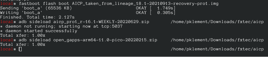

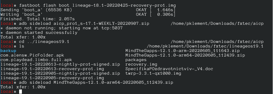

itchy355 24 Posted September 13, 2022 Author Share Posted September 13, 2022 Finally got to another try. 1; flashed recovery 2; booted into recovery 3; sideloaded aicp 4; reboot to recovery 5; sideloaded gapps 6; reboot now ... about 6 reboots and now it is stuck at the Pro1 logo .. heck no! BTW, no reply from tech support yet. Quote Link to post Share on other sites
EskeRahn 5,604 Posted September 13, 2022 Share Posted September 13, 2022 The method looks sound in principle, but forget about AICP-S for now... And anyway I use a MUCH older boot/image lineage_18.1-20210913-recovery-pro1.img You should fetch AICP-R not S, S is not stable (yet?), and still on march security patch.... I had a LOT of trouble with S.... With S, I needed to do a factory reset from within the recovery, and even so, it still asked me at the seventh boot, to factory reset again. And still after that does a bootloop after each flash of new version.... AICP-R is stable, so fetch a copy of R ASAP, as it is likely to roll out the bottom of their download list in a fortnight! Don't waste your time on S until you got LOS 19 running, and/or R.... From your previous posts I fear that the bugs you got are deeper than AICP-S, but solve it in steps.... 1 Quote Link to post Share on other sites

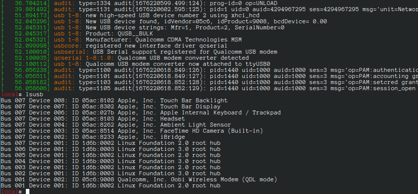

itchy355 24 Posted February 12, 2023 Author Share Posted February 12, 2023 (edited) Trying, but not much luck. Apparently my phone can be powered up in EDL mode, as I hope this is what it's supposed to look like ..but on Windows, with Qualcomm USB Driver v 1 installed as administrator, I see nothing in device manager and I see nothing in QPST .. I'll probably try VirtualBox windows or something. My physical windows computer is rather an old one with win 8.1.. EDIT: scratch that. Apparenly my A-C cable (used to connect to the old machine) was destroyed.. now it shown up, working further.. Edited February 12, 2023 by itchy355 Quote Link to post Share on other sites
itchy355 24 Posted February 12, 2023 Author Share Posted February 12, 2023 Alright, got somewhere but not exactly anywhere. QFIL finally sees my port, great. But I'm missing the prog_firehose_ddr.elf file in my stock ROM. I got the ROM from here but apparently it's a build for fastboot, I guess. All my googling attempts fail, again :) Â Quote Link to post Share on other sites
