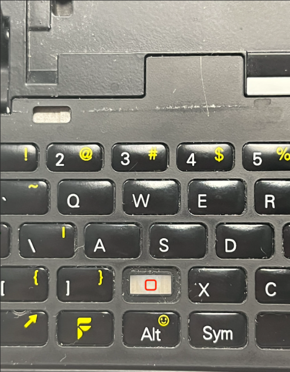

Casey 321 Posted September 20, 2022 Share Posted September 20, 2022 On 9/16/2022 at 5:55 PM, JECE said: Can I just super glue the key back on or is that approach unadvisable for some reason? Yes, you can superglue the "Z" key back on the keyboard. But please be careful when you do so, you must not glue the sides of the key as you won't be able to press it... Please check the image I've attached, drip a small drop of superglue on the tiny circle on the keyboard (marked red), and place the key back on. Good luck 😄 1 5 Quote Link to post Share on other sites
JECE 24 Posted September 20, 2022 Author Share Posted September 20, 2022 (edited) 1 hour ago, Casey said: Yes, you can superglue the "Z" key back on the keyboard. But please be careful when you do so, you must not glue the sides of the key as you won't be able to press it... Please check the image I've attached, drip a small drop of superglue on the tiny circle on the keyboard (marked red), and place the key back on. Good luck 😄 Did that already over the weekend and it worked (not with super glue, but another strong glue)! So far no problems! The tiny glue stain that I previously noticed was slightly to the upper-right from the tiny circle, which may explain why the key fell off in the first place. Thanks for confirming that I did the right thing, @Casey. By the way, do you happen to have answers to any of my questions about the keyboard software that I asked at the top of this thread? Or feedback on the speaker issues that I raised in the same post? Edited September 20, 2022 by JECE substituted "thread" for "post" 2 1 Quote Link to post Share on other sites
